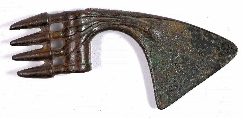

found a luristan bronze axe head of the type i've been looking for yesterday at auction. sadly, it went for about six times my max bid. it's the simpler one below.

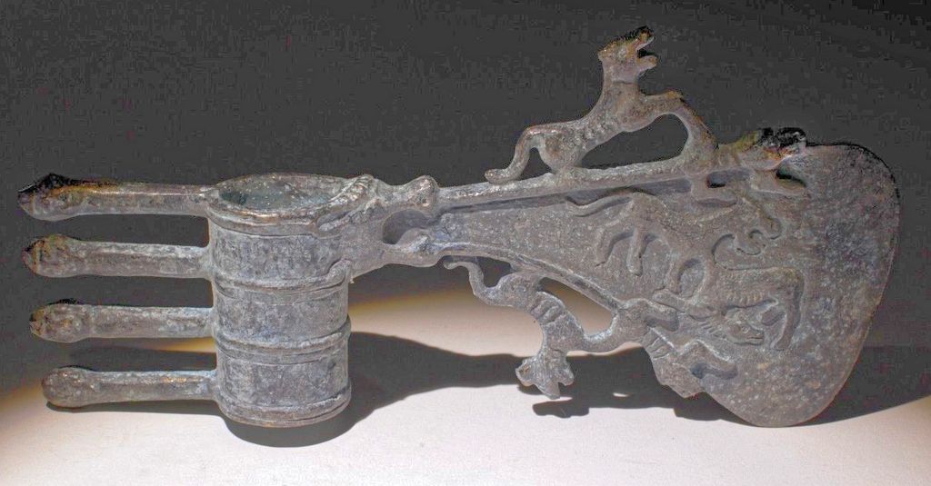

today, i stumbled on one again, a more elaborate version, with a low minimum bid same as yesterdays, i bid a tenner over the minimum online and won it for £4 over, the only other bidder only bid £2 over the minimum.
anyhow, i'm guessing these are likely to be fairly recent copies, tho the decorative lines on the one i won are quite crisp rather than blurred as they'd be if cast from a mould of a real one instead of the original moulds.
it was listed as 18.5 X 9 CM. i'll add some more dimensions/ weight and maybe some better pics when it arrives.
anyhow, i respect your opinions. what do you think? real/copy? clues as to your conclusions? all appreciated. thanks in advance for any comments.

In recent years the market has been literally flooded by Luristan and Warring States bronze artifacts, with the vast majority being fakes. Some of the fakes can be spotted easily, while others can fool even the most experienced experts and require specialized laboratory testing. That's why I am highly suspicious when I see any of these artifacts.
And the fact you didn't receive any replies so far seems to suggest there might be others who share my suspicions.
But I am sure you already know all this.
PS: Other than that, the axe looks really cool.

I'm afraid I'm with Mariusgmioc on this. I have seen too many fakes on the web and in person. i just walk away from them when I see them. The patina can easily be faked.
My ignorance always stops me from purchasing somethings. If I now little about an object, I then pass on it. Sorry I couldn't be of more help.

i bought this on the assumption it was not antique, let alone 3000 yrs. old, probably not even 'vintage'. i bought is cheap, instead of the hundreds of uk pounds i've seen them go for, which i will not pay, i can't afford them, so it can be a nice wallhanger when i get a haft worked up for it. i may even polish it a bit . i'll think of it as a placeholder in my axe display area. thought i'd check y'all here before i fart around with a real one & screw it up.
thought it was kinda cool with the extra added animals, which is i have read rare but not unheard of.

I have seen museum examples more in line with the first one.

I agree with you. Most chances that both are copies, but the first one is a much better copy. Could also be real, who knows?
Copper and broze casting is relatively easy technique that can be performed in basic workshop conditions - I have seen artisans from Mali doing it.
It is also easy to make these artifacts look old, so forgeries of Luristan bronze are quite easy to make.
Luristan bornze is intriguing because their cultural background is unclear. As weapons, it is logical to assume they were more ritual than functional, as iron working was already established in the region at the time of their making. It is true that relatively great numbers of artifacts were found in Luristan, but the sheer number of artifacts on the market makes it very improbable that they are all real. Because of this and the fact that only a very professional analysis can tell a real from fake suggests that it is better to stay away from Luristam bronze

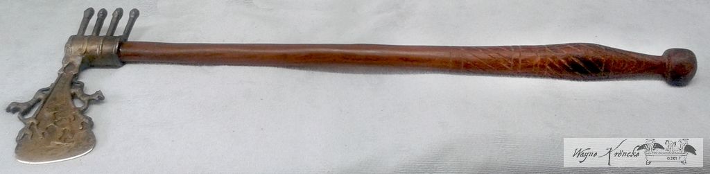

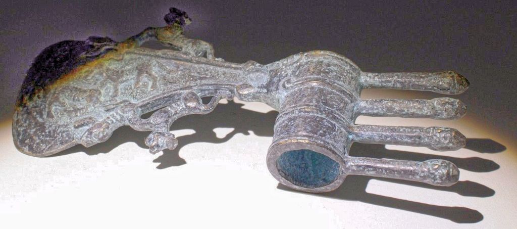

anyhow, i've cleaned it up a bit with an old toothbrush to get rid of the powdery light green verdigris surface stuff, added a suitable hardwood haft & have a nice wall hanger. it came with a nice sharp edge too.
