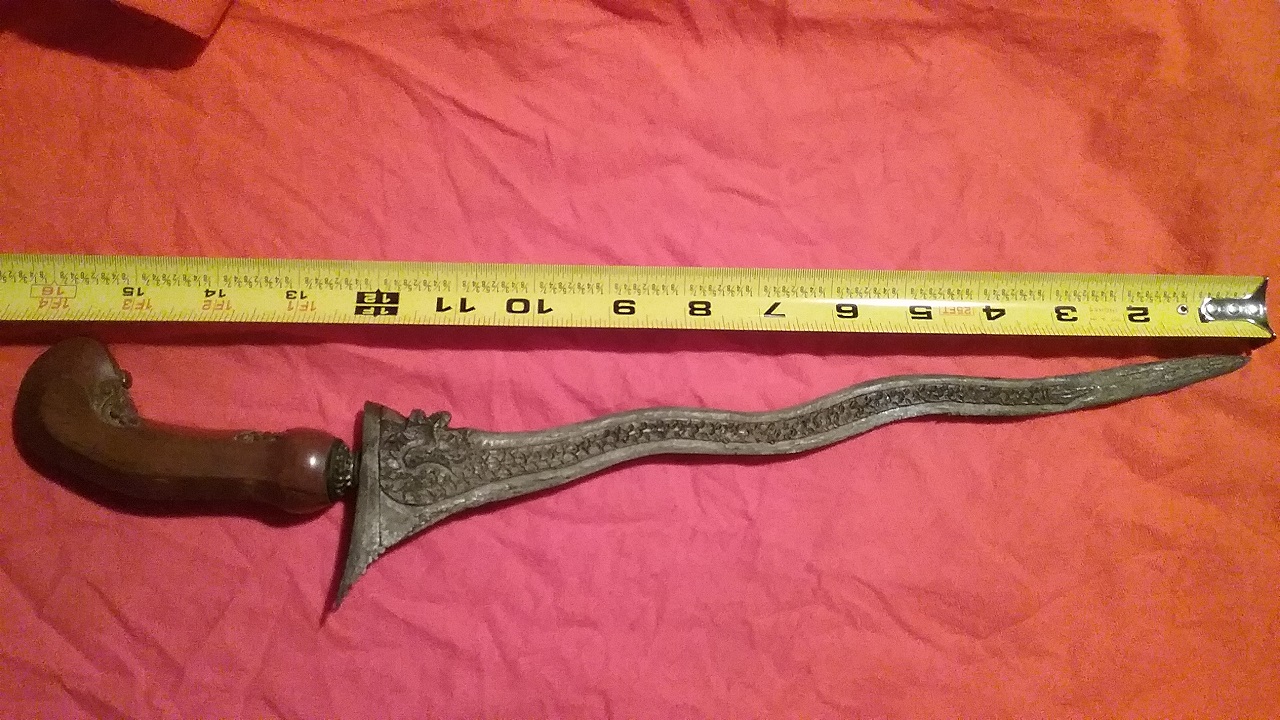

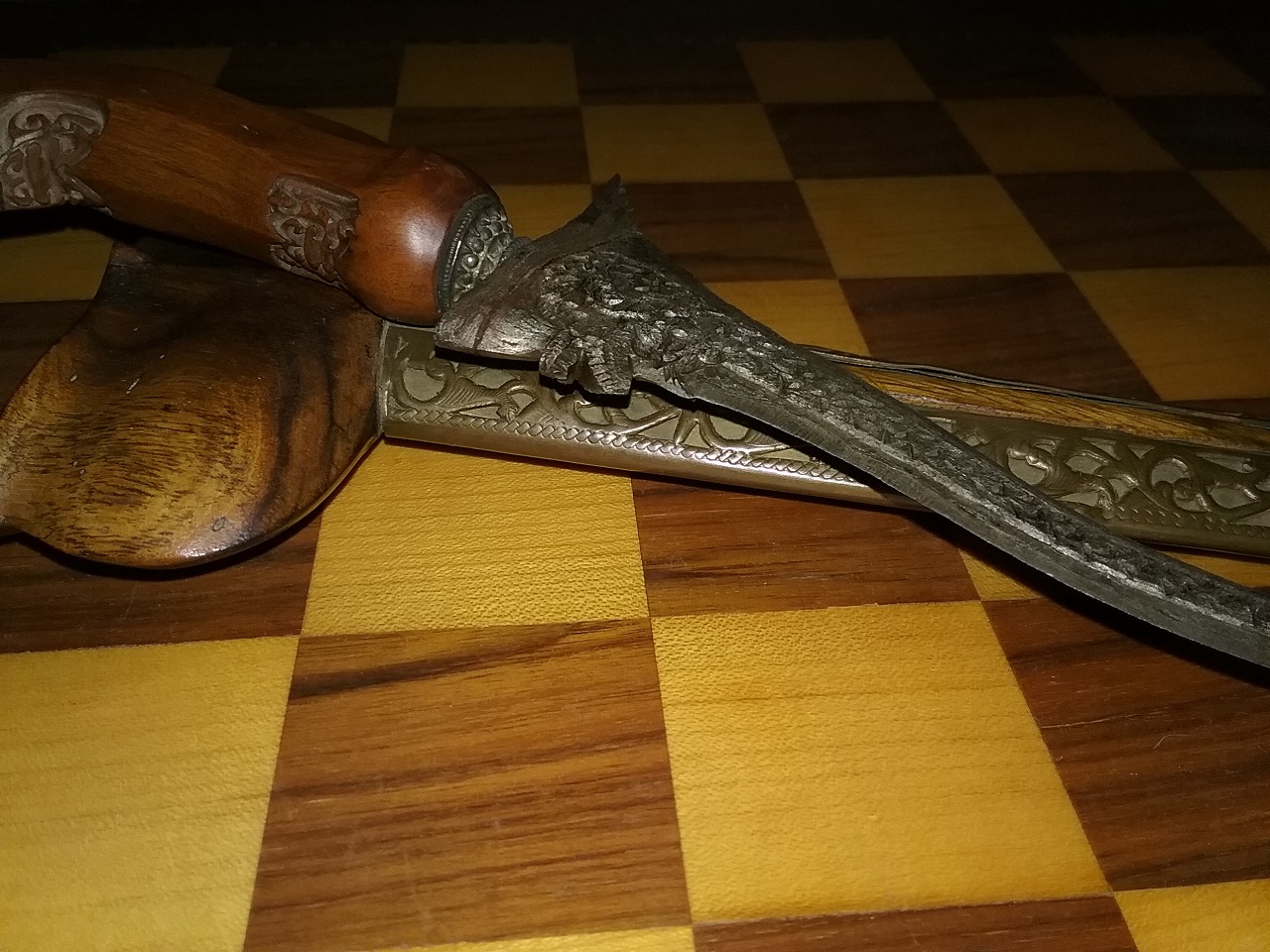

Hi all!
I'm new to learning about keris, although the form has intrigued me since I was a child. I only have one such piece in my 'collection' (if so few items can be called a collection). I am hoping some of the expertise of this forum can help me gain a more informed appreciation. I have attached pictures below. I have seen examples of very poorly executed naga that seem very superficially etched on the blade. For this piece, it seems the serpent was chiseled into the metal in a much more substantial way. Also, the edge is very thin, worn, and nicked. I'm wondering if this suggests age as I believe the acid etching done regularly can wear away the thinner parts of the metal. The hilt (forgive my use of generic terms) doesn't seem to have much age to it. The scabbard appears to be of a single piece of wood (rather than the collar being separate from the main shaft. Is this something more modern tools allow for, or does this suggest an older item.
Again, I know there are very specific words applied to each of these features, but at the risk of misusing them, and causing more confusion, I am relying on the more general terms. No disrespect intended.
Thank you to anyone who is able to provide information as to the form/style, country of origin, approximate date, etc. I am thrilled to have finally 'married' one, and will be equally happy if this was manufactured last week, or last century. I would just like to learn more.
Thanks!

Hi Shayde, welcome to the forum.
Though your photos are not extremely clear it seems to me that there may indeed be some age on your blade, however i suspect the the somewhat crudely carved naga was done at a much later contemporary date, possibly to give what is a fairly standard, lower end blade more appeal in the marketplace. Of course there could be other reasons for the addition, but i can't think of any way to confirm why it was added. But i seriously doubt it was born with this naga.
Your sheath, as you have noted, seems to be made in one piece. We refer to that as wrongko iras, "iras" meaning one piece. That does not necessarily imply modern tools and i would say there is some age on this sheath. Wrongko iras are generally prized as they are rarer and more difficult to carve. I also like the brass (?) open-cut pendok though it seems to be a bit ill-fitted and may not be original to the sheath. The blade, OTOH, appears to fit the sheath fairly well so it was either made specifically for this blade or adapted to it. The dress is what is know as Surakarta gayaman (everyday) form.
Old 30th June 2017, 12:07 AM   #3
Posts: 7,255
David, my immediate impression was that I was looking at an old blade that had been carved with the naga the day before yesterday, but as I studied it further I formed a different opinion, or rather, two opinions.
To begin, I'd place the dress as pre-WWII, the blade fits nicely so the blade was very probably as we see it, pre-WWII.
Something that used to be done a long time ago was to take very large Tuban blades and use them to produce more attractive keris. This happened in the late 19th century, through to WWII, and a few were even done in the 1950's. I'm pretty sure this died out by the 1960's, I'd guess because the great big Tuban blades that were used as the raw material had become scarce and expensive --- these days those original giant size Tuban blades are very rare, very highly desirable and very expensive.
So this keris could easily be one of the alterations based on a big Tuban blade, but from a long time in the past.
The other alternative is low quality work, probably from a village smith, but again, pre-WWII.
Either way, I'd consider this keris a pretty good start to a collection, but I would be inclined to give the dress a bit of a facelift.

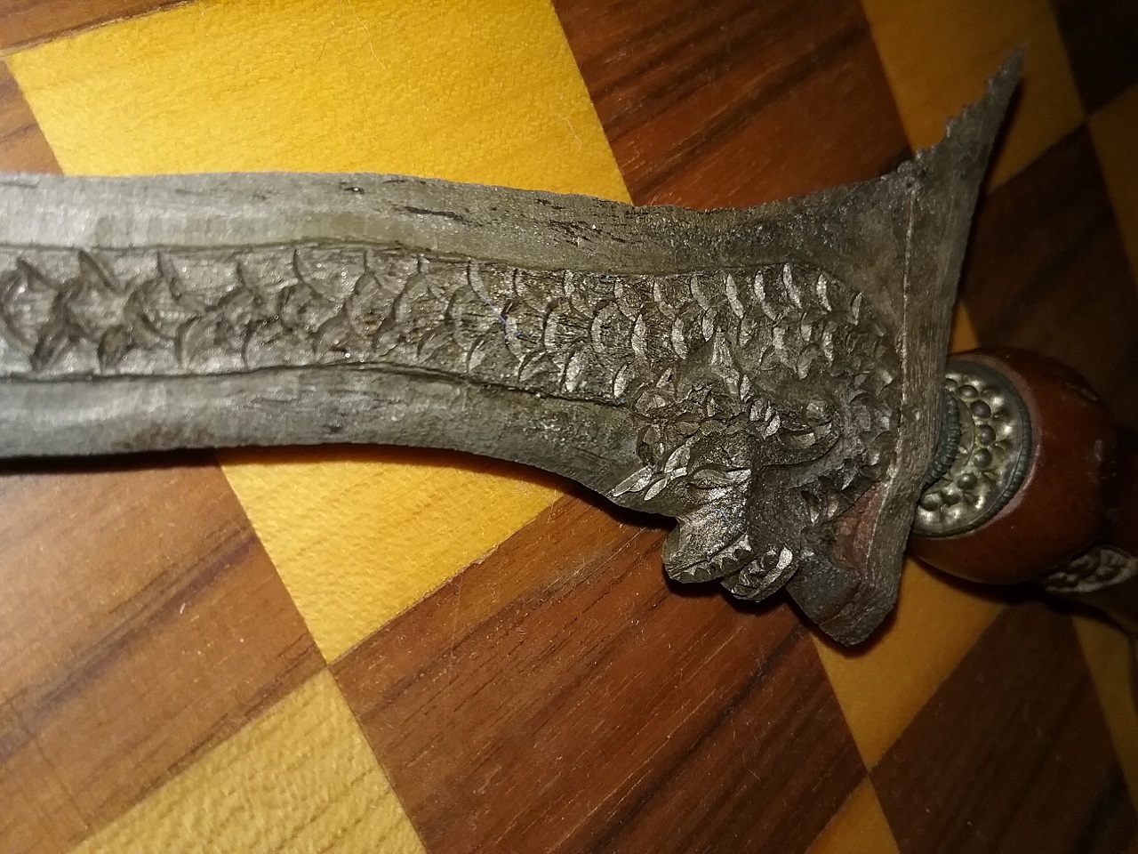

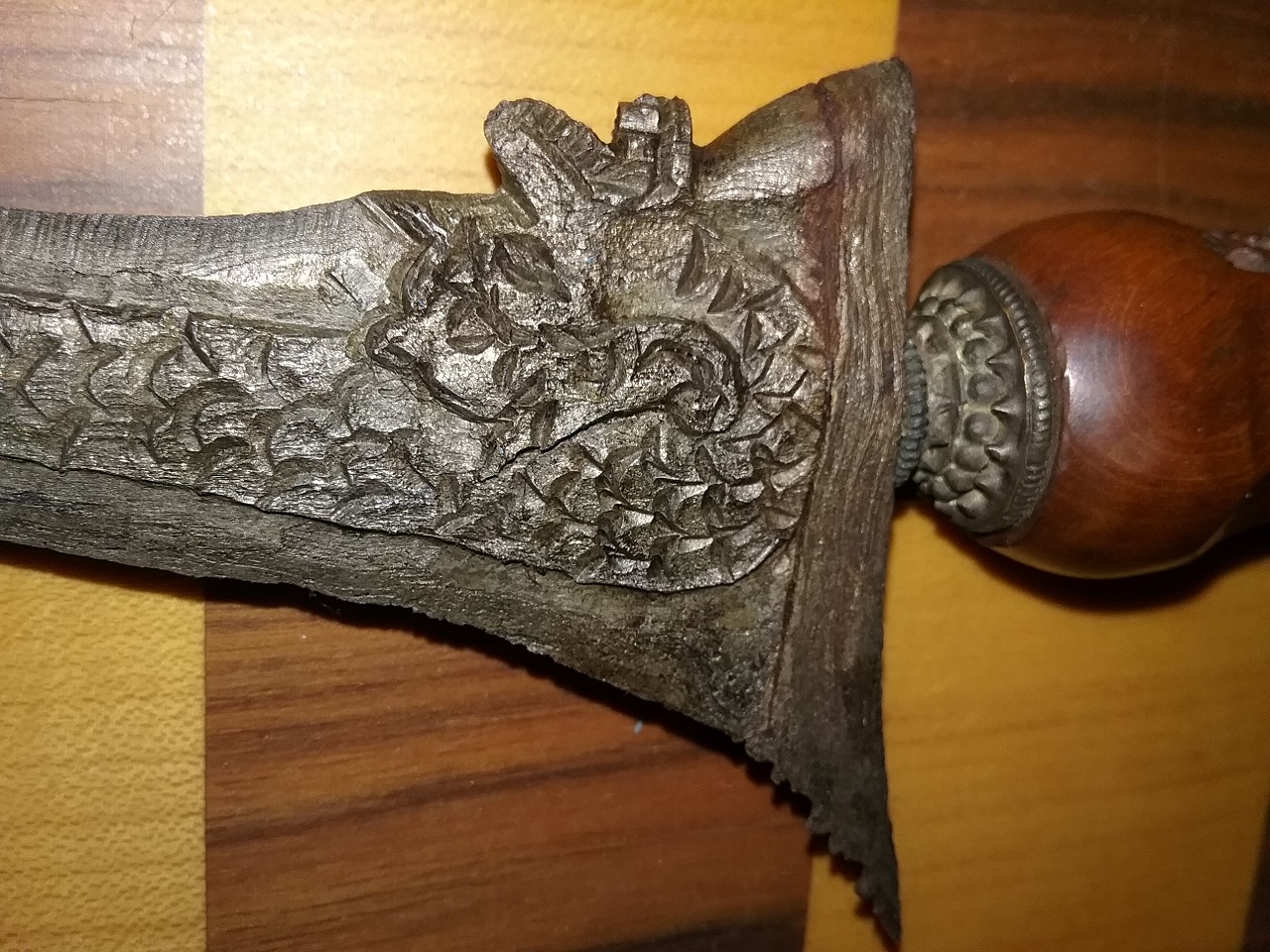

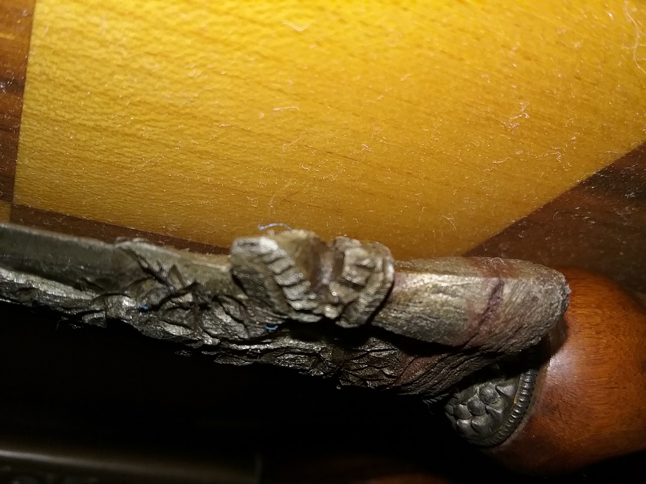

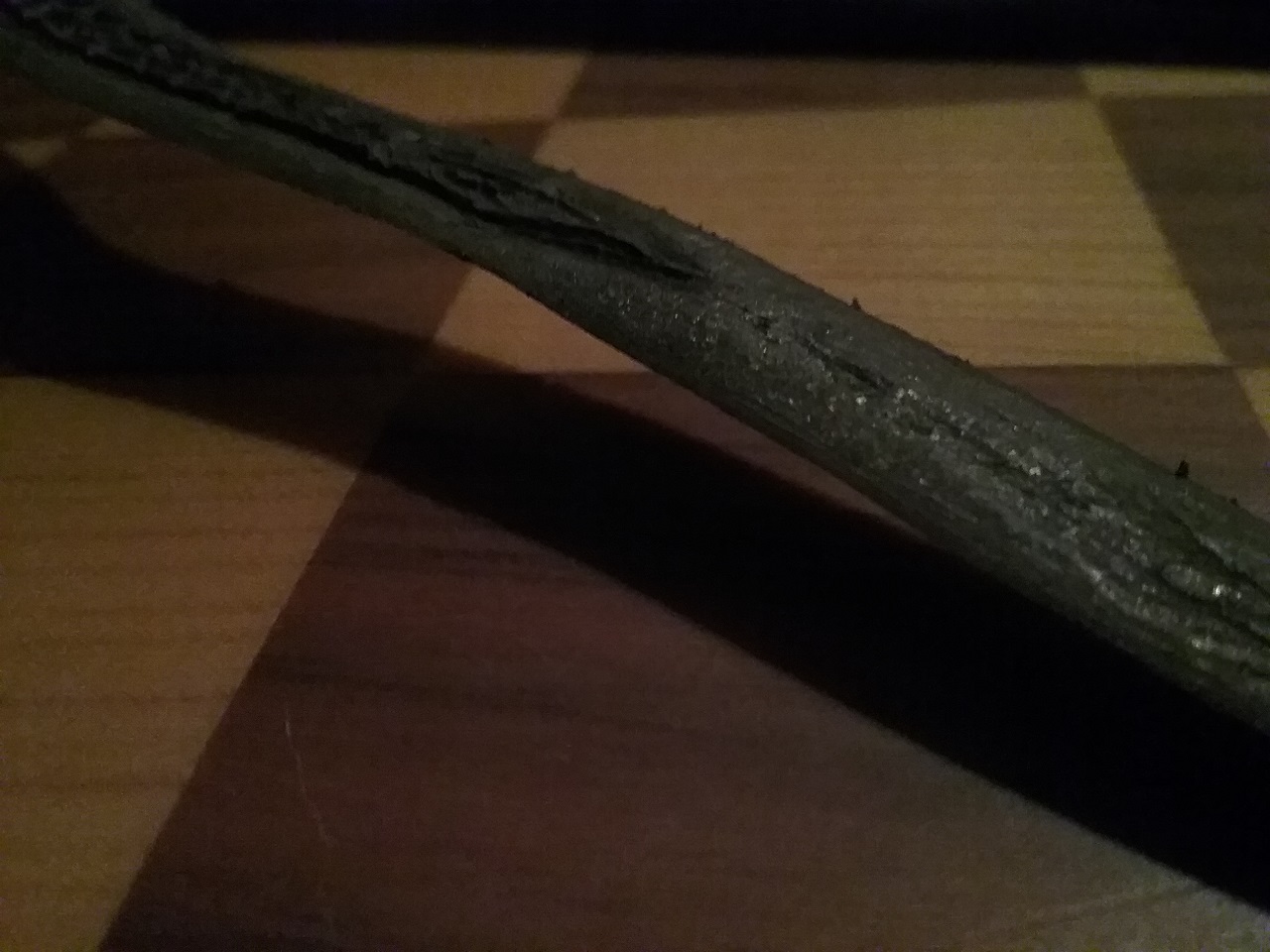

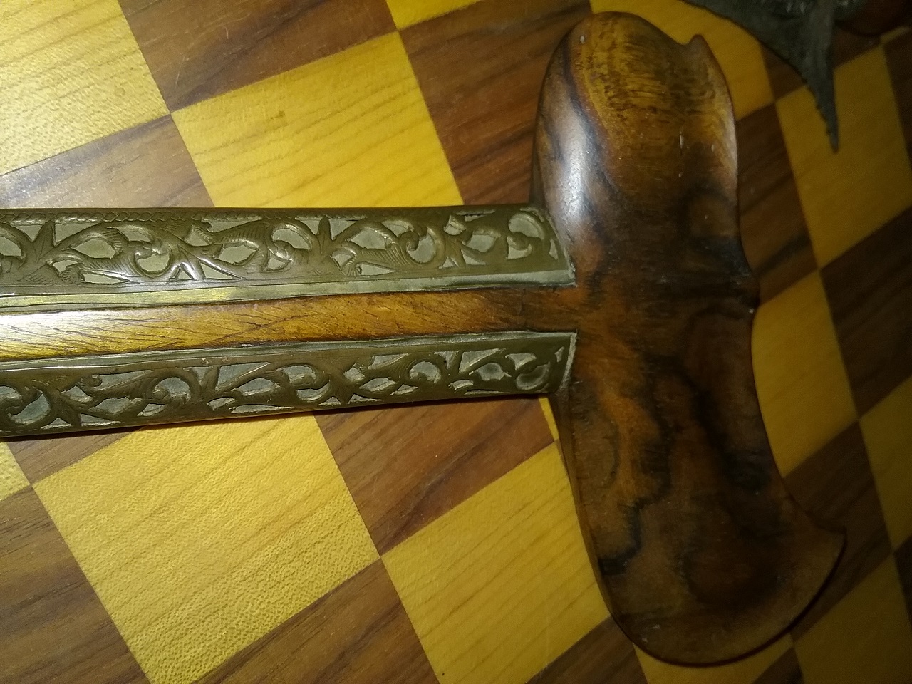

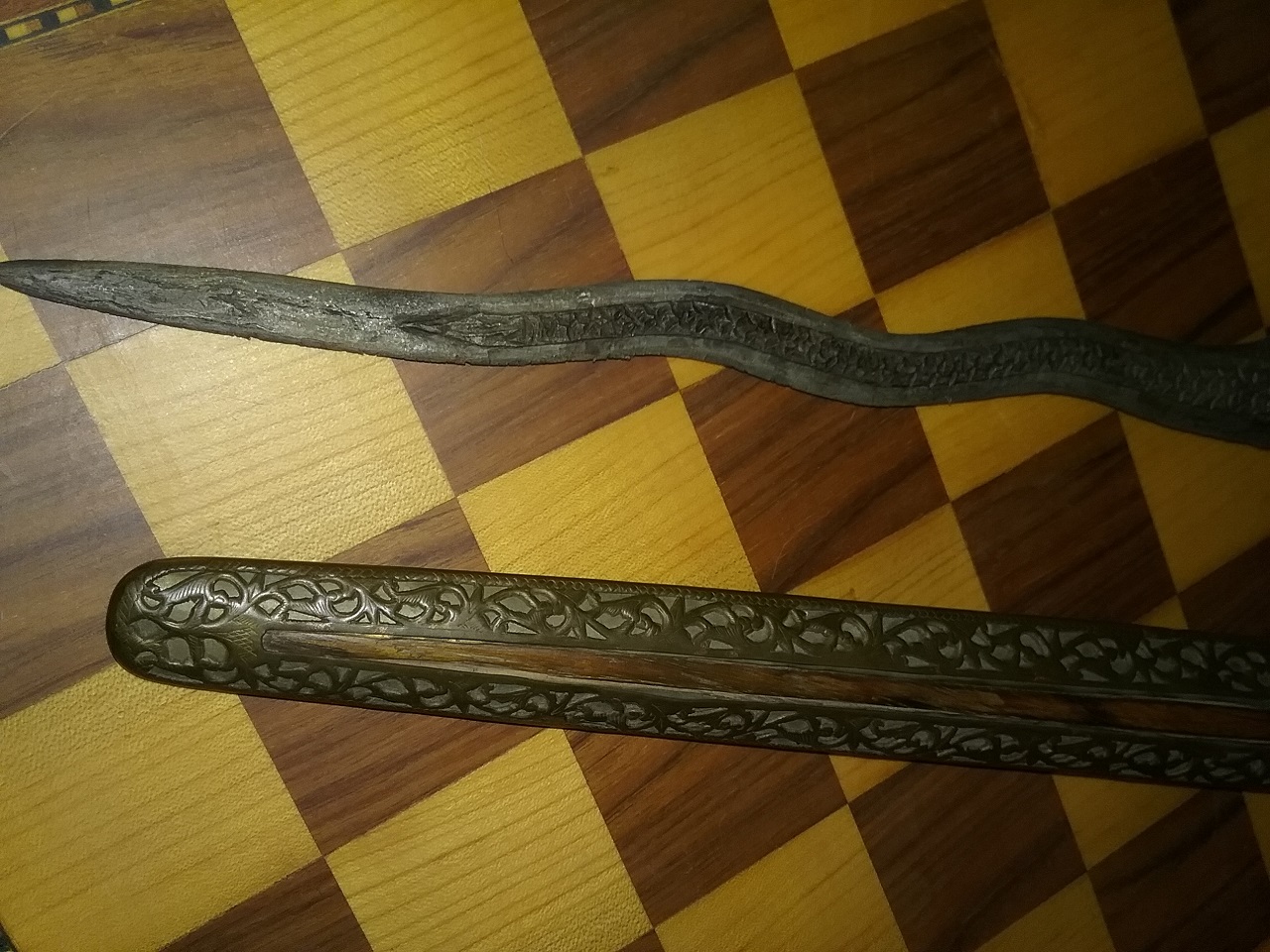

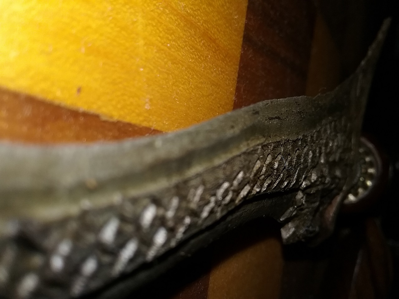

Thanks again. Out of curiosity, what would giving the scabbard a 'bit of a facelift' entail? Do you mean the metal components being replaced, or the wood itself? I ask because the wood is actually in beautiful condition, although that doesn't come across so well in the pics.

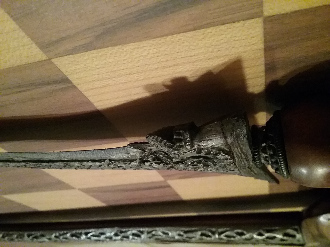

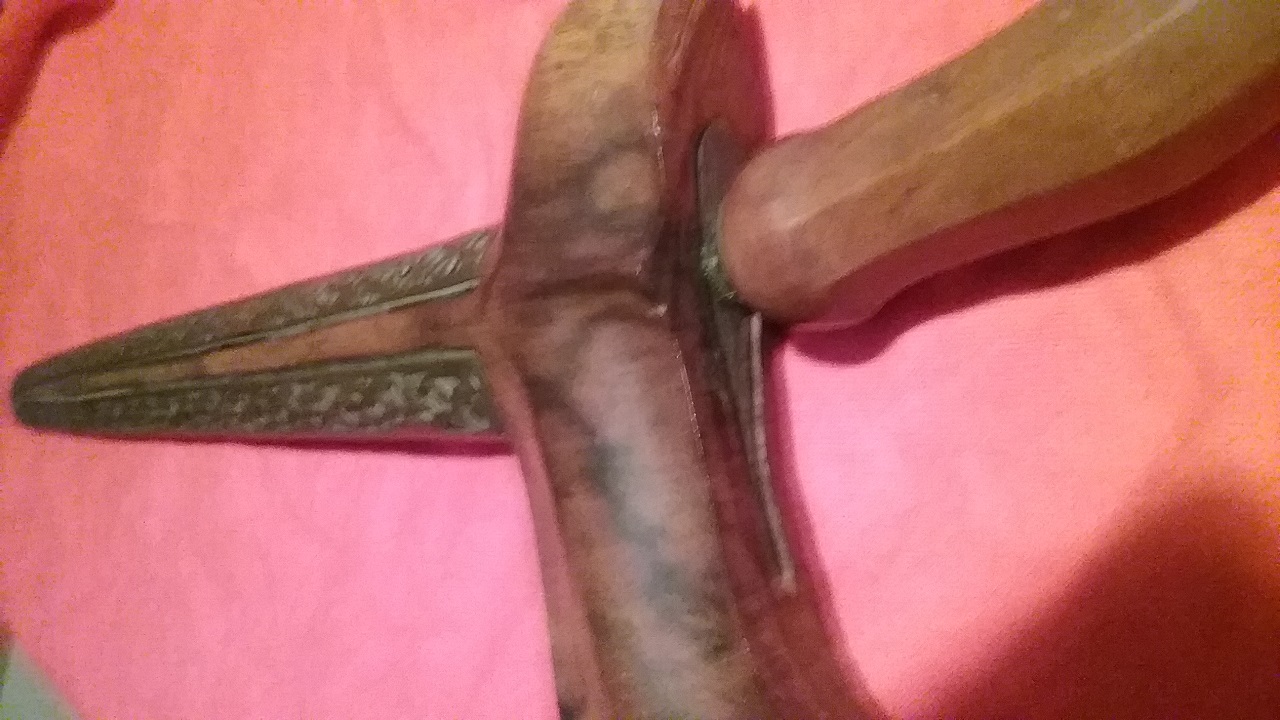

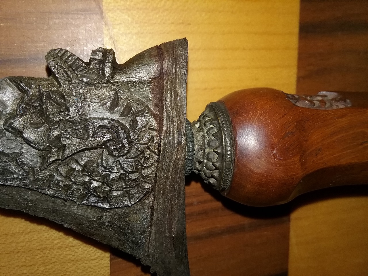

Here are additional images that I hope are more clear. Regarding the carving of the naga, it does appear to be integral to the blade itself (i.e. it seems as though the blade was forged with the idea of carving this figure). I am not at all familiar with the Tuban blades, and if they would afford enough 'meat' with which to work. I tried to include pictures that show the naga's head as being carved 'in the round' and being properly three-dimensional. Still, I'm eager to hear any additional impressions.

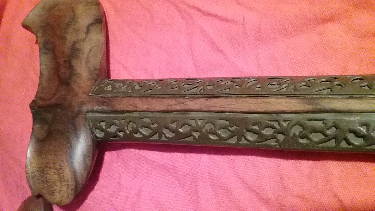

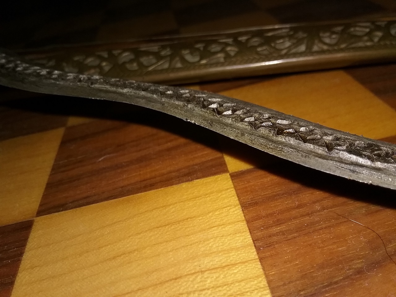

Posts: 447

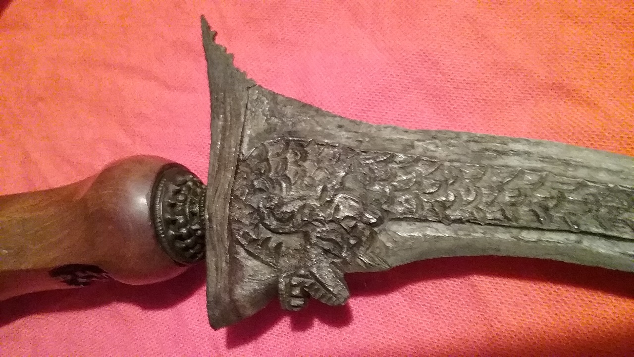

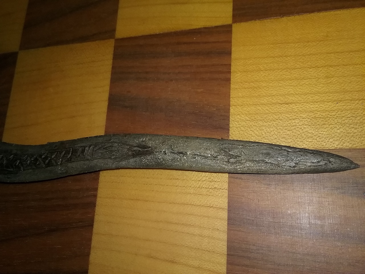

And just some additional views [for scale, squares on the board used for background are 2"x2"]

Posts: 7,302
Thanks for the better photos Shayde.
The pendok (metal part of the sheath) is even nicer than first appeared with these detail shots.
I remain pretty well convinced that your naga was carved well after this keris was forged. Whether that was still some time ago (pre-WWII) or later could probably still be a matter of debate, but i'm pretty sure this blade was not born to be a naga keris.
I will leave most questions of "facelifts" to others like Alan who have perhaps handled more renovation work than i have, however, if this were mine i would slide the pendok off and carefully clean and oil the wood. I might try to see if it is possible to carefully bend that pendok together a bit more at the top so that it fits more tightly to the wooded ridge on the sheath stem's center, though it may never fit quite right. I would certainly take a polishing cloth to the metal to brighten it up and maybe attempt to clean up the mendak (hilt ring) a bit. Keep in mind that keris dress is meant as an outward display during public wearing. Leaving tarnished metal parts would not be the way this keris would be maintained within the society.

If I wanted to lift the appearance of this wrongko I would do this:-
1) Remove the pendok. If it does not slide off easily, gently heat the back of it, for this heating I use a gas torch turned right down low, because I can precisely direct the heat, but any source of heat will do, just be careful not to get heat directly on the exposed wood.
2) The problem with the pendok appears to be that a slorok --- the contrasting under layer that can be seen through the pendok open-work --- has been fitted, but fitted very untidily and without making room for it by scraping down the back of the gandar (the long section enclosed by the pendok). Fit the slorok so that its edges do not protrude beyond the edges of the pendok, and remove sufficient wood from the back of the gandar to permit a tidy fit. Easiest way to remove wood from the back of the gandar is by scraping with a small blade.
3) Polish the pendok with a Scotchbrite pad, and finish polish with 0000 steel wool and then an impregnated polishing cloth. It is very difficult now to get polishing cloths specifically for brass and bronze, but a silver polishing cloth will work OK. You can use various grades of steel wool instead of a Scotchbrite pad, but if you use steel wool be very, very certain to get rid of any residue. Don't forget to polish the slorok.
4) Clean the wooden scabbard with a good quality furniture oil, not a wood finishing oil, but the sort of furniture oil that is used on fine furniture, allow to stabilise well after polishing, then use a good quality furniture wax and polish.
5) It might be a good idea to clean out the inside of the scabbard while you're at it, a rifle cleaning rod with .22 bristle brush is good for this, followed by blowing out with compressed air.
6) Put the scabbard back together making sure that it all fits together neatly.

Probably just a spray with WD40 followed up by application of a light machine oil. Allow to drain off before replacing in scabbard. Actually there are much better ways to long term store a keris than this, but if you wish, that can be addressed later, or you can just trawl back through the old Forum posts, I think this blade storage thing has been gone over a number of times.

How do you reckon this blade might have looked before it was carved with a naga, Shayde?
Whether it was carved from an old Tuban, or some other old, beefy blade, or whether it was forged with the intent of carving it with a naga, it is absolutely certain that the cross section was way different to what you can see now.
