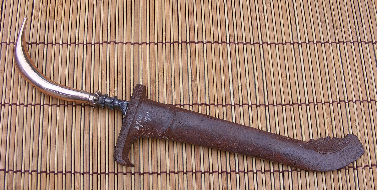

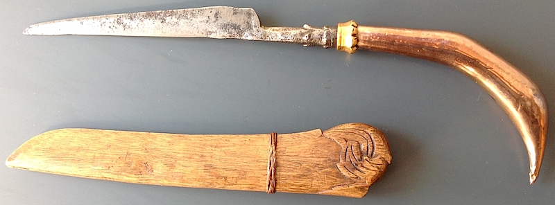

I recently won this small Sumatran knife on eBay. At first I thought it may have been a Lopah Petawaran but it lacks the parallel back and edge which seem typical of these.

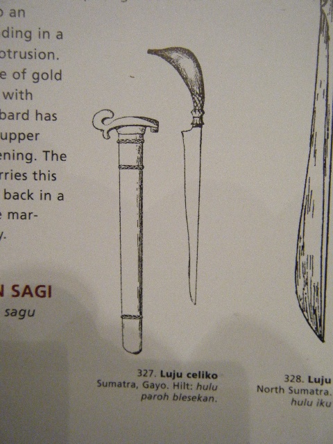

The blade form seems very similar to the Lulu Celiko in Van Zonneveld (p. 84), although the handle curves in the opposite direction to the one illustrated. I have not been able to find any other images of this type of knife, which Van Zonneveld suggests were part of wedding ceremonies.
The scabbard seems VERY similar to that of a Rencong (perhaps it is not original to the knife).
The seller suggests that the handle is copper. I do not have the knife in hand so I am uncertain. If I am VERY lucky it may be Suassa.
There is a faint inscription on the scabbard (ZY50 1911) which may be a museum number and collection date.
I would greatly appreciate any thoughts on the identification of this knife, it would also be great to see other examples.
Russel

Hello Russel,
would agree, it seems to be a luju celiko. Why the handle curves to the wrong side I don't know, it's the normal curve a lopah petawaran show and it seems that this both types of knife are related. Wish you good luck that the handle is from suassa. Great and nice catch!

I thought it was a Rencong, because of the direction and 90 degree curve of the handle. But I could find no pictures of Rencong with that type of handle. Looking forward to finding out more. I put in a very small bid, as I wasn't sure what it was. Glad another forum member won it!

Here the picture shown in in Van Zonneveld (p. 84), it's an old drawing, maybe the artist has done a mistake by the direction the handle show!? I assume Albert has taken this picture from a second source. Would be more as interesting to see other examples.

Congrats, Russel, nice scoop!
IMHO, it is a luju celiko, indeed. I have one with a hilt in the same direction (pic to follow); AFAIK, Albert's account is based on a single source (Kreemer).
I'm ready to bet your's also suassa...

I took a look at the pictures off eBay and, though hard to tell from the bad pictures, it does look like suassa to me. However, it would be best to get it tested by a jeweler to make sure.

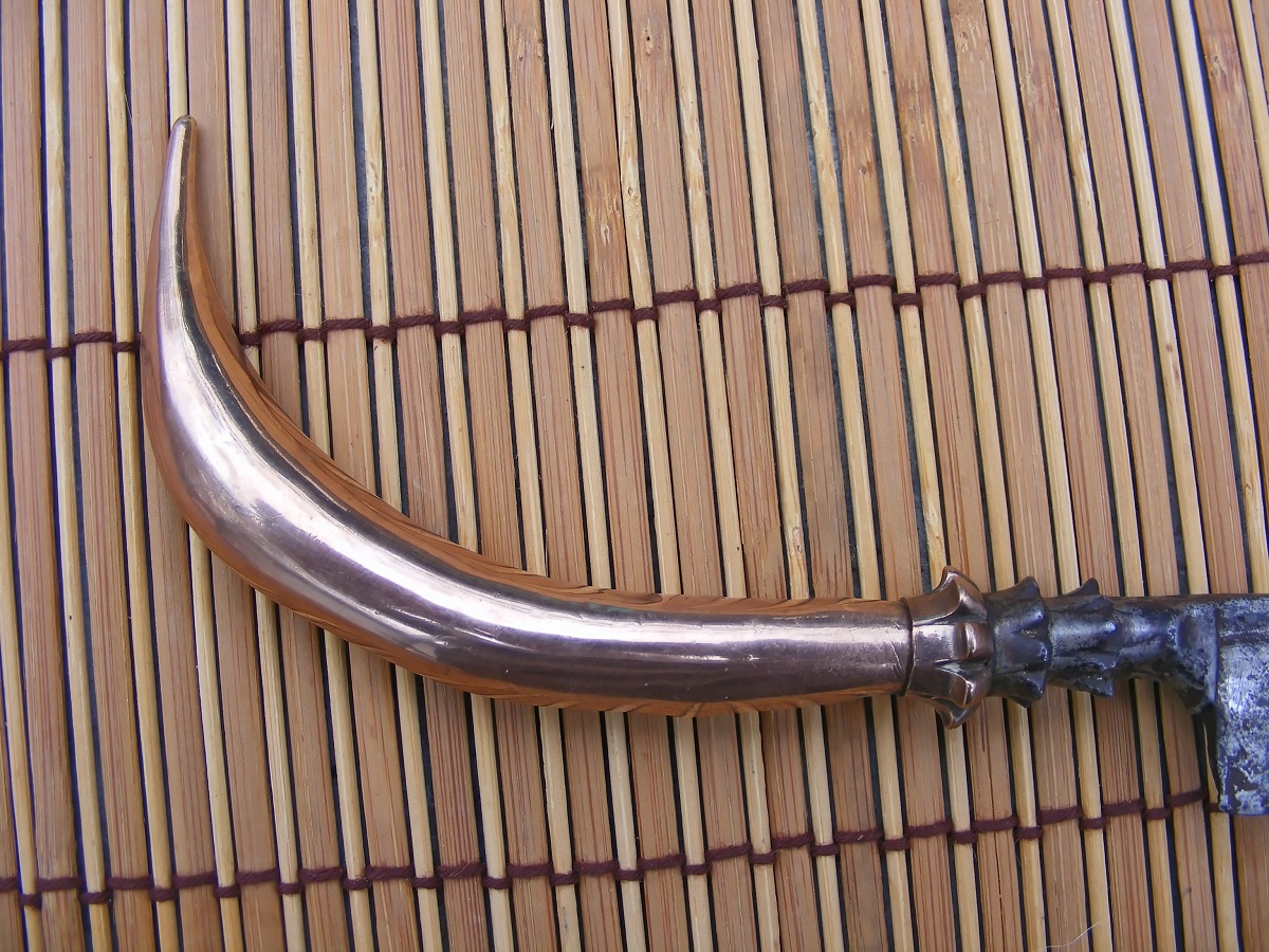

Here is my example; the scabbard is probably a later replacement. I haven't seen any rencong-style scabbard before - your's looks quite convincing though.
As with Lopah Petawaran, these seem to be ceremonial blades only. Both types are probably based in (Karo?) Batak and possibly old Gayo cultures; probably the concept dispersed northwards upon increased contacts between Gayo and Alas with Aceh: the rencong is related, of course.
BTW, the drawing is from Volz (usually reliable despite the sketches being a bit coarse): this example has 2 "crowns" (probably an integral bolster and another similar ring) at the base of the hilt as also found on some Lopah Petawaran and clearly a saruek ulat as found on some Gayo and a few Aceh status pieces; the scabbard might be Karo.

neat! Seems to be a fairly old example with a much younger scabbard. Haven't seen Russel's example by ebay but some other members, maybe good like this because a lulu celiko is on my wish list.
When I look again to the shown picture I am as well nearly sure that Russel will find that the handle is from suassa.

Thanks everyone for the comments, I am very happy that my identification is confirmed.
After searching the forum, and Google, I have found no other examples than the two posted here. Can I conclude from this that these are rather scarce?

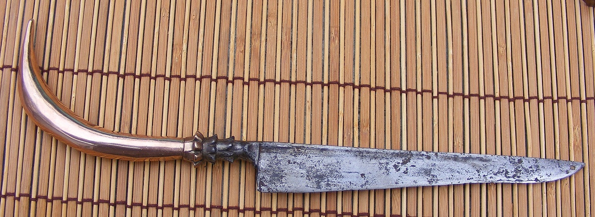

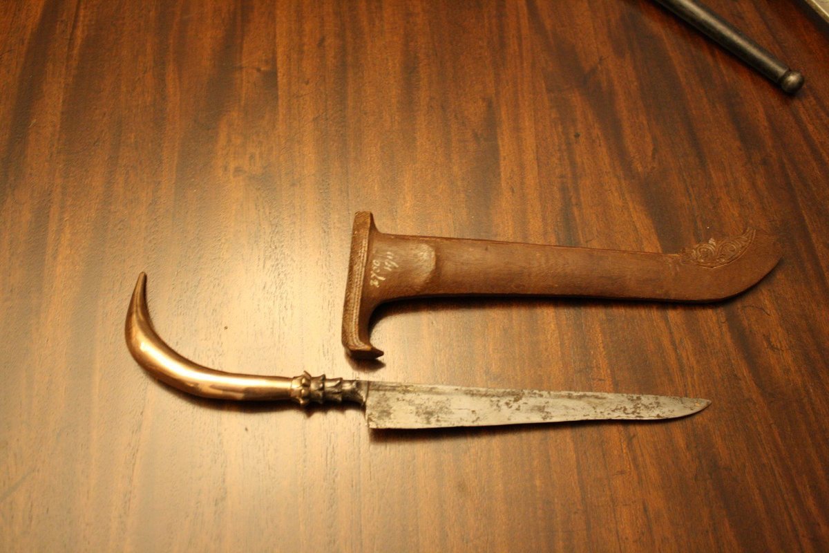

Hello all,
Robert has kindly provided some clearer images, and has also confirmed that the handle material is indeed Suassa (14k).
I am still trying to learn more about these knives, and would greatly appreciate any information forum members may have.

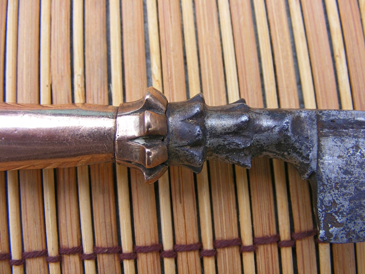

Do you have a picture of the fitting of the blade in the scabbard ?
Indeed unusueal to see this blade type with a rencong scabbard.
But the combi looks quite genuine.
14 Kt gold suassa ? did you have this tested ?

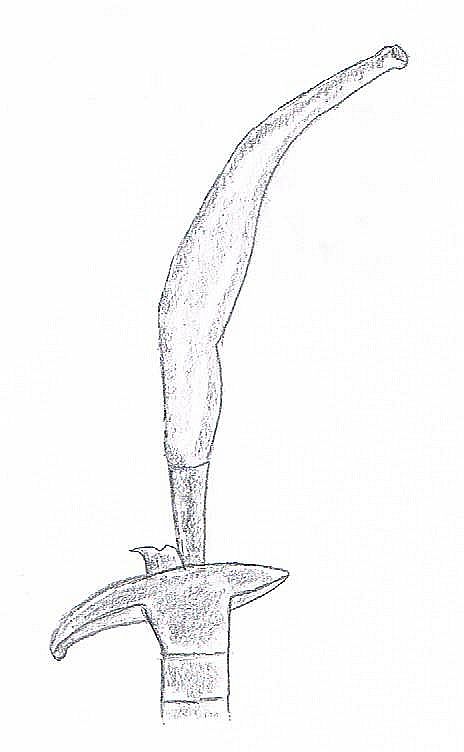

Here is a sketch of a Hulu Dandan style hilt found on rencong in Sumatra. It is fairly rare. I think it may be a good match for your item. The Hulu Dandan was a high prestige hilt and this corresponds well with the triple crowns on your example.
This sketch is one I found on an Indonesian website years ago. That link no longer seems to be working.

Hello Dave,
Hulu dandan tend to be on the big side of things (considering rencong hilts)!
The typical hilt for a luju celiko is the hulu paroh blesekan and these are considerably smaller (as are the ceremonial blades). There is not much published evidence and I'd really like to see more examples - hopefully the forumites can contribute a few more!
Russel's example has a somewhat smoother flow of lines while mine shows more clearly different parts of the hilt which seems to relate to the hulu dandan configuration. One could argue that hulu dandan, hulu paroh blesekan, and hulu jongo form a kind of continuum but I believe we should stick to the traditional definitions unless we have really good evidence to the contrary...
