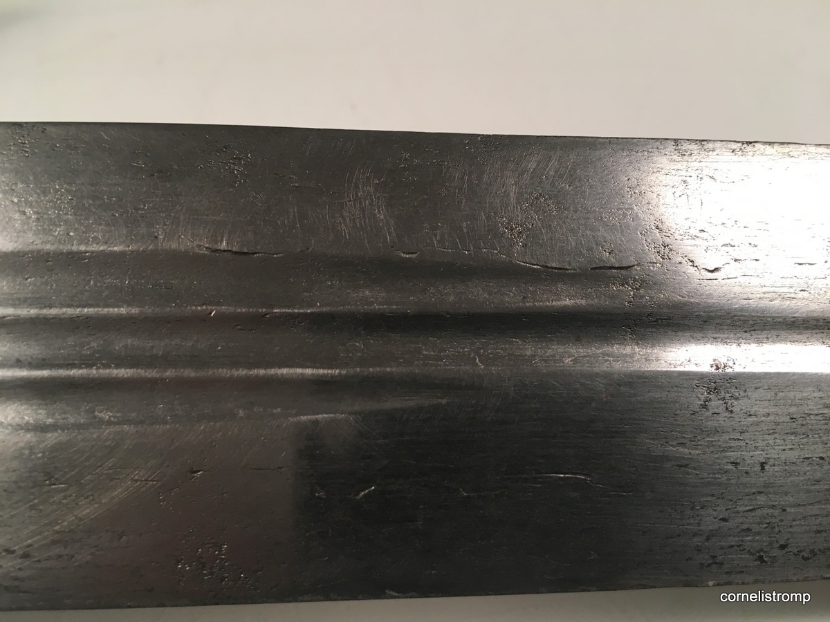

some additional pics.

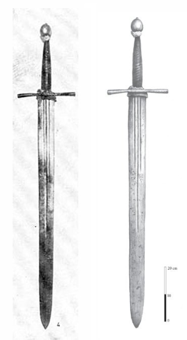

I am likely guilty of sharing Marius' paranoia as well.... no need to repeat the misgivings.
I can offer one physical example that can support the possible dating - it shares some similar features vis-a-vis the form of the pommel and blade. I agree with Jean-Luc that comparisons should be sought among type XX swords.
Mark

No problem, my first reaction to photos of this sword was skeptical but differs from my opinion now.
thanks for the good example of a similar type Oakeshott XX , I know the sword, it is at the moment in the Spiš Museum in Slovakia.
I know a few more examples of similar blades on 16th century swords.

actually it is not as pristine as you would expect, the surface of the blade is shiny but it has the structure and pitting that you would expect in a well-kept old blade with some nicks on the cutting edge at the blade node/approx.3/4 length.
the sandwich wooden grip is dark and old, the binding is probably redone in the 17thC.
