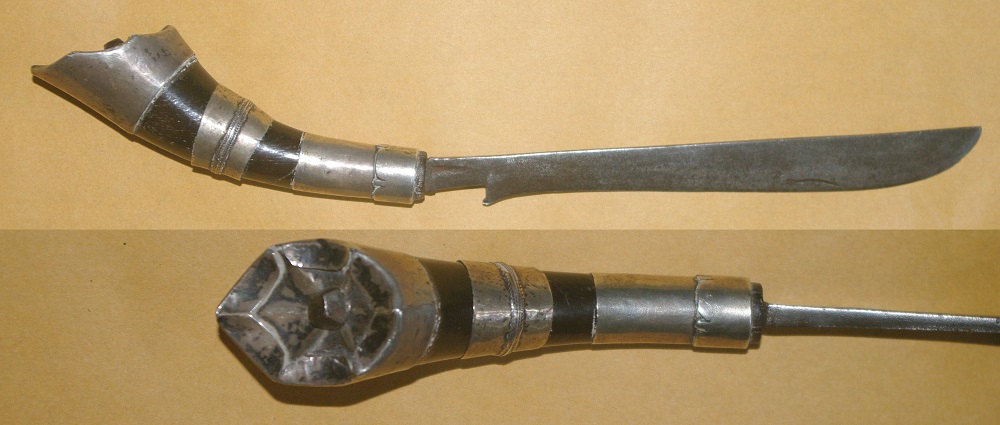

I recently acquired these two Batak knives which I don't know either the name or the function.
The first has a handle similar to some Lopah Petawaran seen on the internet but the blade is much simpler.
Blade length : 16cm
Handle in Saro (Capricornis sumatraensis) horn with silver
No scabbard.
This one (with the silver bands at the hilt) indeed resembles typical LPs: It is a known type that usually comes with a simple blade (without an integral bolster) and a only slightly curved hilt that usually shows an exposed tang. On average these seem to be a kind of poor cousin of the typical LP; however, there are a few examples with fittings that suggest higher status wear (as well as pretty basic typical LP). Whether this is a LP variant or a related but distinct type is probably a moot point - I don't know of any primary sources which discuss these blades. Thus, no info on historic names, too.
OTOH, it seems very likely that these had the same ceremonial use as the typical lopah petawaran.

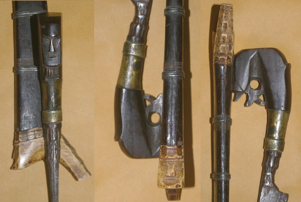

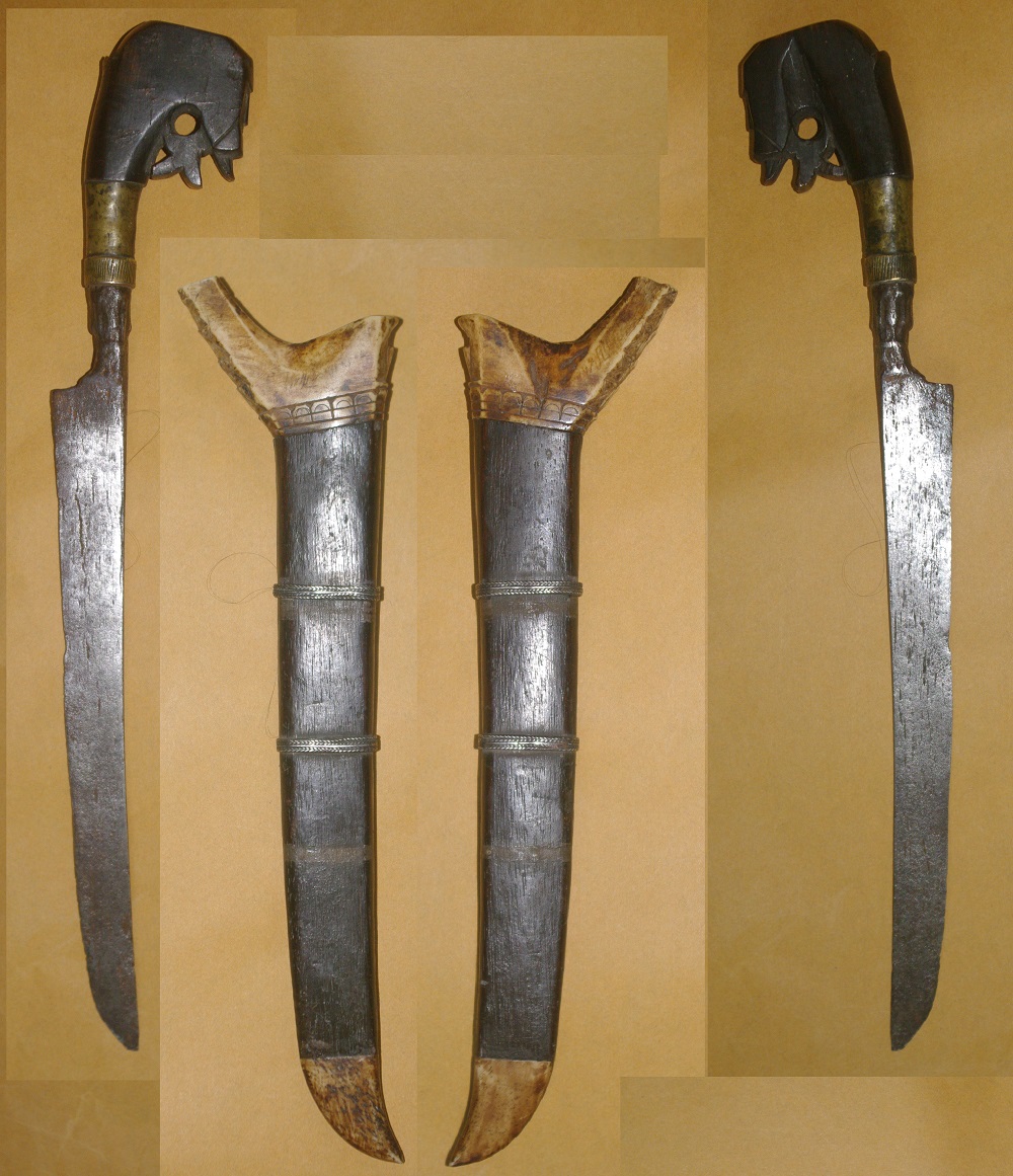

The second one has a blade very close to the Lopah Petawaran but the handle and the sheath don't look like what I saw elsewhere.
Blade length : 23,6cm
Handle in buffalo horn and brass.
Scabbard in wood, deer horn, bone and silver.
This blade might be of the typical LP type - could you please post close-ups of all 4 sides (of the base & bolster), please?
The hilt and scabbard are not traditional and obviously later replacements. These look like 20th century work while the blade looks much older...

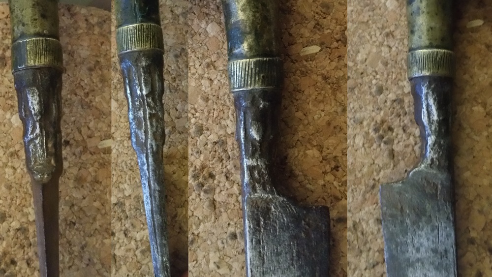

The close-up, sorry I didn't manage to do better.
Old 26th December 2017, 11:39 PM   #7
Hello Séverin,
No worries, these are good enough to verify that this blade is a genuine, typical LP blade of considerable age! I probably never was a high-end piece (some decorations are missing) but more of a modest/decent quality; still, it deserves real Batak fittings rather than the current parody it came with. I'd hide the scabbard in a drawer and even consider to remove the whole hilt: This might sound like a drastic approach but I'm sure it will do the blade justice and arguably make a better display for a cultural fossil...

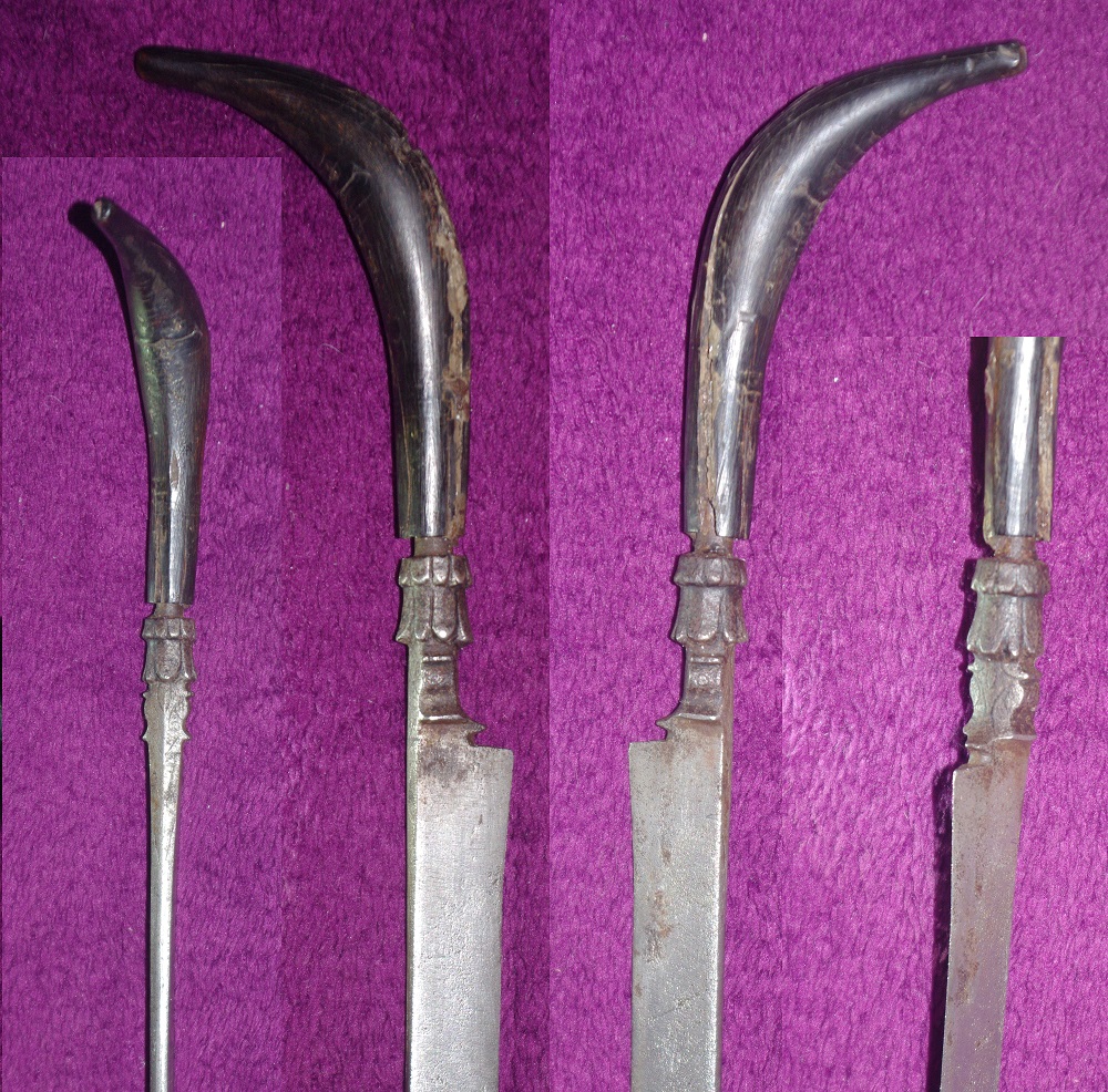

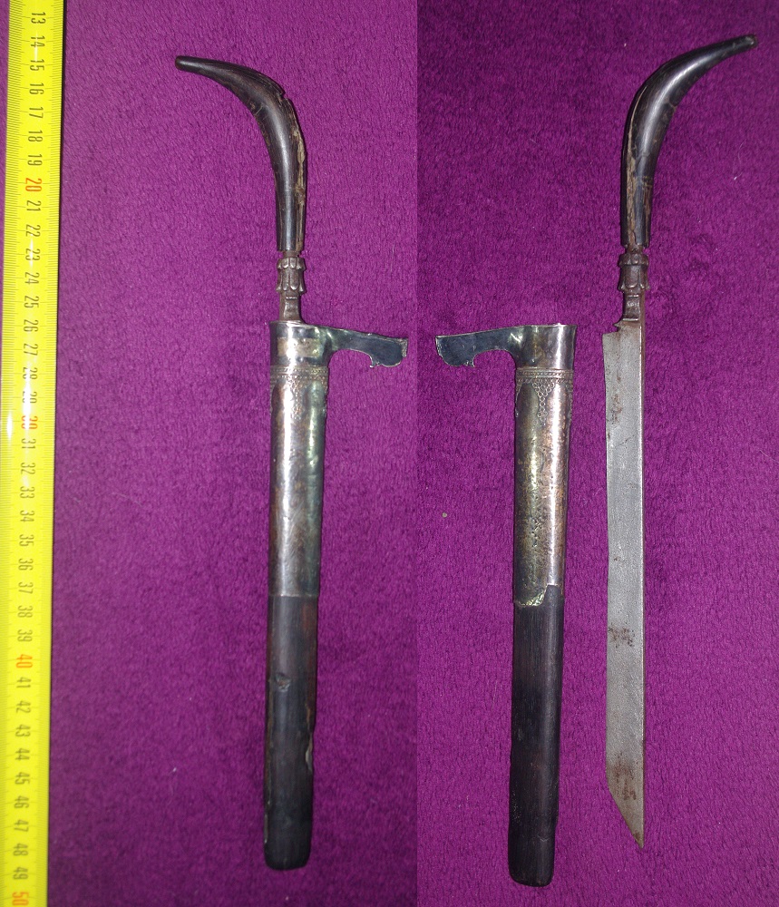

This is my new Lopah Petawaran. It is more traditional in its form, but the blade seems more recent (there are fine decorations incised on the blade which are eroded therefore difficult to see). The base and the tip of the handle was to be covered with silver but these decorations have unfortunately disappeared.
It's not a masterpiece but it was in my budget ...
Thanks, this is a really nice Karo example!
Blade is genuine and old, certainly well into the 19th century. The remnants of the engraving are traditional and suggest that this blade is a high-end piece (or at least quality is well above average!).
The horn hilt also looks genuine. Are there any marks left of (now missing) metal rings? From the looks of the ensemble, rings of silver (and possibly suasa) might be expected; however, unless there is clear evidence of them missing, I'd not necessarily speak of any missing rings and also would not replace any...
The horn hilt clearly has age. I might consider cleaning the tang and refixing the hilt; there seems to have been some shrinkage of the horn and a rusting tang may continue to crack the horn - thus, some TLC may help this piece to survive with as little further damage as possible.
How well does the scabbard fit the blade? It's of nice quality and of a known style. Was there anything of note written on the tag?
There are three marks about 2 cm from the base of the handle. There are also remnants of resin that go from the base to the height of these marks.
The tang is not rusty and there is resin residue inside the handle.
The fitting between scabbard and blade is good but not perfect.

Hello Séverin,
Well, the flash does prove a bit of red rust to be present...
The tang looks robust and it is possible that stable and active rust are relatively thin.
How wide is the gap? 3-4 mm? There may be a single "crown" missing here (usually made of suasa)!
Sounds good - given some erosion of the blade and shrinking of the wood a perfect fit is not to be expected.
Congrats, looks like a nice, genuine ensemble!
