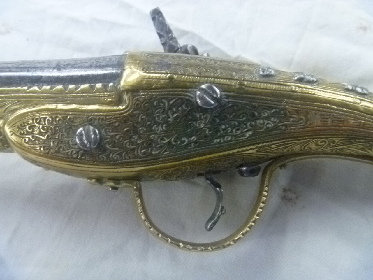

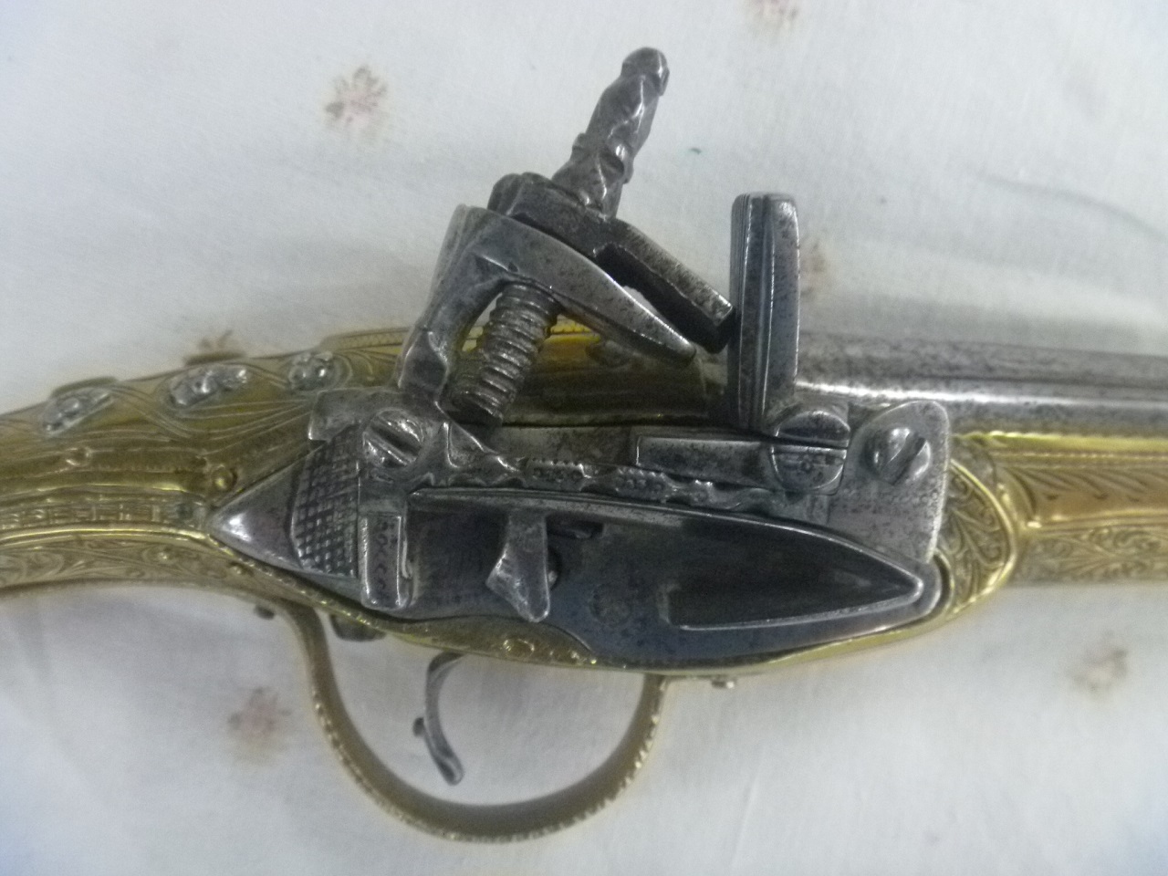

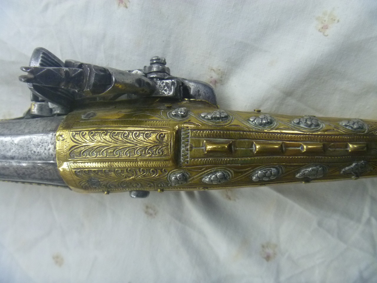

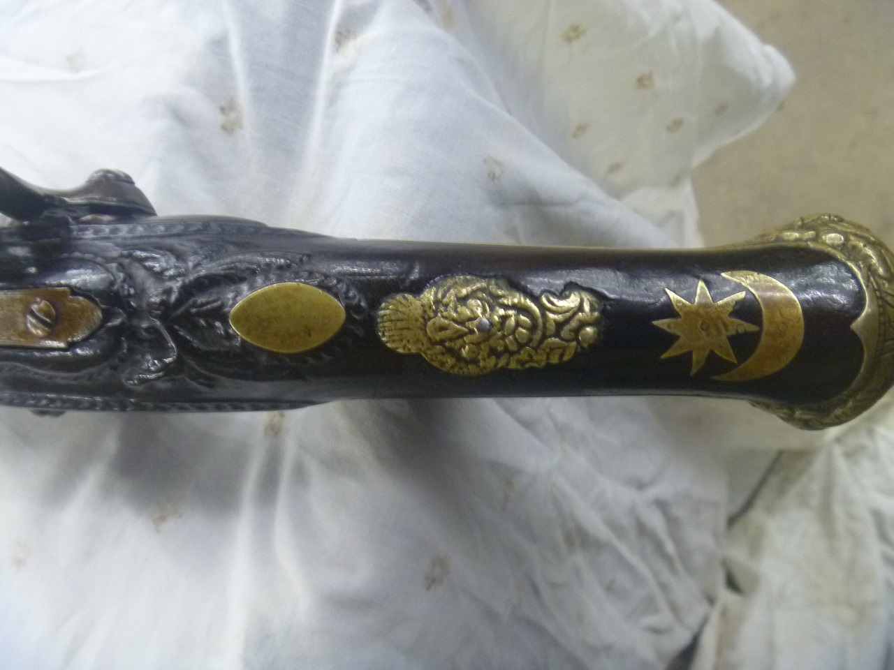

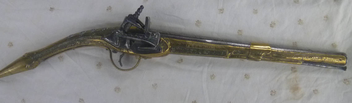

OK then. The first one, I think, is an Albanian Miguelet (Rat Tail) flintlock pistol. Have I got this right?
Is there a way to tell a fake from the real deal?
There are no markings that I can find on the pistol.
If it appears to be a legitimate piece, how do you determine what era it is from?
Many thanks

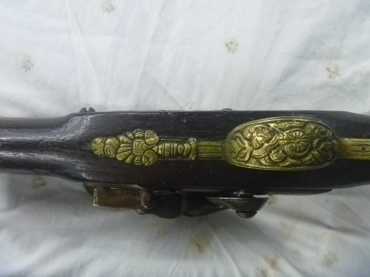

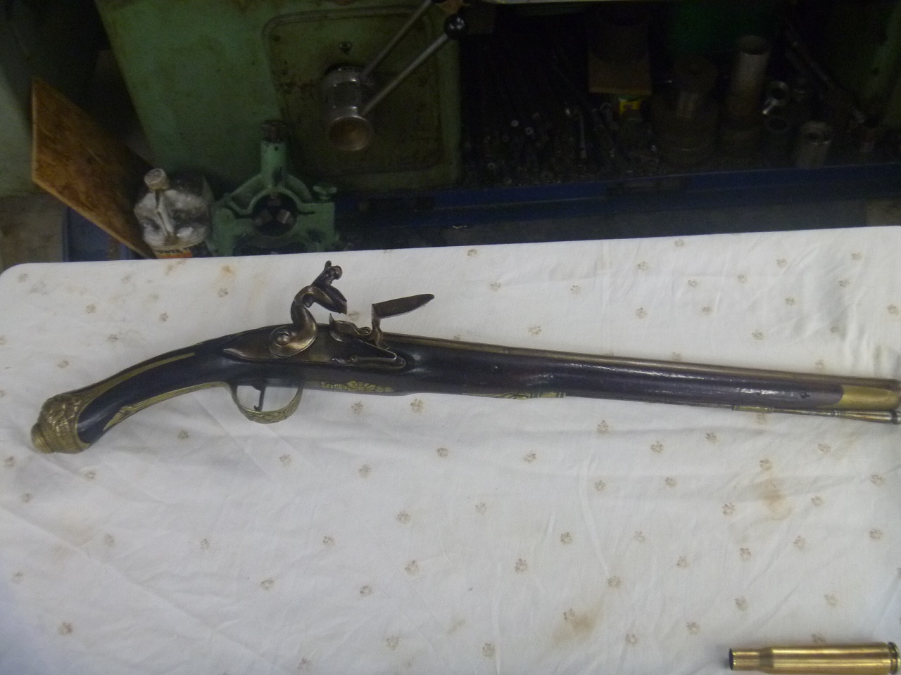

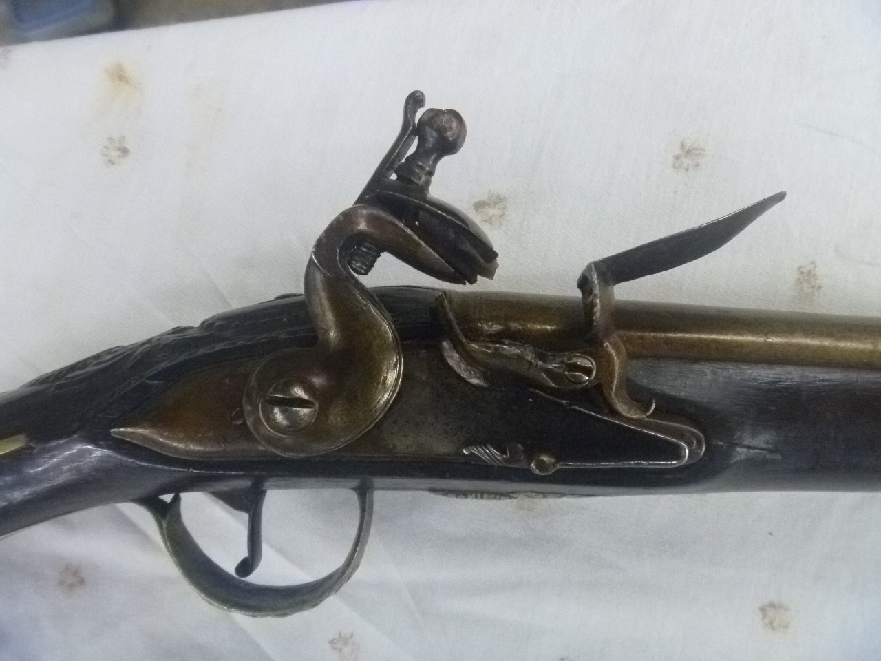

This one I beleive to be of French manufactured pistol, for Turkey or maybe more broadly the Ottoman empire. How close did I get?

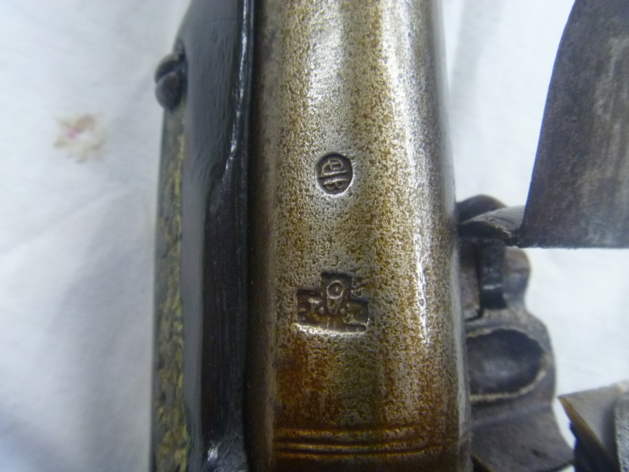

I am going to get better photos of the marks on the top of the barrel later in the week.
Once again, is there any chance of picking a fake from the real thing.
What period do you think it is from?
Forgive the quality of the last photo, I'll get a better one this week. I only added it because of the detail at the root of the spring.
Many thanks
Yes, you are right.
It looks real
Markings only appear from time to time; and some times they may not make sense.
second half 19th century ?
... but let others correct me where i am wrong .

Hi,
Rick is probably the best member to answer.
Yes your first pistol is a very good rat tail.
The second one is a so-called mediterranean pistol, French, Italian for export I dont know... In good condition but not a masterpiece. I prefer your rattail, both 19th c. of course.
Kubur

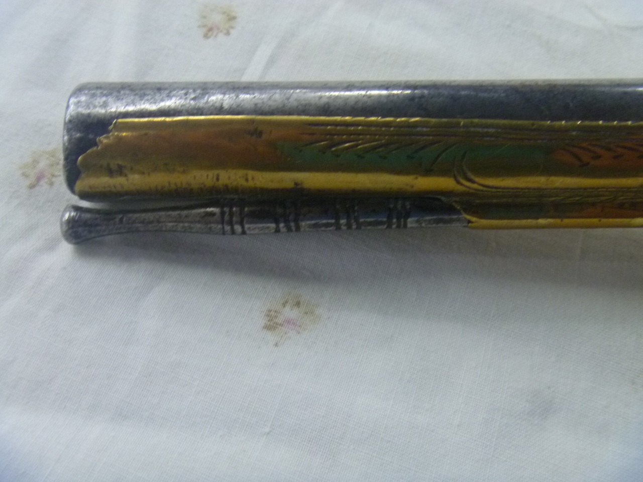

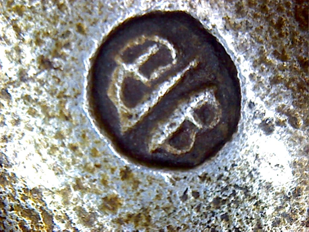

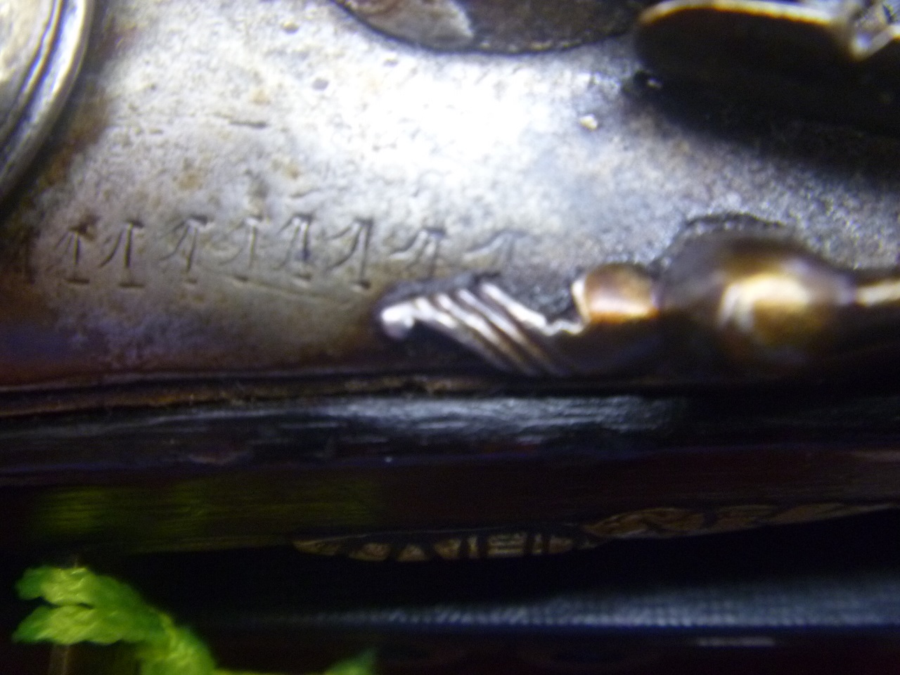

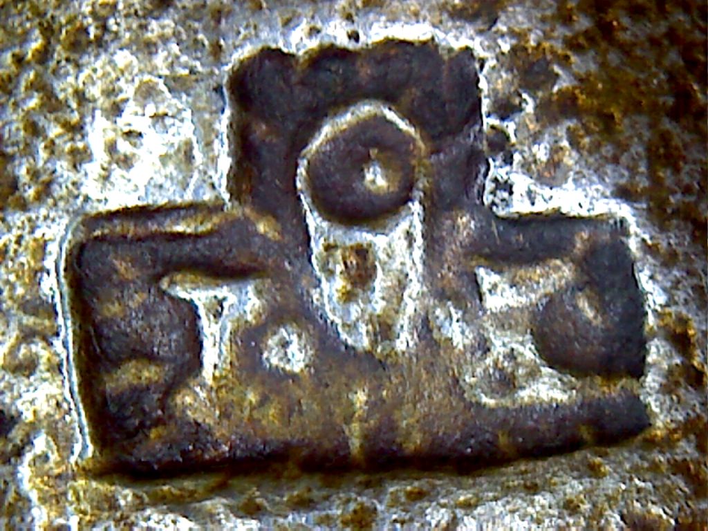

Here are closeups of the marks on the wooden stocked pistol.
Can anyone identify them?
ozhunter is offline   Reply With Quote

Hi OzHunter. Again, welcome to the Forum. Two very nice pistols that appear in very good condition. Generally, I agree with everyone above.
FIRST PISTOL: Yes, this is what collectors generally identify as an Albanian Rat Tail Pistol. And this one is typical of the style. Probably made during the second or third quarter of the 19th Century. What Andreas says that Elgood mentions in his book is as he mentions. However, I have never seen or examined (many) any of these Albanian brass stocked pistols with a full length working ramrod. They were all short, false, iron rods. (I believe the brass rods occassionaly encountered are later replacements). In fact, the short rods on these Albanian pistols are often tapered on the end to almost a point. It's my personal opinion that this was done to be utilized as a vent pick. It's also why the rods are difficult to remove now. The point end being driven in similar to a nail by someone not knowing what they are doing. However, I've found a fairly simple way to remove these rods. Let me know.
SECOND PISTOL: This is what collectors generally call an Ottoman Horse (Kubar) Pistol. And is typical of the style you encounter. The grip area of the stock on your's has the somewhat lesser encountered 18th Century Italian shape versus the more common 18th Century French style. The gun was likely made at one of the many gun making centers in the Balkans. Probably second or third quarter of the 19th Century. Again, the false ramrod being commonplace. If you can remove the lock on this pistol and take some photos of the inside, we would have a better clue if it was a European export or a locally made copy. The barrels are almost impossible to tell if imported or locally made without removing the breech plug. I've found the threads on the breach to be done different on locally made barrels vs European. These pistols were made by the thousands, often under contract with the Ottoman Empire. Unless made as a pair, you never see any two alike. Whereas the Albanian Rat Tail styles look almost identical in every one you encounter.

My posts are still being vetted, so I don't know in what order you will see the posts, but what do you make of the two "proofs" that I posted closeups of?
Old 20th March 2016, 05:36 PM   #18
rickystl
Join Date: Jul 2010
Location: St. Louis, MO area.
Posts: 1,633
Hi Oz.
Unfortunately, makers ID and marks are not one of my strong points. And I can't read Arabic, so that makes it even more so. But there are others on this Forum who can translate, and possibly be of assistance.
It is very difficult, if not impossible to identify the final gunshop that assembled these Ottoman style pistols. Often, the barrels were made in one shop, the locks in another, and the stocks and decoration in yet another. And that even assumes all three items were made locally. Some parts may have been imported, which adds to the confusion. The barrel could have been made locally and stamped with the maker's mark. (Which I believe is the case here) Or, the barrel could have been imported, and stamped locally. The same situation with the lock. And often, the lock (and barrels) would have a spurious European type name stamped or engraved on the lockplate, to give the false impression that the gun was from a European origin, which the maker would probably charge a premium price to the unsuspecting prospective buyer. So it can all be very confusing studying these guns. There is simply no "paper trail" tracing the origin of these pistols, unlike their European counterparts. In fact, the gunsmiths and shops often did not want the gun traceable, since they were sold to both friend and foe alike.

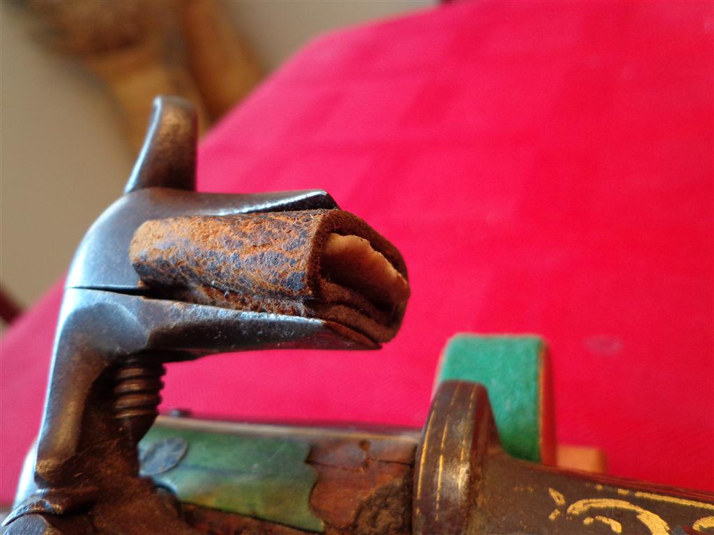

Without seeing the inside of your lock, there is one clue that the lock was locally made. Notice the top jaw was made with a slight downward curve. I believe this was done to allow the leather holding the flint in the jaws to be wrapped around the flint in horizontal fashion vs vertical as shown. I've only seen this top jaw design on Ottoman style/built locks. I've never seen this feature on European built locks. That's likely the reason the top screw doesn't sit exactly flush on the top jaw. See photo below.
Anyway, I'll stop rambling on here. A very attractive pistol.
