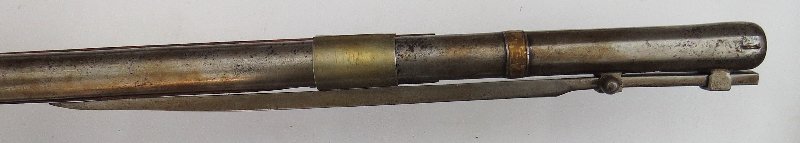

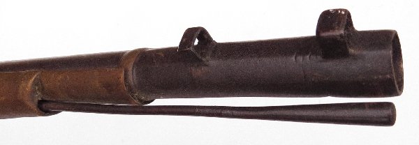

I'm making a guess at calling these military due to their shorter length, the fact they often have provision for a bayonet (of various designs), and they are of very plain design normally.
Does anyone know anything about this form of matchlock?.

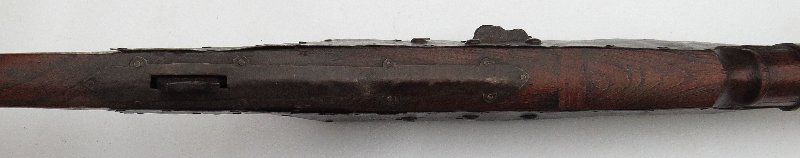

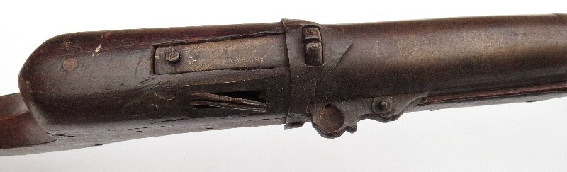

More photos of the top one.

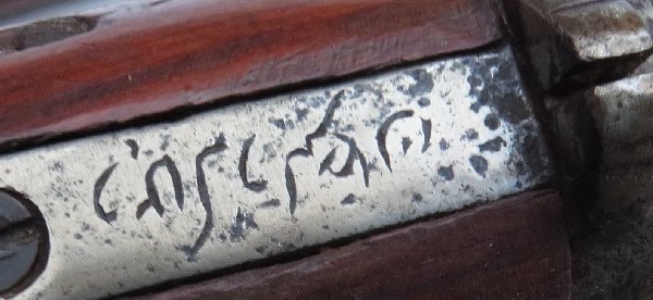

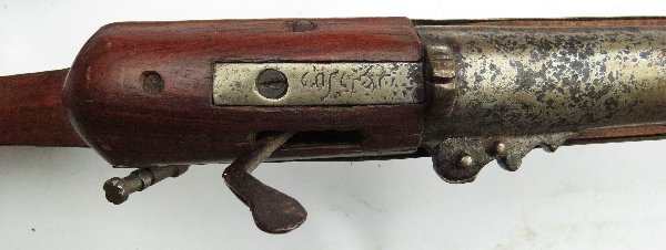

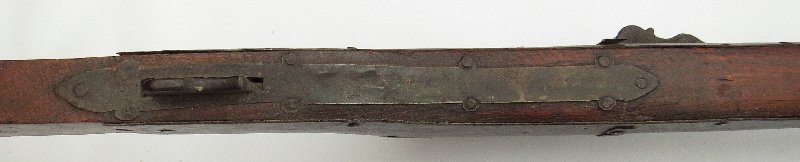

The middle one of the three with the reversible bayonet has an inscription on the breech tang, any ideas?
It has a holder with a vent pick, but I suspect atleast the pick is a modern replacement.

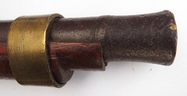

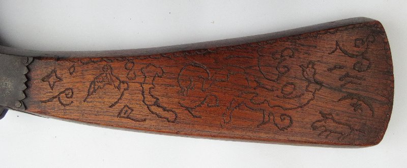

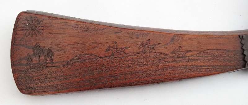

The bottom one is of much heavier constructions with a very large bore, almost a wall gun but for its short length, its not been cut down, the barrel has a flared muzzle.
Also interesting is the folk art to the stock on both sides, has anyone seen anything similar?

Good morning stenoyab.
Thanks for these photos.
They do seem to be munition -grade, rather than sporting, and as you say, the bayonets tie in with this. I hadn't seen a matchlock bayonet before so thank you for that!
By the shape of the stock, I'd say Scinde as the area of origin. They Do look very sturdy arms!
Not sure on the last one,....the doodlings, they look very Western to me. Typical sunshine and trees, and blokes on horseback, and I Think I see a moose on the other side!

Any ideas on the inscription on the second one?

Hi Stenoyab.
Thanks for posting these photos. Especially with the bayonet features.
I agree with Richard. These appear to be munition grade matchlocks. The butt stocks do seem closer to the Sind (Sindh) variety. But the barrels and hardware do look Indian. Too bad about the doodling on the one butt stock. It does look American/European style folk art, and done latter.
No matter how many times I see these guns, it still amazes me how long they continued to use these matchlocks on the Continent.
