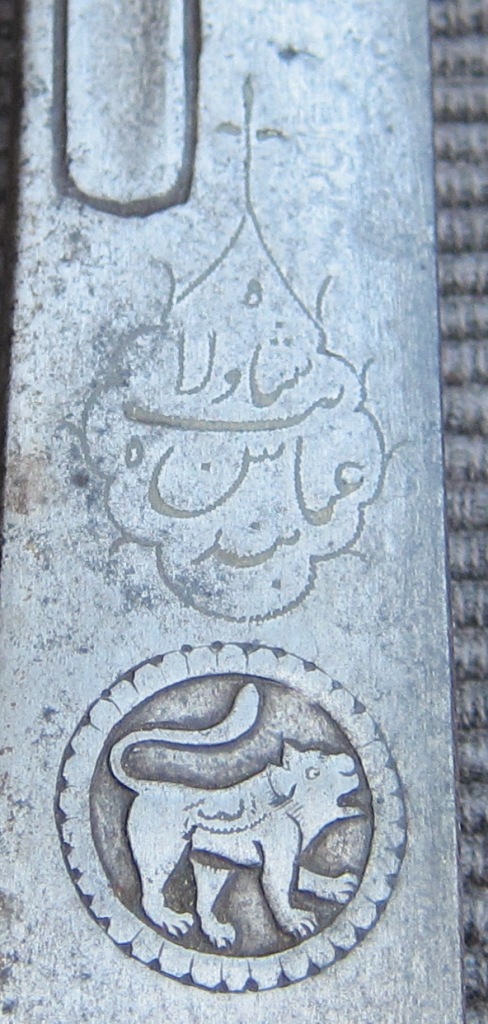

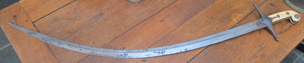

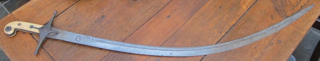

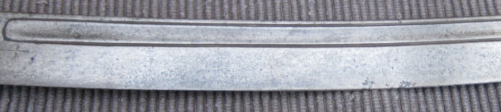

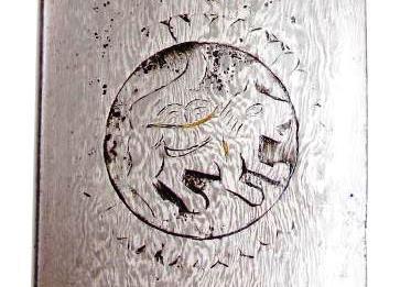

Completely outside my sphere of collecting.
I am going to guess that this is a Persian ( lion on blade ) watered blade, shamshir.
I have just mildly cleaned one section of the blade to show the lion and the pattern.
I would appreciate any information from the experts.
Thanks
Roy

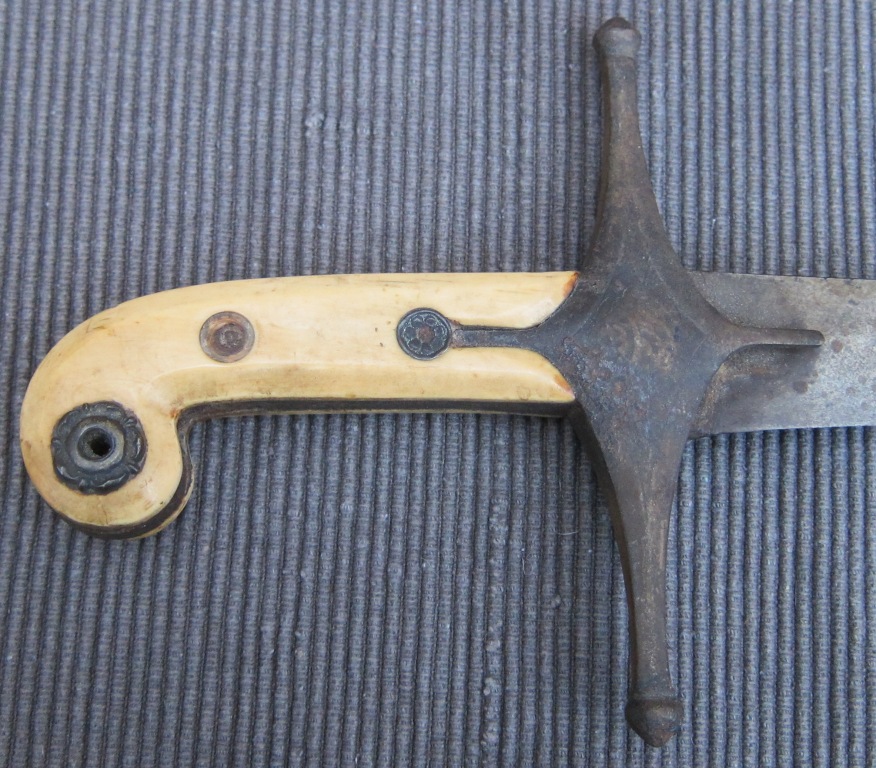

It looks like private purchase British Mameluke sword. Handle looks like bone.
Indian army military?

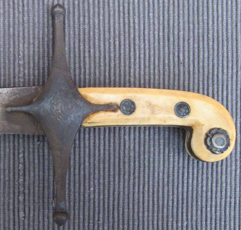

It is certainly a Persian shamshir.
The blade is inscribed in the upper cartouche, ABBAS SHAH BANDE-YE VILAYET, which was the title adopted by Shah Abbas I (r. 1588-1629) and used by shahs of Iran thereafter. The lower cartouche, depicting a lion, also bears the name ASSAD. This is a transitional signature discussed in my article, which Ibrahim kindly cited. The wootz pattern is evident in the photos.
The guard is original. Though corroded, fine chiseling is evident.

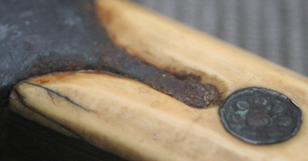

The grips are ivory, in Mamluk style, but may be Persian work as well.
On cursory examination, it probably dates to the second half of the 18th or beginning of the 19th century.

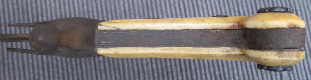

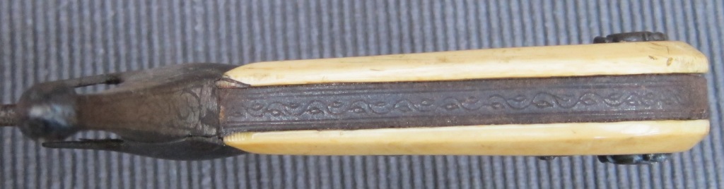

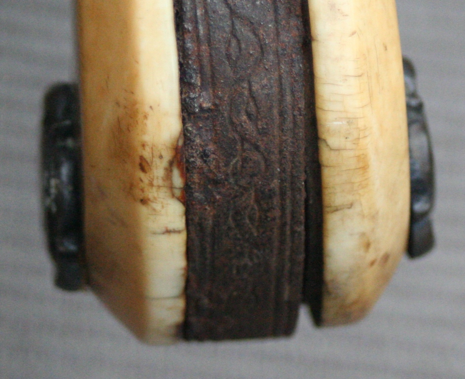

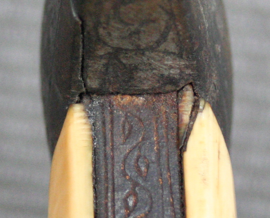

Thanks for the information everyone. As I said, not my sphere of collecting so all of this is very helpfull.
I had not thought that the grips are ivory as I could not see any obvious schreger lines. One of the new photos, of the end of the pommel does look more like ivory now I have looked more closely.
Tim, I cannot account for the file marks, but if you look at the new photos, I do not think anything about the hilt could be called "fresh" I don't think the grips have been off for a while. If it has been restored and replaced it looks as though it was a good while ago.
Thanks again
Roy

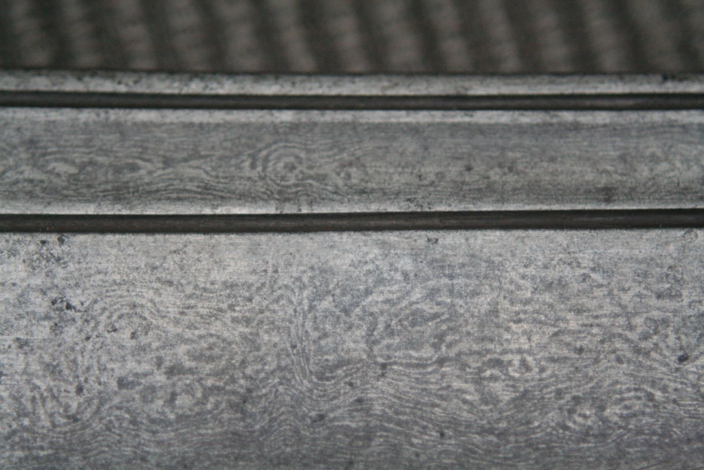

Not only is it wootz, but the last photo above clearly suggests a ladder pattern.

The very last picture in the Royston's array shows small pieces of handle material inserted by the crossguard and the pommel seems to show discolorations (?) at the inner parts. I cannot be certain whether it is the minor remnant of the inner part of the cattle bone or true ivory: only Royston can tell.
If it is a Mameluke style ( which it is) it cannot date to 18th century. Those appeared only in the 19th, more around the middle of it.
It lacks the precision of British General grade Mamelukes, thus I would suspect native Indian manufacture.
You have way more experience with these pieces but please have a look at this pic again (I tried to enhance the contrast):
1. I do see the ladder-like manipulation - from the limited area shown it doesn't seem to be very regular though.
2. I still see a pattern-welded blade here, not wootz.
Roy, could you post some more close-ups and possibly a somewhat larger stretch of the blade if a repeated ladder-like pattern can be seen?

Originally Posted by kai
Hello Oliver,
Hello Kai,
One essential thing to remember is that the photo shows a greatly enlarged patterning.
It is undoubtedly Persian wootz, albeit I am not so sure abbout the Kirk Narduban feature as there is not enough of the blade in the photo to see any repeating pattern, and the enlarged photo can be misleading.

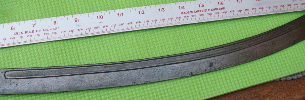

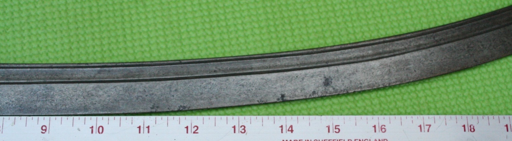

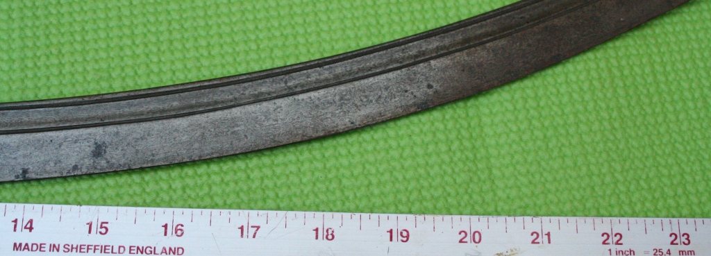

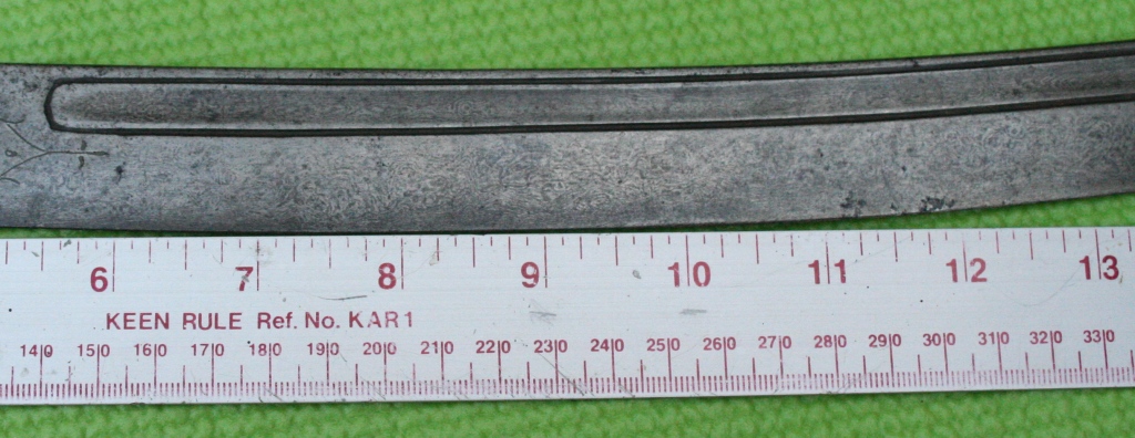

Not being the best photographer in the world, these are the best that I can manage since I broke my wide angle lens recently.
You can see the blade gets darker where I have not done any cleaning.
Hope they are of some help
regards
Roy

May I ask why? Also when you don't want to polish and etch the blade and prefer a blade with old patina is the careful cleaning Royston has given the blade (so far I can see) will bring out only the beauty from this blade and will prevent corrosion.
