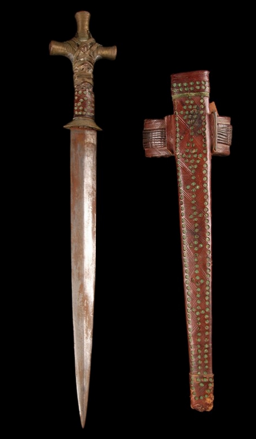

I bought these daggers recently, and see the type has featured on the forum in the past. They are usually described as "Tuareg telek", but I wonder if they were used by other Sahel peoples such as the Hausa etc.
Can anyone provide more information on the subject, and any references as to variances of the genre etc ?
Thanks in advance.

Hi Colin,
My opinion is tghat in the concrete this your daggers were used by Tuaregs (and maybe some specific clan) and maybe also their menial men. Definitely not by Hausa and Bidda, and probably not by Fulani. But this is only opinion, I did not study literature on this.
Martin

Hi Colin,
To echo what Martin has written, as far as I know these are more or less a Tuareg exclusive. There are apparently regional differences in terms of the hilt styles.
While forms like the takouba cross over between groups, arm daggers seems to be one of those areas where a more tribal approach was taken.
My understanding from looking at museum examples with collection notes is that your pair is probably from Niger around Agadez.
Attached is one of the other major styles which is associated with Algerian Tuaregs. (image source: Musee du Quai Branly online collections).

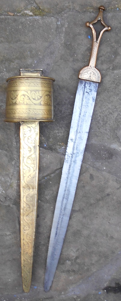

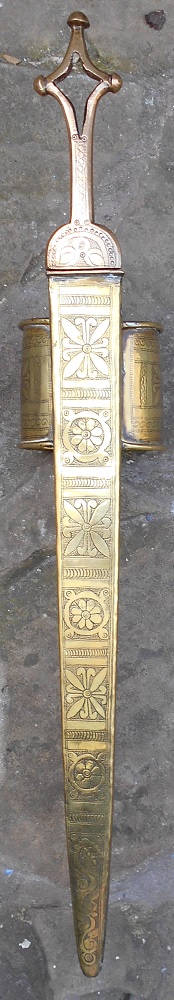

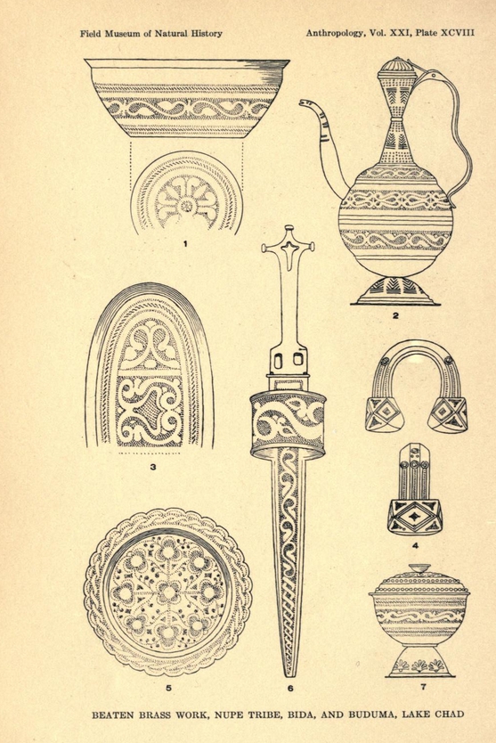

Posts: 5,999
I used to like these especially the long Tuareg? form. The only one I have left, which I kept as metal keeps better than the rather delicate goat leather. Is a Nupe? among other peoples example. Typical Bida workmanship.
Hi Tim, should be Nupe from Bida. But that doesn't mean they didn't export them for Tuaregs!

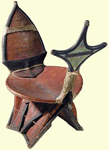

Thanks to those who have commented on these daggers. I note the hilt form is similar to that on Tuareg saddles (see image attached). There is a dagger like mine illustrated in the book "Waffen aus Zentral-Afrika" published by Museum fur Volkerkunde 1985, in which it is described as from Bornu..
I have noticed a feature on my daggers, also to be found on different types of Sahel/Sahara spears, ie. those two brass rounded protusions on either side of the blade socket. Can anyone shed some light on their purpose - symbolic in some way ?
On the Bornu attribution; my impression is that the designations in that title are based purely on the collection locale. Obviously with a wide ranging group like the Tuareg this means there's a real potential for a dagger to show up fairly far away from where it was made.
The cruciform hilts are similar to the saddles. I believe the construction is similar as well in terms of wood being utilized.
