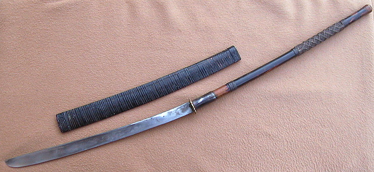

hi
blade 46 cm
hilt 55 cm

This is a form of dha. From one of the various hill tribes loosly referred to as "Montagnard". Probably from Laos, but some are attributed to Vietnam and Thailand.
The very long handle, small disc guard and "hatchet" tip are typical of the form.
Nice example. The scabbard looks newer than the blade and handle, and these scabbards are most often seen completely bound with rattan strips.

many thanks Andrew for this clarification !!!!!

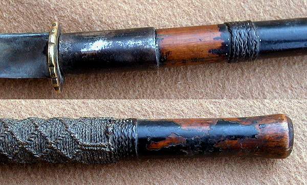

Posts: 4,735
Another example. Similar style of wrap on the hilt.

Out of curiosity, how far up the hilt does the tang go on these dhas?
Old 15th February 2006, 04:18 AM   #7
Andrew
Andrew's Avatar
Location: USA
Posts: 1,725
Not very far, Fearn. Most dha have short, spiked tangs, and these are consistent. Mark did an informal study about this a while ago and there's an old thread in the archives about it.

Indeed. You find through tangs very rarely in dha, and I sometimes wonder at their authenticity.
I read in Ferrars & Ferrars' "Burma" that the short tang is used to minimize vibration in the handle when the blade strikes. Andrew has done test cuts on several dha, including a modern custom one which I think has a long tang, so maybe he can comment on whether or not this is true.
