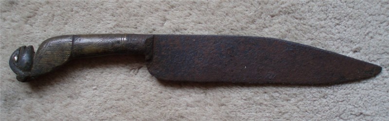

This knife came in an inexpensive auction lot labeled "Two Mexican Knives." The other knife was a larger Filipino knife from Luzon, more specifically from Laguna Province, and was probably late 19th-early 20th C. That knife was the one that interested me and this smaller one was a throw in.
However, I am stuck on what this knife is and where it came from. It does not look like anything Filipino that I have seen before, nor particularly Mexican.
The blade is clearly old, heavily pitted, and much used. The recurved edge and drop point suggest a domestic tool rather than a weapon to me, somewhat similar to a hansia found in Nepal and adjacent areas. The handle is bone, the partial tang is secured by a single large pin, and there is a small metal ferrule. The bone is deeply carved with scroll work.
Thoughts and suggestions welcome.

Hi Ian,
It's a piha kaetta, a simple one, from Sri Lanka IMVHO!

Thank you Detlef and Alan!
I did not realize that piha kaetta came in a "simple" form. I don't think we have another example posted in the Forum. Any idea how old this one may be? How common are these knives and what were they used for? I would think they are utility knives, but would love to know more about them.

Hi Ian,
Have seen a lot by auction houses and as well by epray over the years. And I guess like you that these are utility knives, maybe for cutting betel? I just don't know exactly.

So far I know there are different piha knives, all for different purposes. I don't think that the two shown examples here are status knives.
In old threads I found indeed only one similar example, see pic.
