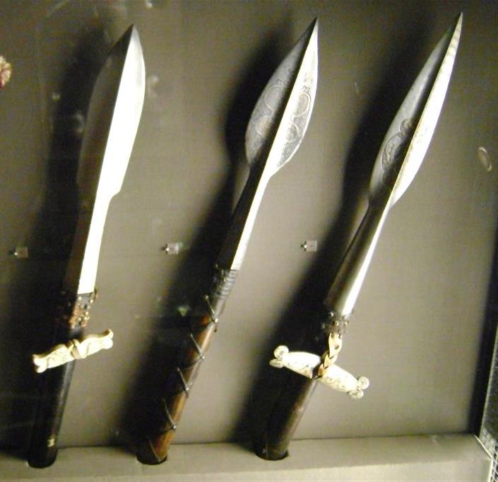

Boar spears at the Philadelphia Museum of Art:
