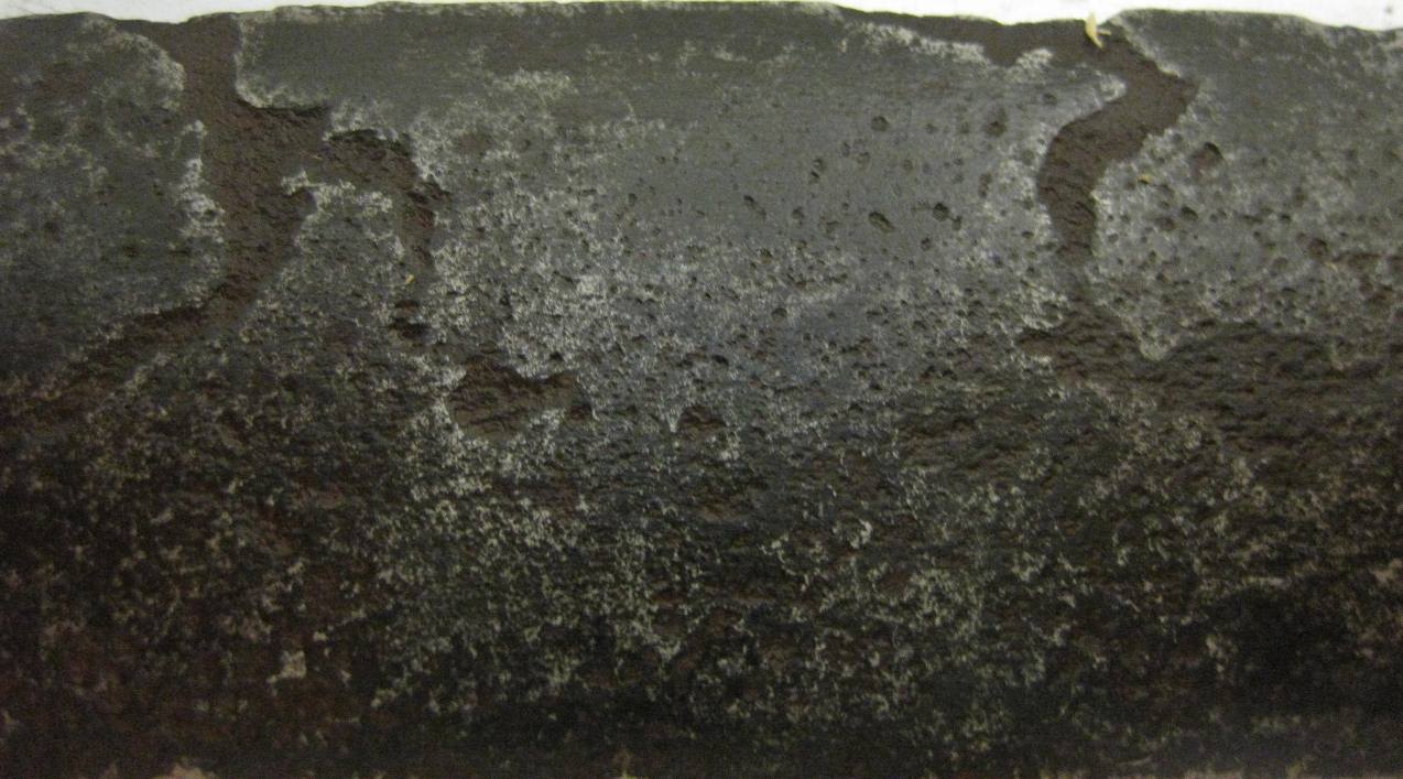

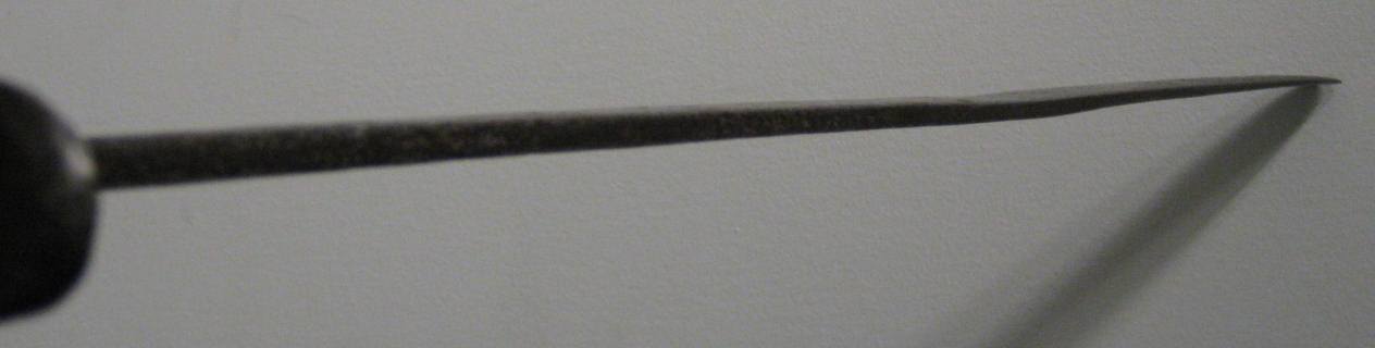

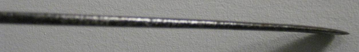

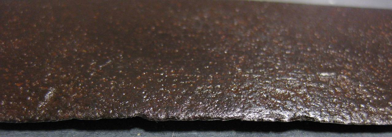

It arrived in the mail today. My impressions:
The blade is extremely thick and heavy. It's 8mm thick at the base. It has no flex whatsoever. The steel's heavily pitted and the edge is all chewed up, but it looks like it's from blunt impact, perhaps hitting a nail or a rock, rather than blade on blade damage. It seems to taper naturally to its tip which I wouldn't expect if it was a cut down blade. That is unless the also ground the blade thinner towards the tip when they did it. The whole blade's a little crooked and twisted but I don't know if it was made that way or if it came that way through hard use.

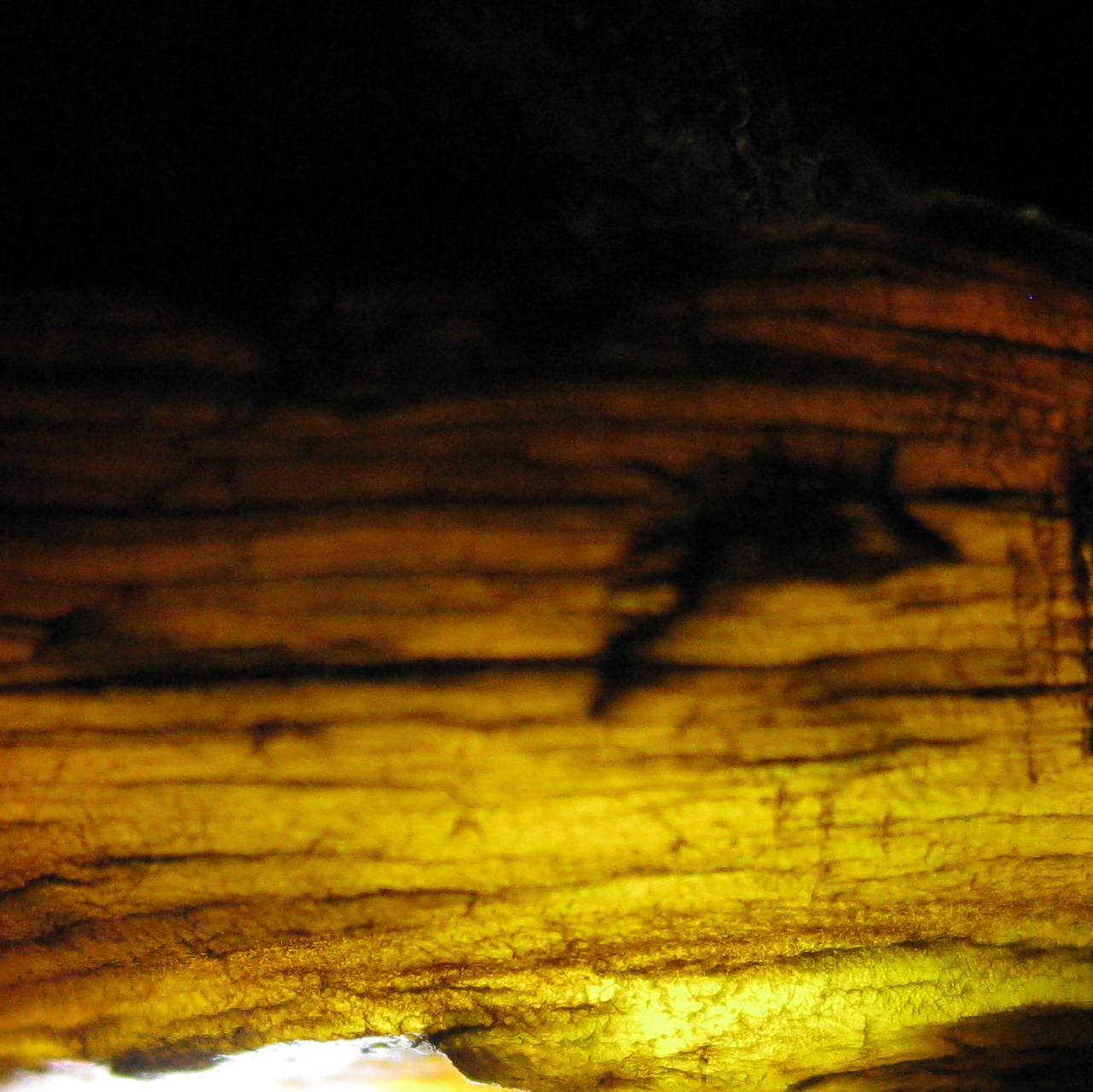

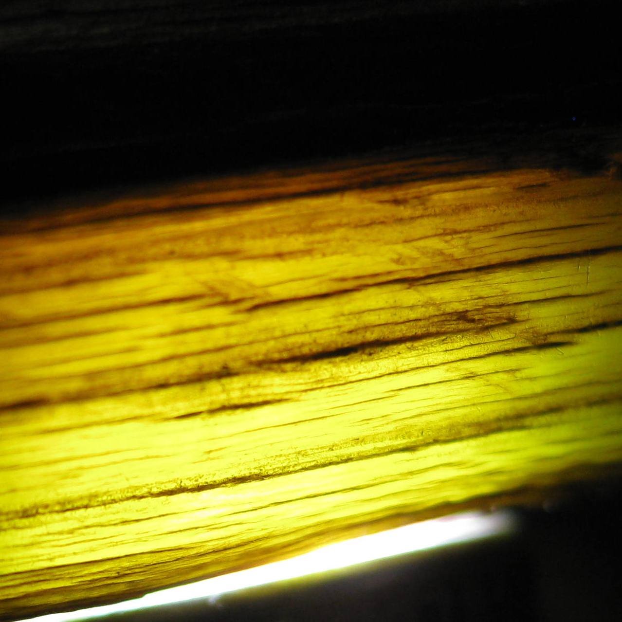

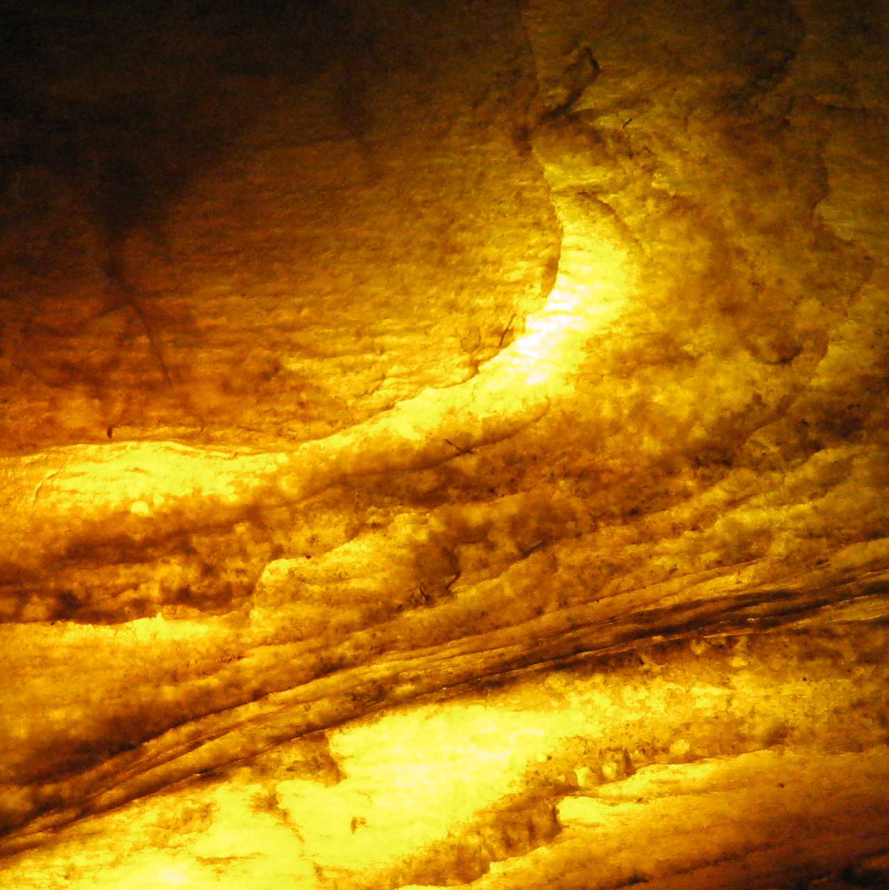

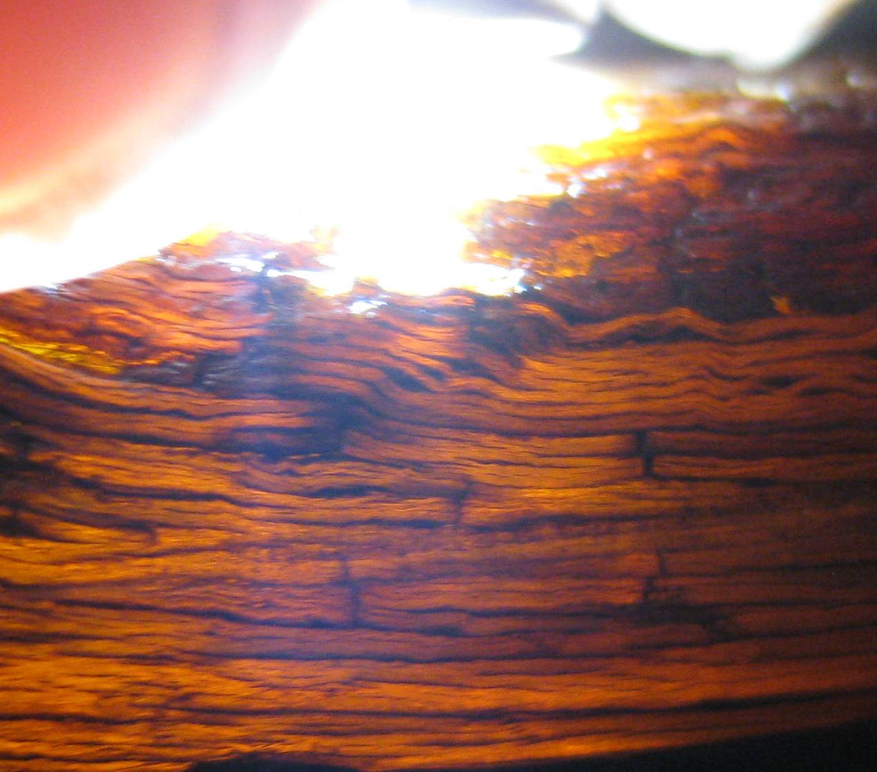

The hilt is definitely horn. I attached some pictures of it from a few angles as illumated by a flashlight, but I don't see any signs of tubules or anything that would indicate it's rhino. I'm guessing it's goat horn that's been compressed into a flat shape?
