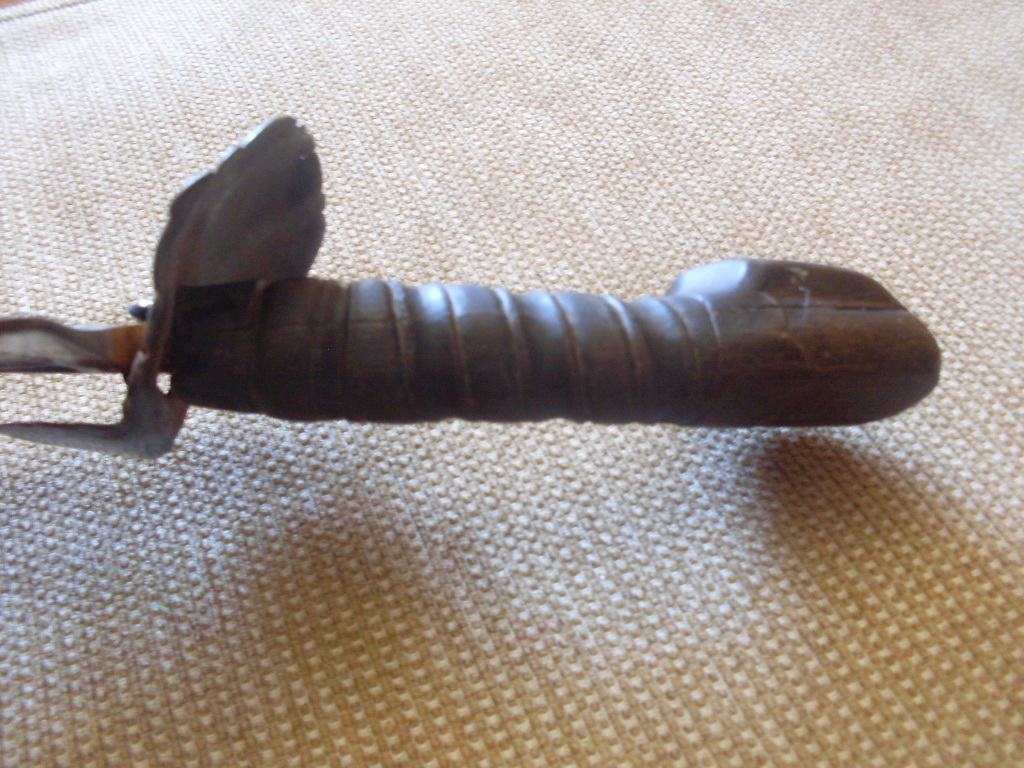

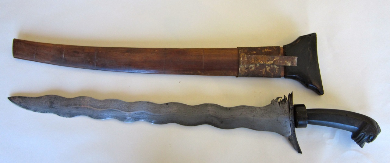

I just return from postal office and... surprise !!!
This is my last adquisition, a very unusual kris with shell guard. I have only seen another like this in the antique spanish army museum in Madrid, now in Toledo I donīt know if the wall plaque is exhibited.
The handle is marked with C S 22 and seems very old.
I wish enjoy pictures
I, m very happy now !!
best regards
carlos

That's a beauty Carlos. Very unusual! I wonder if that shell guard was originally on a different sword or was it made for the kris? The origin of the guard would probably tell more of the story.
The hilt is not your typical Moro design, from what i can see same with the one in the museum, not the typical Moro design.. It's odd that they would both be missing the clamps.
I wonder if they were captured and re-hilted blades.
I too would be very happy. Thanks for sharing.

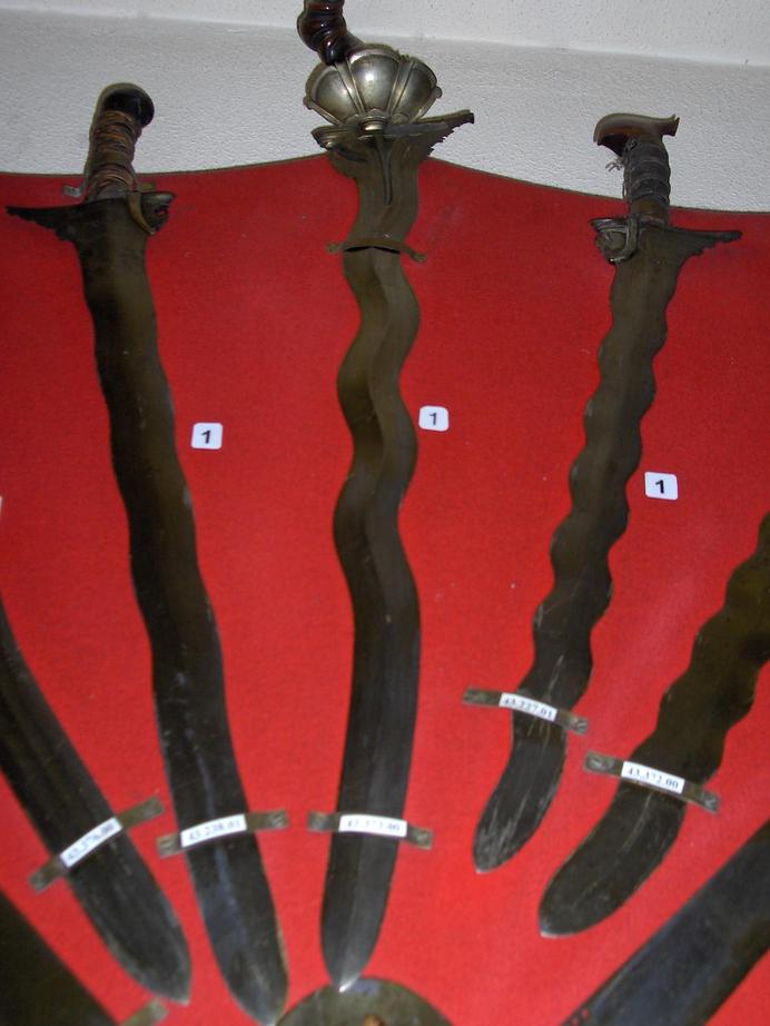

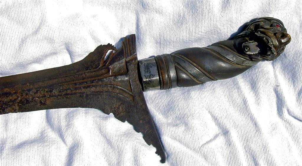

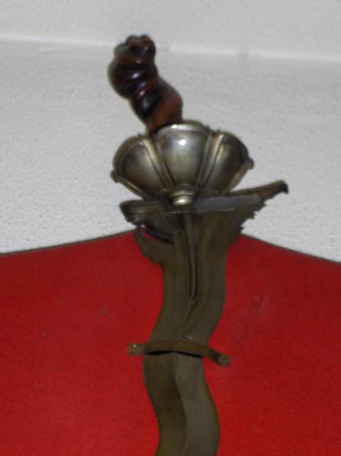

It's the time in the year to post Barry's kris again :
http://www.vikingsword.com/ubb/Forum1/HTML/000669.html
Old 16th April 2013, 08:02 PM   #6
Posts: 7,407
No argument from me a out what has been said so far. I will only add that the clam guard looks European on origin all the way through. Lots of trade and captured pieces with mixed parts.
Old 16th April 2013, 08:11 PM   #7
Gustav
Join Date: Jun 2009
Posts: 1,346
Looking at the features at the bade of the blade, the kris from museum is clearly the same blade type, and also a hilt with spiral:

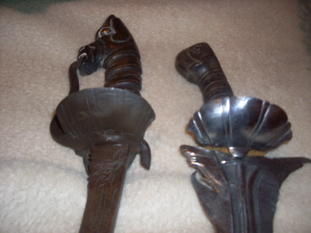

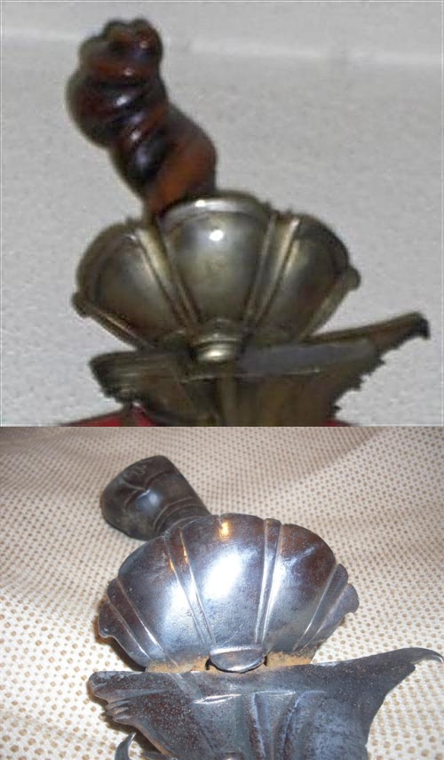

Posts: 2,196

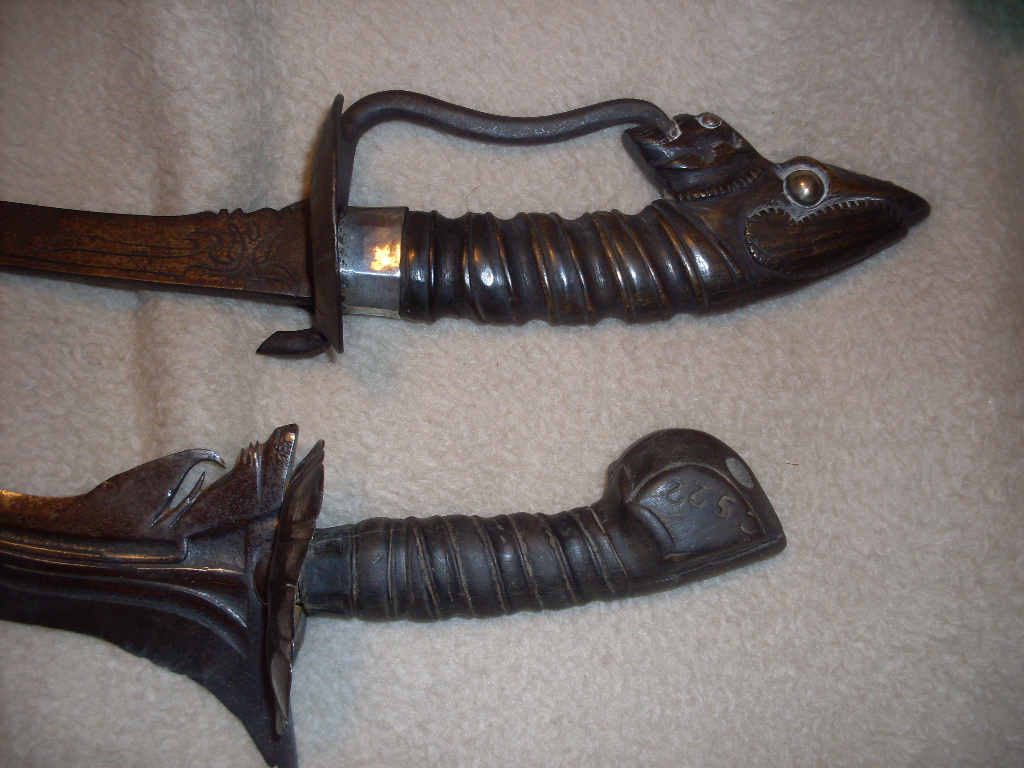

Photo of guards for better comparison.
Robert

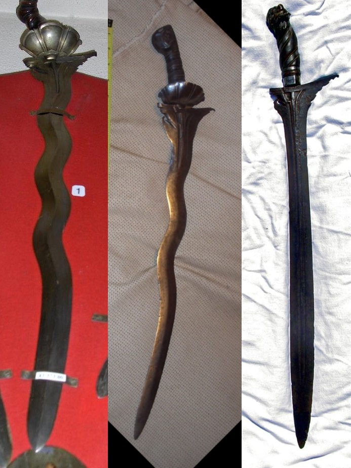

Old 18th April 2013, 01:01 AM   #18
I'd posit that we certainly have a pattern here!
Despite minor differences, the 2 wavy blades have obviously been crafted in the same, unique style and also have the same type of shell guard; moreover, Barry's blade is clearly from the same tradition as already noted by Gustav! And all 3 of them come with a hilt whose close relationship with the typical minasbad hilt can't be a mere coincidence and is certainly the most important feature for placing these enigmas.
Looking at the base features from a Moro POV, I agree with David that the blade esthetics are off. IMHO this (together with the consistant but unique style) clearly shows that these 3 pieces are very unlikely to have originated from a Moro (expat) community and most likely represent an acculturation by another ethnic group.
Actually this Bicol piece is not a kris.
I am not that sure, Jose. If we accept Lumad swords with kris-like base features as Lumad kris, we should also call these Bicolano kris IMVHO.
I am on record for not supporting Visayan "undulated swords" to be called kris since (except for a number of trade/booty Moro blades that got refitted in Visayan style) I see very little which supports the notion of a tradition entering another culture (rather than reproducing one or two features of a - literally - striking foreign icon).
These 3 blades are something different: they are representing an unique style of craftmanship while obviously trying to preserve most features of a Moro kris bauplan even down to minor details: IMHO this is a genuine offshoot of the evolving keris/kris tradition despite coming from a non-Hindu/non-Islamic culture.

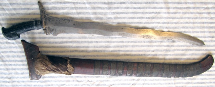

I don't have a lot of reference pictures but here are some (non exactly resembling Carlos').
Maybe some other forumite have a more resembling kris?

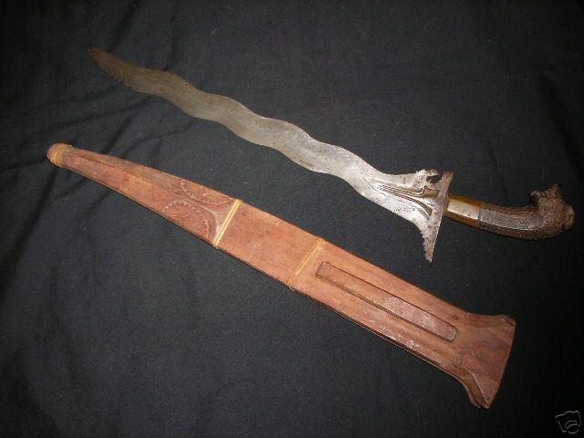

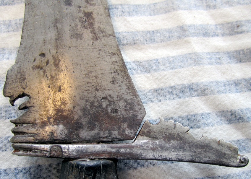

1) From eBay 5 years ago
2) Panay 1
3) Panay 2 (check the trunk)
Michael

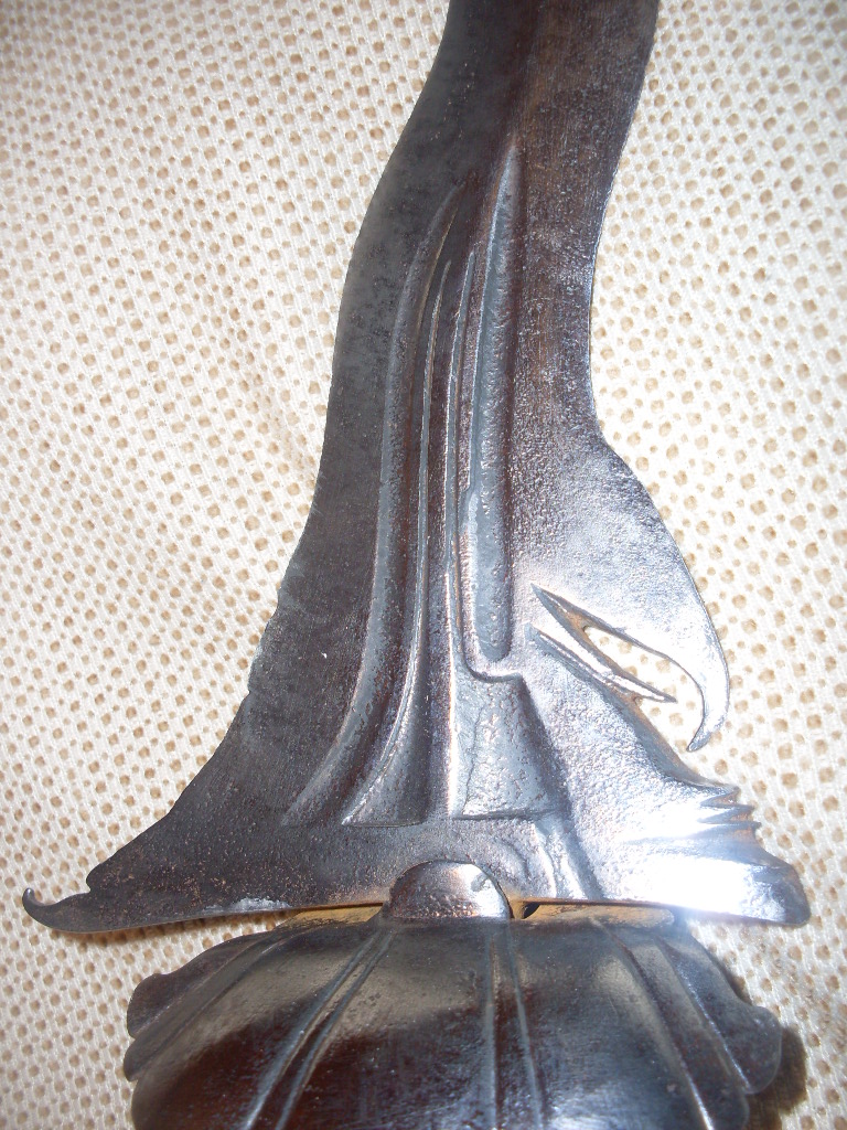

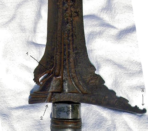

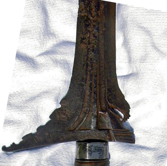

Michael, please take a closer look at the features of the base of blade at Carlos', museum's and Barry's kris.
For description of them I will use the Javanese terminology, becouse it is the most complete and most familiar one. I have chosen the picture of Barry's kris, becouse it is the single one most correct picture to analyse the features.
The way Kembang (Sekar) Kacang/Tikel Alis/Blumbangan/Gandhik/Jalen Area is arranged on all three krisses is almost identical and absolutely sufficient to understand them as the same variety (arrow 1):
Tikel Alis falls extremely deep into the Blumbangan (you will never see something similar on other krisses or kerisses), actually it falls deeper then the point where Jalen starts; the outer ridge of Tikel Alis continues the Tampingan; Gandhik is an extremely falling/sloping one; the way Kembang Kacang is cut is very similar if not identical, despite Carlos' kris not having a Jenggot.
A very interesting point is the indentation on Gonjo (arrow 2). It seems not to reserved for a clamp (like on Moro krisses), becouse it continues the (falling)Tampingan perfectly. A purely esthetical pupose?
The Kepet Urang (Buntut Mimi) of Gonjo (arrow 3) is bent up (or perhaps carved this way on museum's kris), something that does not appear often on Moro kris.
I must say, Carlos' kris is perhaps the crudest one of these three: there is a material left for Greneng and Jenggot, yet these these aren't cut out; no separate Gonjo.
All three krisses are narrow, the waved ones (Carlos' and museum's) do have the same kind of waves with long tip.
I also don't understand, why do you say Barry's kris has overall a higher resemblance to Moro kris blades. Actually, becouse of Wangun (widening of the blade towards the tip), its overall shape doesn't resemble a straight Moro kris at all.
To your examples: I don't see much similarities with the three former krisses, actually almost none. The Ebay example is superficially similar, becouse of more elaborate features, yet that's all. The Kembang Kacang/Tikel Alis/Blumbangan/Gandhik/Jalen Area is completely different worked, these is also a huge Bawang Sebungkul-like feature missing in all three former examples. The overall shape of the kris is a completely other one.
For the second example, I miss any similarity.
The third example has Moro/Javanese inspired Greneng, bent (or worked like it) Kepet Urang (like arrow 3) and the indentation on Gonjo (like arrow 2), yet here I think possibly has been a clamp. Here are some similarities, yet by far not so close as in-between the former three krisses.
A diagram for the features of base of blade:

Ok regarding the Bicol piece not being or being a form of kris, I guess I need to see the whole blade.
Old 20th April 2013, 08:11 AM   #27
Hello Jose,
Here the one from the Spanish museum.
How about the other two examples from Carlos and Barry?
Old 20th April 2013, 08:41 AM   #28
Robert
Robert's Avatar
Location: Centerville, Kansas
Posts: 2,196
This the best that I can do. Hope it is of some help.
Robert

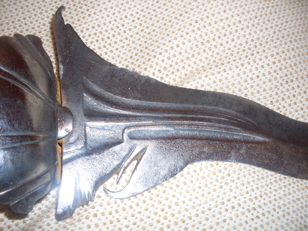

Default More pictures

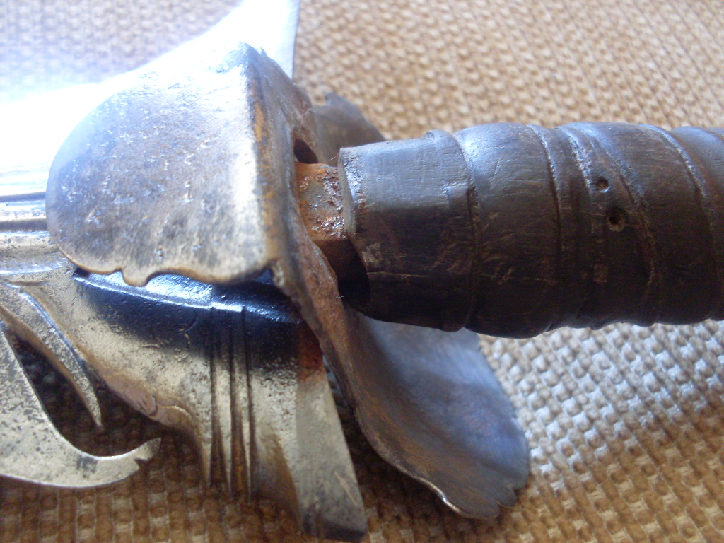

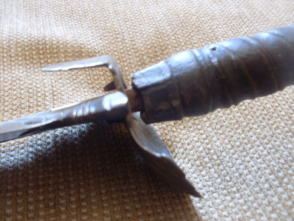

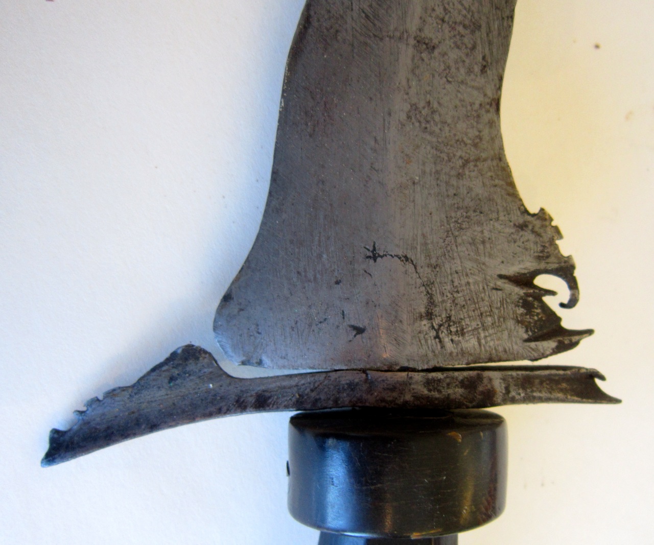

New pictures from the tang and place from missing ferrule ?
Best regards and thanks all for information
carlos

Carlos, are there engravings on the Gandhik (area under the elefant trunk), or are these just different overlapping metal layers? I see, this side of the blade base (from your previous post) is in much better state of preservation, perhaps becouse of the protrusion of the hand guard covering it. Now we see the other side has been extensively filed down.
If you were able to remove the hilt and hand guard completely, it would be very interesting to see a complete picture of this side (base of blade looking at it from 90°).
