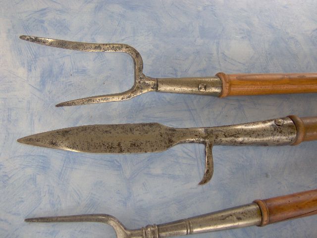

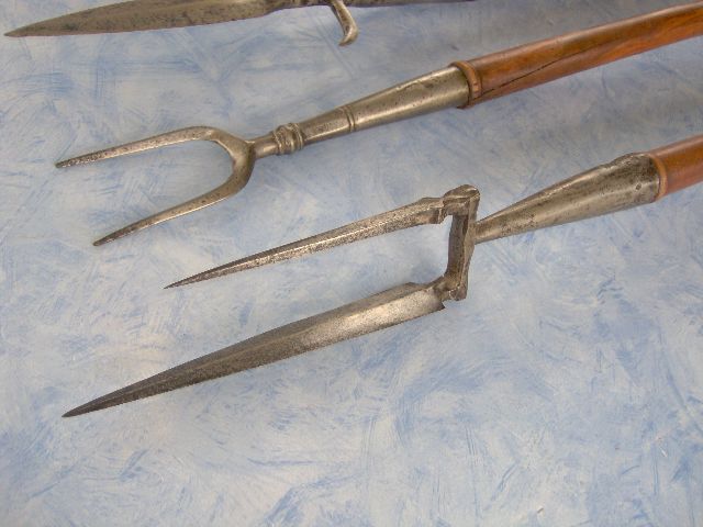

Default pikes for identification

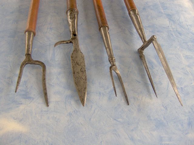

can identify you these Pikes, they are forged...for hunting or military???
thank
Old 3rd June 2012, 11:49 PM   #2
M ELEY
Location: NC, U.S.A.
Posts: 2,236
Nice pieces! I think from their pattern that they are perhaps Javanese? The haft also appears to be a tropical wood. Just a guess, though. Let's see what the others think-
Mark
Old 4th June 2012, 01:38 AM   #3
Posts: 6,441
I'm not thinking they're Javan/Indonesian Mark .
The gestalt ain't there .
The sockets look too crude, plus most Javan/Indonesian spears are tanged .
I have no guesses about origin though unless China .
Old 4th June 2012, 02:54 AM   #4
Matchlock
Matchlock's Avatar
Join Date: Sep 2008
Posts: 4,310
These seem to be so-called peasants weapons (German Kriegsgabeln), Central to Northern Europe (possibly Germanic, e.g. Italian, Swiss, Austrian or German), probably 17th-18th c. though they had been in use for at least a thousand years before.

I think that the wooden handles are not original, that they have been added after does not rely a them

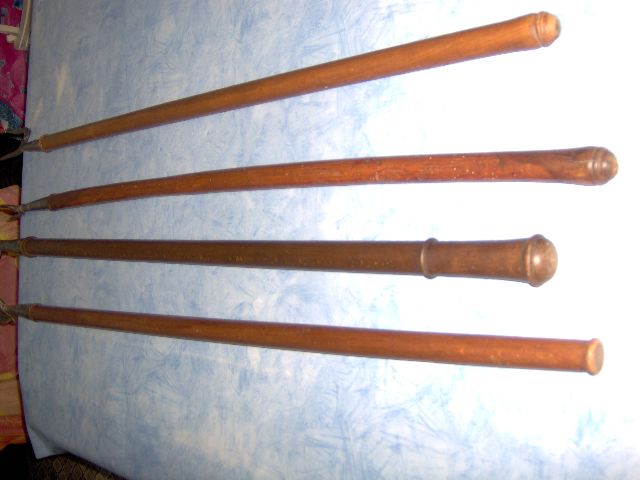

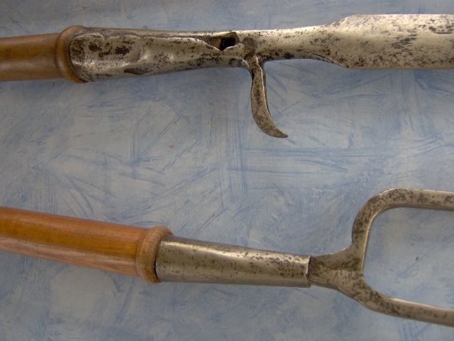

Old 4th June 2012, 05:58 AM   #6
weapons 27
Join Date: Feb 2012

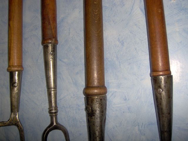

Posts: 462

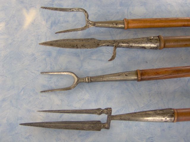

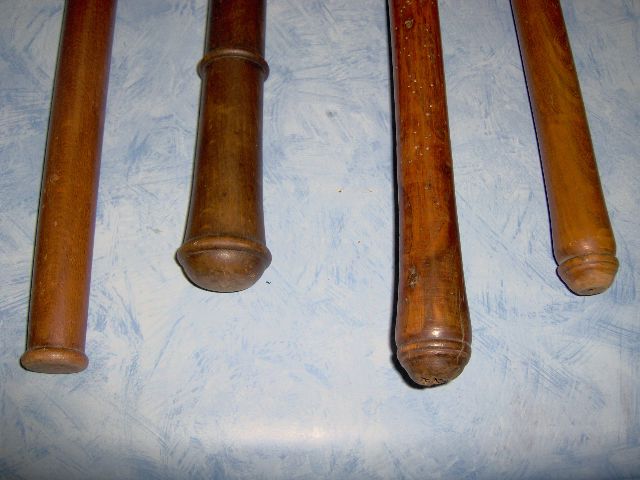

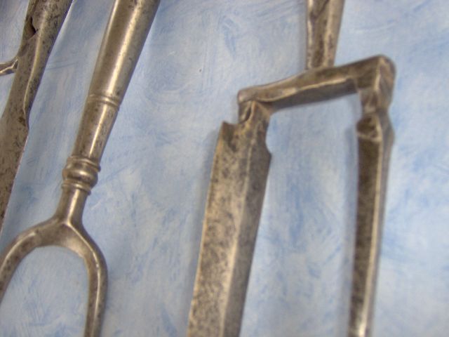

photos of sleeves, I do not know if they are original?

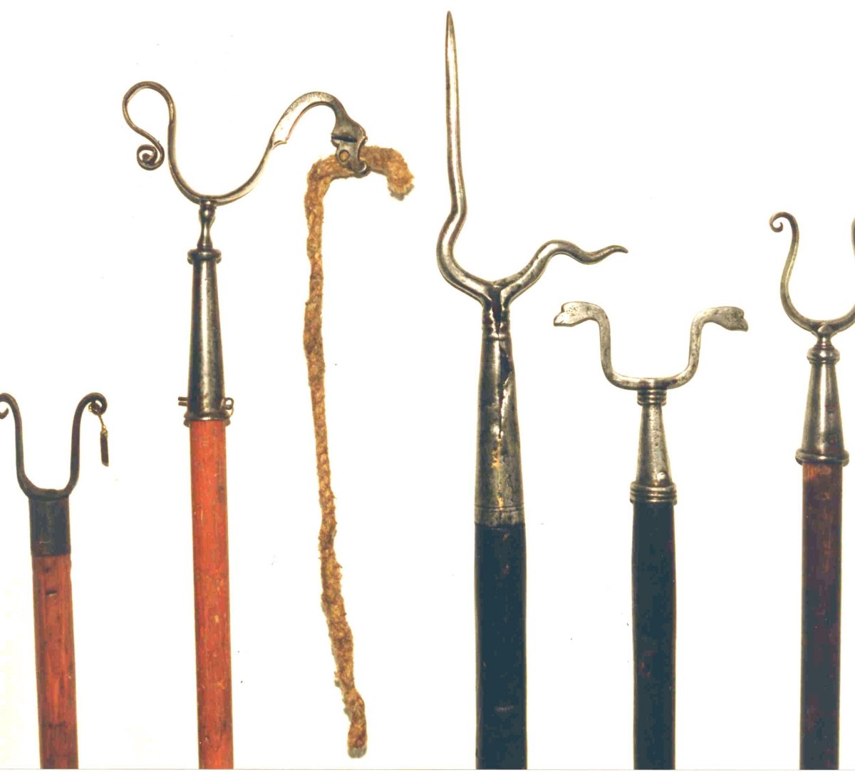

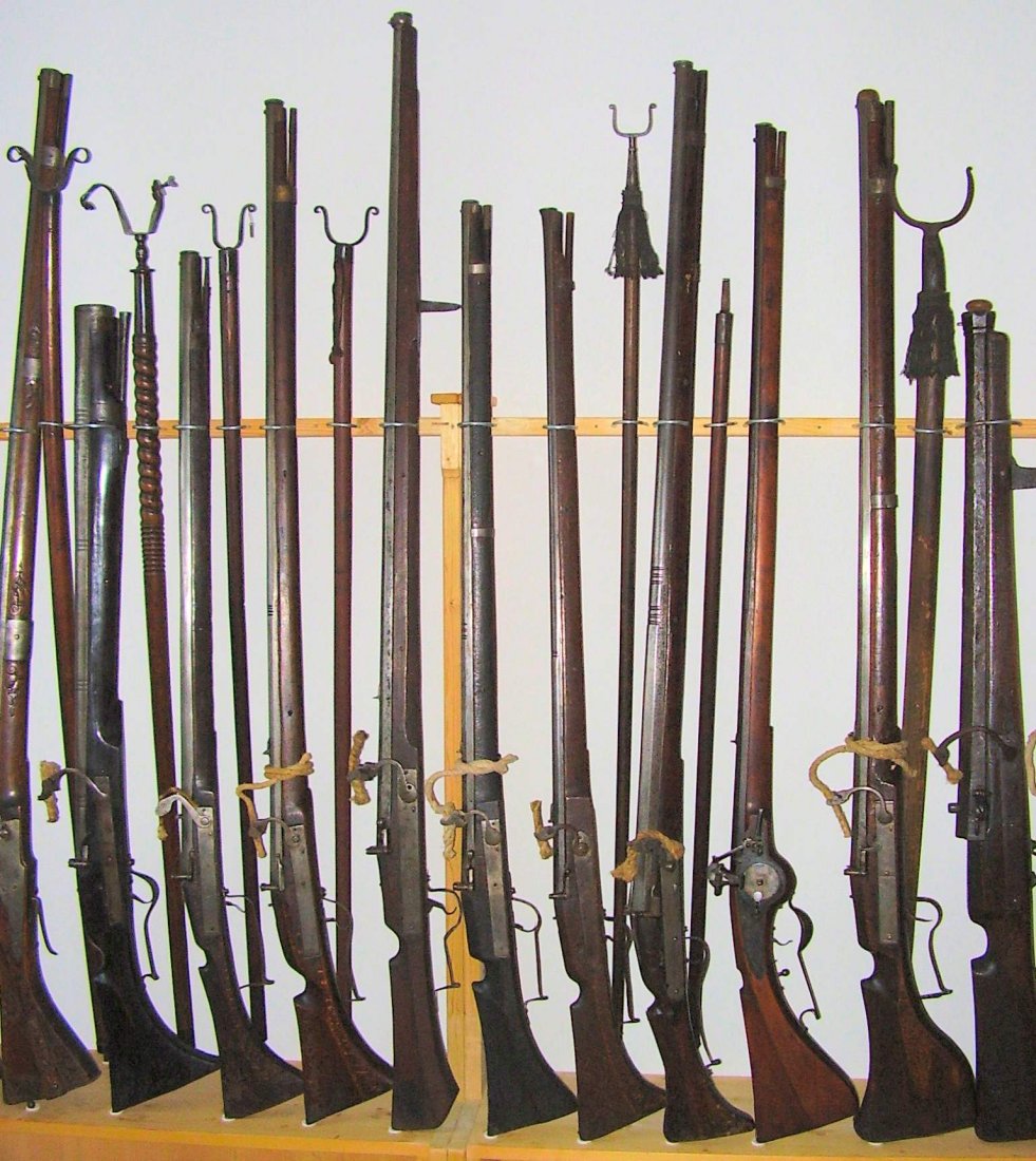

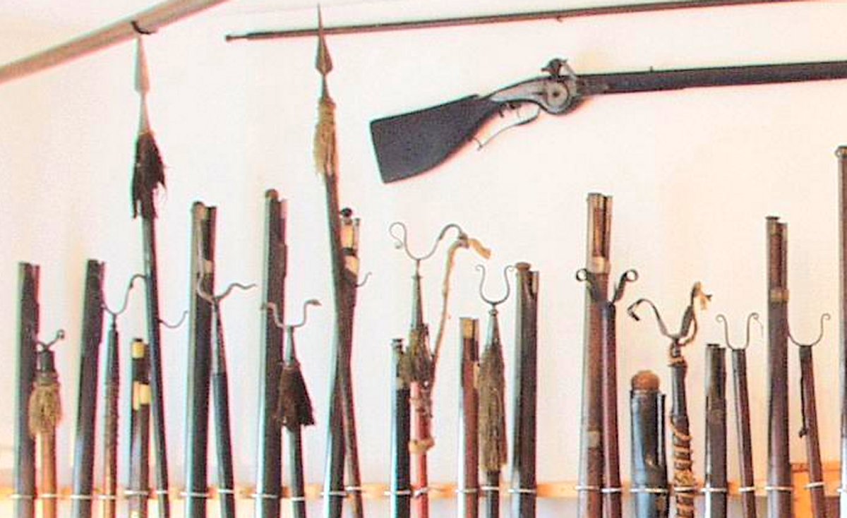

Musket rests, which were in use from the early 16th to the mid-17th c., normally had scrolled upper finials to avoid harm. There were some early types though to feature one spiked end which served as a thrusting weapon.
Attached please find samples of 16th to 17th c. musket rests from my collection, and a piece of period artwork from the inventories of the armories of King Maximilian I, ca. 1507.
m

Old 4th June 2012, 03:16 PM   #9
Matchlock
Matchlock's Avatar
Join Date: Sep 2008
Posts: 4,310
Hi weapons 27,
The lower ends of these hafts are highly unusual in not being equipped with pointed iron shoes and, additionally, are rounded which makes any use both unpractical and unlikely.
The wooden hafts should at least end flat as was the case with pike hafts.
I do not think these items have a European provenance.
Could you give the overall lengths of the pieces?
Michael
Old 4th June 2012, 04:01 PM   #10
Matchlock
Matchlock's Avatar
Join Date: Sep 2008
Posts: 4,310

Old 4th June 2012, 04:24 PM   #11
weapons 27
Join Date: Feb 2012
Posts: 462
hi matchlock
the length is about 1 m 30 a 1 m 45 for the longer

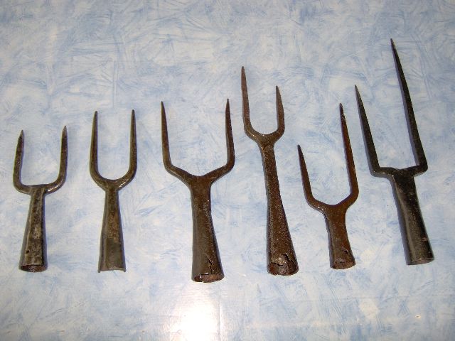

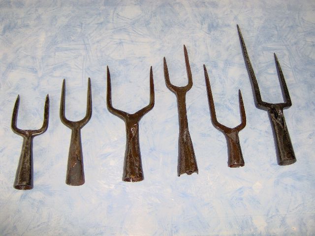

Here are five other Pikes, known in france peaks a wolves, would have been used to repel the attacks of wolves?????

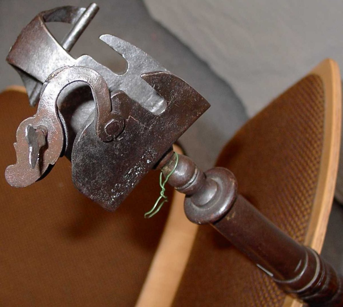

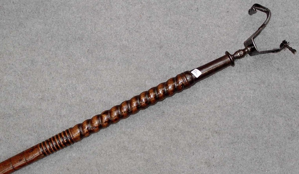

Posts: 4,310

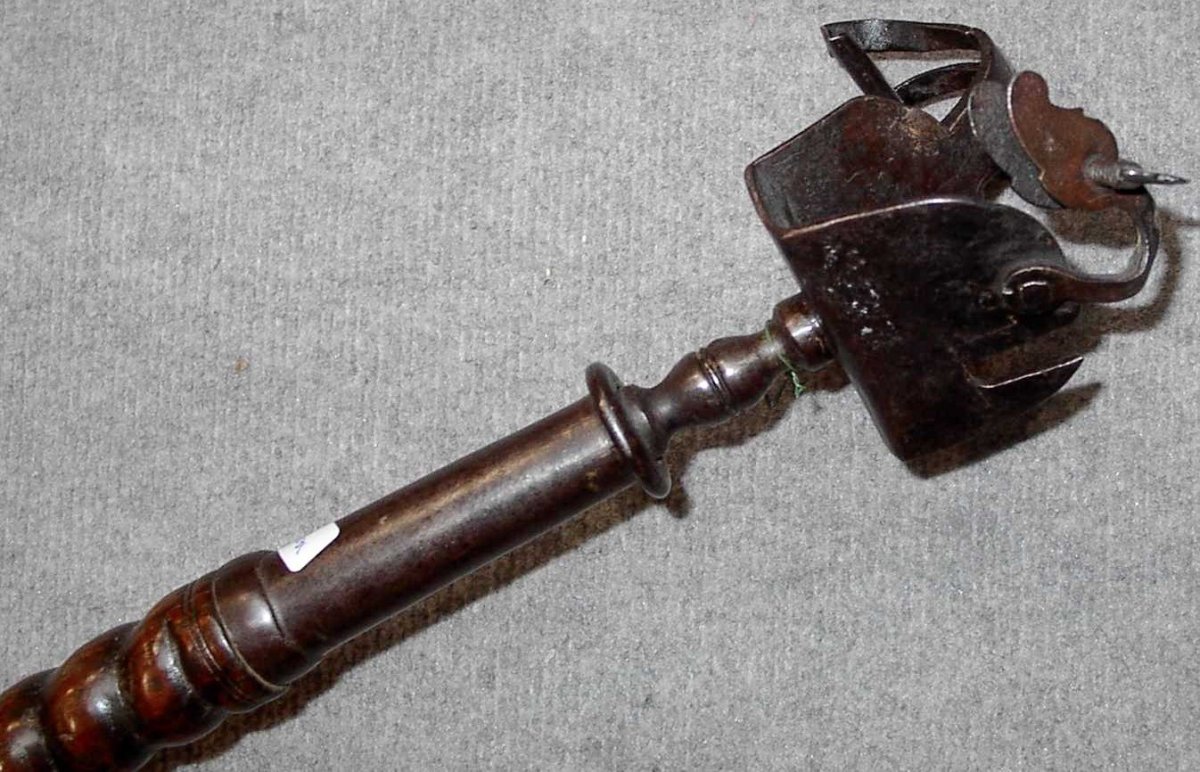

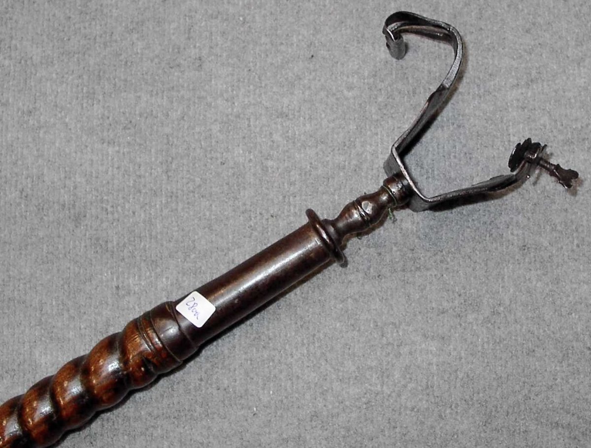

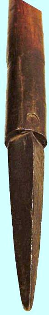

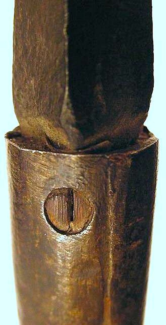

A fine and unusual Swiss musket rest for a heavy matchlock musket, ca. 1600-20, combined with a very rare match holder serpentine corresponding to that of the musket, on its original carved and figured ash-wood haft and fitted with a characteristic pointed iron and copper-soldered shoe.
The iron parts retaining their 'untouched' original blackened surface.
Interestingly enough, the shoe is pierced for a nail which was never there though. Anyway, it fitted perfectly without a nail for 400 years!
Author's collection.
m
That's possible though I rather believe they were used by the peasants to fend off people.

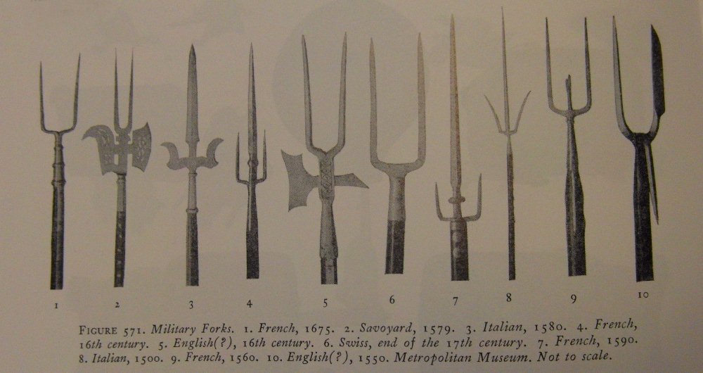

Old 8th July 2012, 08:41 AM   #16
Shimmerxxx
Shimmerxxx's Avatar
Join Date: Jul 2012
Location: Wickford, UK
Posts: 54
Could these be Military Forks?
See figs 1 & 6 on first plate and fig 1 on second.
(This is my first time posting images on this forum, hope I'm doing it right).

Old 8th July 2012, 03:13 PM   #17
weapons 27
Join Date: Feb 2012
Posts: 462
hi shimmer xxx
Thanks for the documents, there is a large resemblance
Old 8th July 2012, 04:39 PM   #18
Matchlock
Matchlock's Avatar
Join Date: Sep 2008
Posts: 4,310
As I pointed out before, these hafted weapons are way too large to be compared to your sort of miniaturized pieces, the rear of the hafts ending round instead of flat or in a pointed iron shoe.
