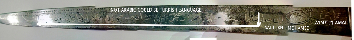

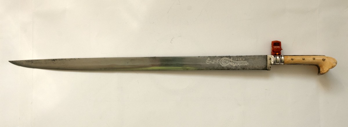

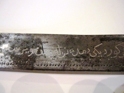

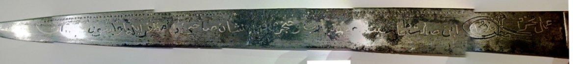

Hi everyone,
I am totally new here, I have read the FAQ and stickies, however please correct me if I mispost.
Amazing site by the way...

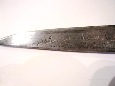

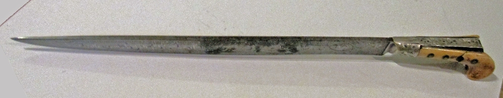

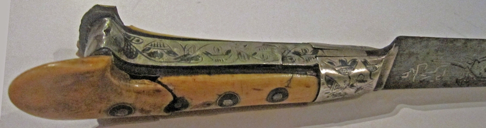

Anyhow, I was wondering if someone might be able to help with a translation on the blade of this knife. The handle makes me think it is Ottoman, but I am far from an expert on the matter, it may be Arabic. Particularily any help on the inscribed name and date would be most appriciated.
The 2 pictures of the entire blade were pieced together in an attempt to have the whole inscription legible and in one piece. I hope it worked alright, it looks piecemeal, but thats the limit of my photo-software knowledge and/or camera skills
I can try and take more pictures if necessary.
Thanks all!
back to reading posts!
-J

Salaams j118, Welcome to the Forum!!
I can only read bits of the script on your Yatagan and note it has a nice swirling Ottoman Tughrah inscribed. Im sure a translation will be forthcoming.

Originally Posted by j118
Hi everyone,
Hi j118
you arrived at the right place, for the right purpose

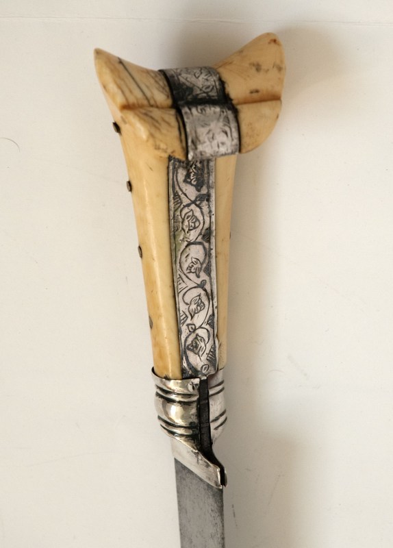

your edged weapons is an yatagan Ottoman, with an handle "ears" or "butterfly"
the script, excepted if Quranic, should be in turkish, especially that there is a tughra
with the tughra, you might expect evaluated the age of your yatagan
http://www.tugra.org/en/tugralar.asp
tomorrow (p.m.), I shall see if is in Turkish, or in Arabic, and I will tell you
all the best

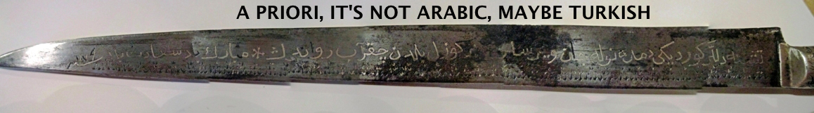

Old 18th November 2011, 12:32 AM   #4
Dom
Dom's Avatar
Join Date: Oct 2005
Posts: 1,142
... here we are
my fears were justified ... all is written in turkish language (a priori)
just a few words emerged in Arabic, but very few
my translator does not know the Turkish, only Arabic language, sorry

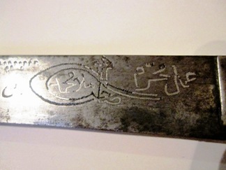

AMAL ASME (?) either "MADE BY ASME" (? because it's an unknown surname for us, translation under reserve ... )
the "tughra":
in his center possible to read "MOHAMED"
but all curves making the "tughra" it's a complement part of the name ... but indecipherable
after the "tughra", we read
"IBN SALT" either "SON OF SALT" (again a surname unknown for us)
then the rest of the sentence, it's not written in arabic
à +
Dom

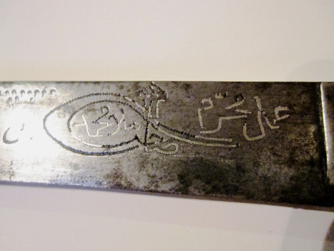

I can post a close up of the Tugrah if it is any help.
Thanks! So far that is far more than I knew before.

Old 19th November 2011, 07:19 PM   #6
Zifir
Zifir's Avatar
Location: Istanbul
Posts: 228
Hi,
the reading of the tuğra is as follows:
Amel-i Muharrem, sahib Molla Muhammed
work of Muharrem, owner Molla Muhammed
The language of the inscription is Turkish, if you can provide partial pictures like the one of tuğra, it will make it much easier for me to read it.
Zifir is offline   Reply With Quote

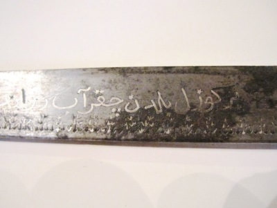

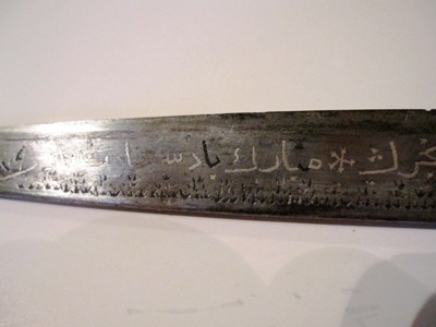

Old 20th November 2011, 11:18 PM   #7
j118
Join Date: Nov 2011
Posts: 6

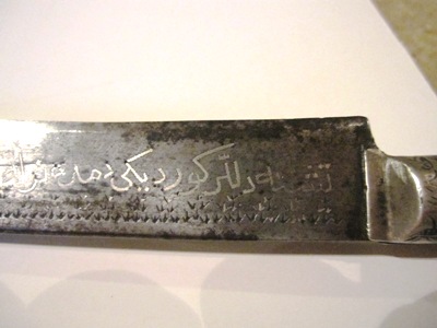

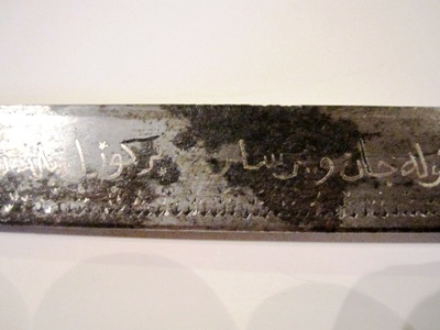

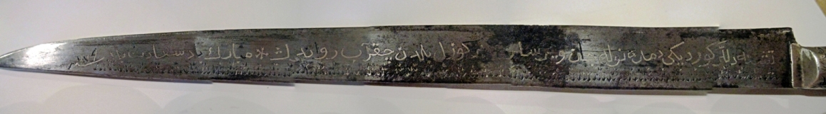

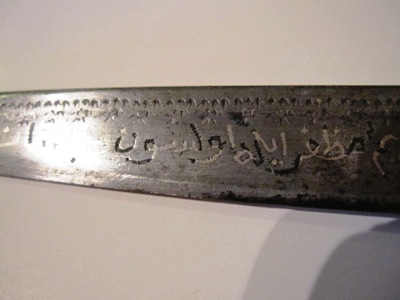

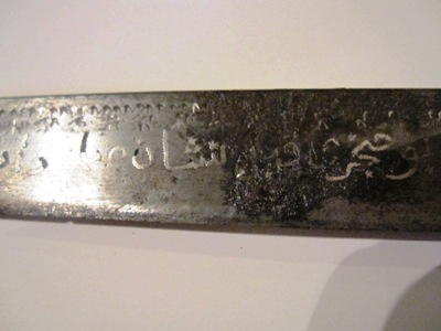

Sure, hope these help!
I little our of order, I think it made the last piece first, but the others should be in order down the blade.
-J
j118 is offline   Reply With Quote

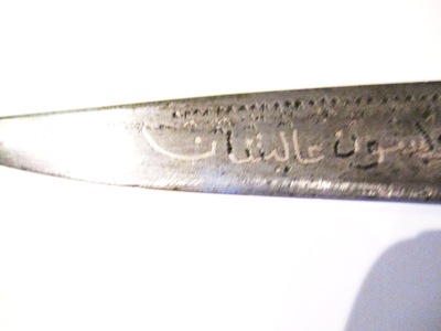

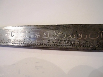

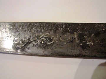

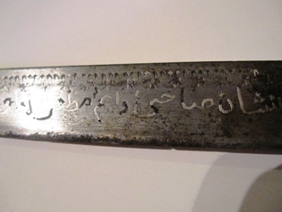

Old 20th November 2011, 11:20 PM   #8
j118
Join Date: Nov 2011
Posts: 6

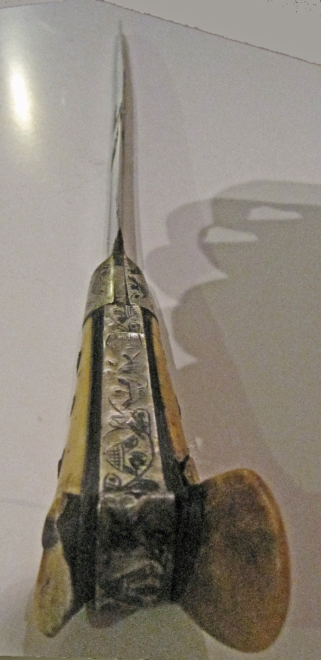

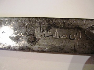

and side 2, same as above...
again, cant seem to get the editor to take them in order, sorry about that.
this one is in the order 6,5,4,3,2,7,1
Old 2nd December 2011, 06:45 PM   #9
Zifir
Zifir's Avatar
Location: Istanbul
Posts: 228
Sorry for responding late to this thread, but the reflections on the blade as well as erased parts made it quite difficult to read it. I only read one side and I am still trying to figure out the other.
To pick up where Dom left:
sine-i 'adaya yarıp bu hançeri kıl nişan
sahibi daim muzaffer eyle olsun alişan
Let this knife be a sign on the bossom of the enemy
Let its owner be glorious and high in fame

Since there is still no answer from the real experts, I will try to play one

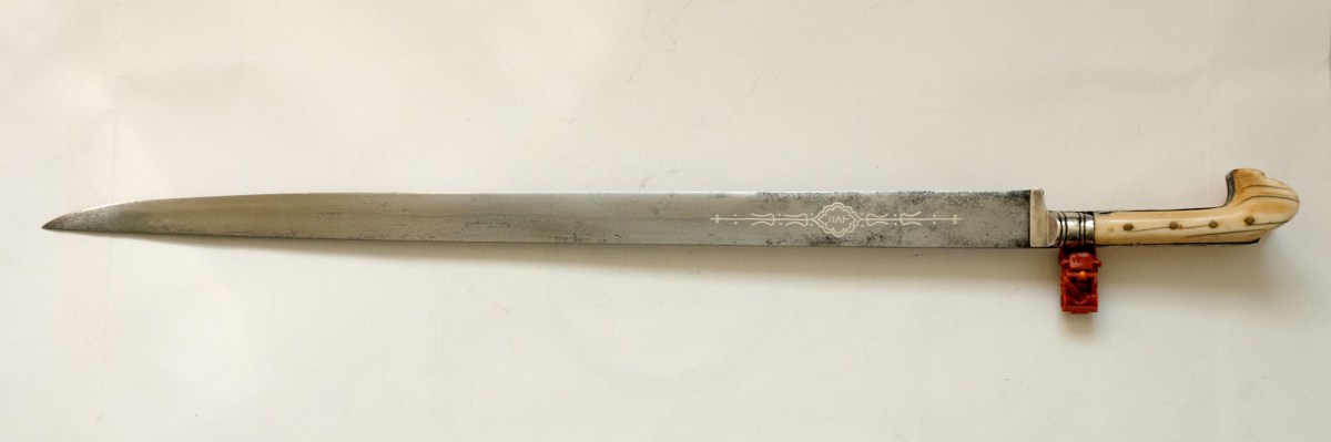

The straight blade, small ears and the niello decoration are typical for the early yataghans from the 18th century. You may find similar examples in the Astvatsaturyn's book.
I have also a similar one, which bears the date 1182 (1768) on the both sides. Please notice a top quality hamon (bright and having a uniform width), which you may expect from a Japanese master smith

Default very similar
Thanks for the comparison, that is very cool.
Yours look very similar to mine, but a couple steps up in quality and condition

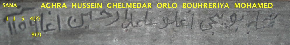

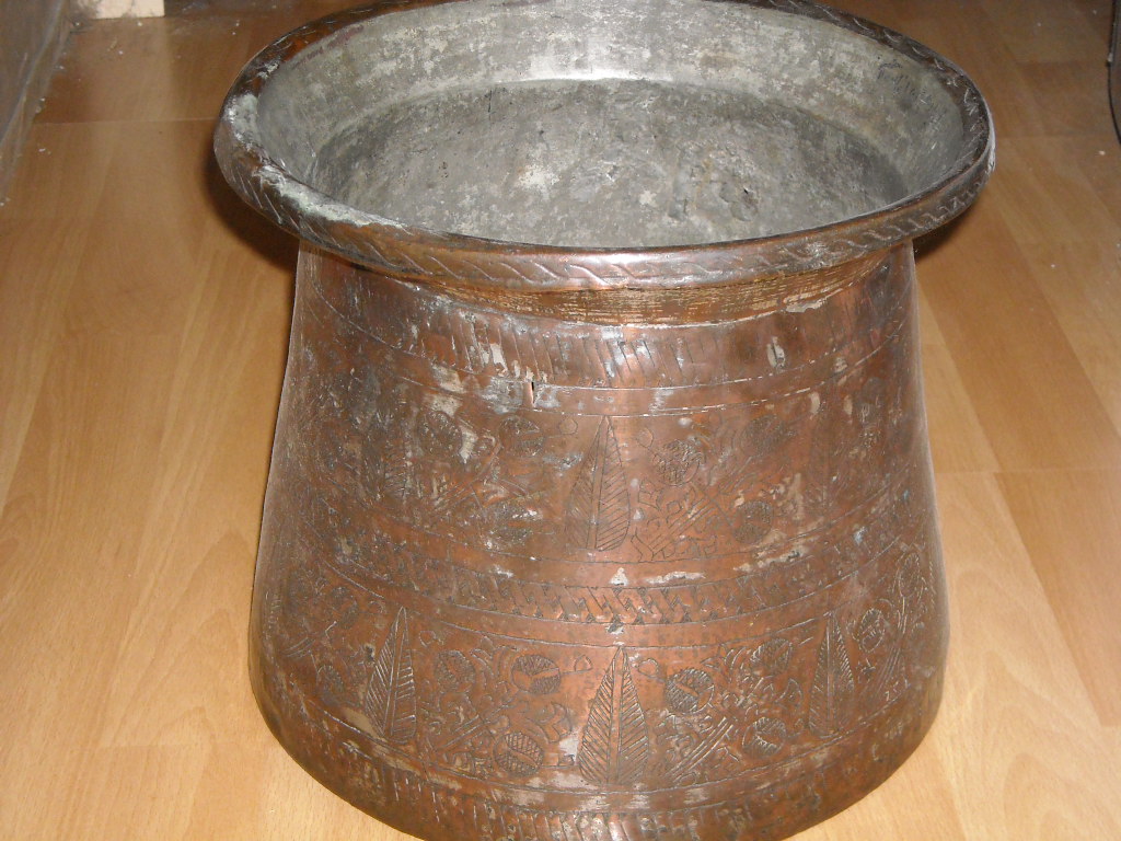

Hi,

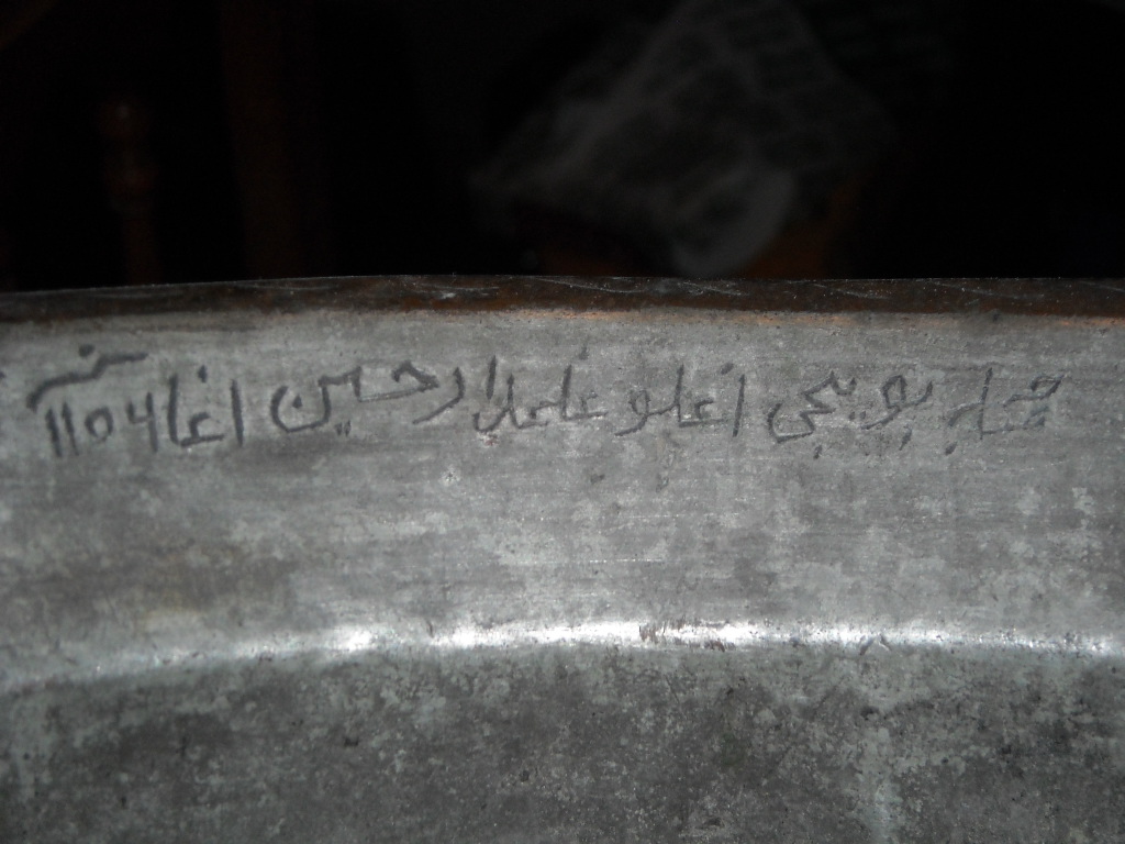

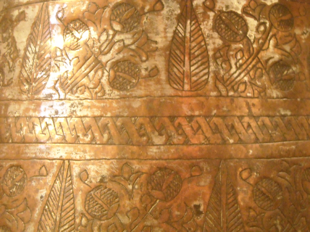

i got an translation request also.
But, well, it is no weapon but a copper pot which came with one last year .
I might understand that the left signs are a date, which should be around 1700. The others i couldnt identify at all.
It also seams that the signs might come from two different persons.
I would make a guess, that it comes from the Turk persian site
Any idea is welcome.
best regards
Dirk
Hi Dirk
It seem that, you are correct ... should be Turkish, at least due to the mention
it's only a name and a military title ... all are Turkish
your feeling that may be, the sentence was done by two writers has a sense
the last part of the name "Hussein" and, the title "Aghra" are lightly different,
but the date it's absolutely strange, as some one, mixed both writing occidental, and Arabic ??
any way, here what we read
SANA either DATE ... then ... 115(4?) either 1741 (?) or 155(9?) either 1745 (?)
MOHAMED BOUHRERIYA ORLO GHELMEDAR HUSSEIN AGHRA
those names have to receive the approbation of Zifir, but I think so that I'm not too far
à +
Dom
