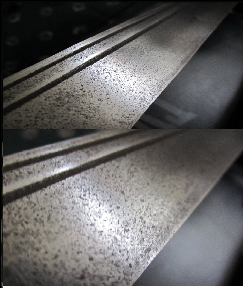

Hey all this is my first topic... I was wondering i have cleaned a Indo Persian Khanda i have.... and this pattern showed , im unsure if it is wootz or just the aging pattana.
any comments? thanks

Hello AkaaliSingh and welcome to the forum. Apparently your pictures didn't come through. You might want to try to upload them again.

Welcome to the forum.
Imho it is a pitted surface caused by the rust. Not patina and wootz neither. Maybe you can show us the whole piece.

Posts: 3,191
All I see is pitting. There is no discernible wootz pattern as far as I can tell.

Welcome,
It would be interesting to view this Khanda as the blade by design is not typical for a Khanda.
Whilst I doubt there is a Wootz pattern to this blade by design, Wootz does not always show and often needs chemical attention to show through old patina.
Gav

Posts: 936
Gav is very correct. The blade needs to be etched (treated with a mild acidic solution) to reveal any pattern. The patina with pitting combination often creates an "illusion" of pattern. This particular blade does not show any. Give it a try, and good luck.

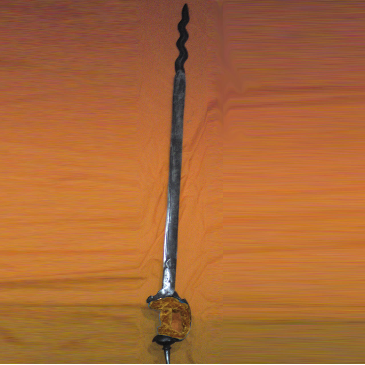

Old 15th February 2011, 08:25 AM   #9
AkaaliSingh
Join Date: Jan 2011
Posts: 31
full image ( the wavey bit is apart of a spear and not apart of the khanda lol) sorry couldn't get a new picture for now.
AkaaliSingh is offline   Reply With Quote
Old 15th February 2011, 01:26 PM   #10
Gavin Nugent
Gavin Nugent's Avatar
Posts: 2,818
Default elbow grease
Originally Posted by AkaaliSingh
thanks for the replys! that what i thought aswel, is their any way of geting rid of the pitting other than sanding?
Nothing but good old fashioned elbow grease will get rid of pitting, but really, don't worry about it, it is after all an old warrior and and an old warrior need to show his age gracefully.
