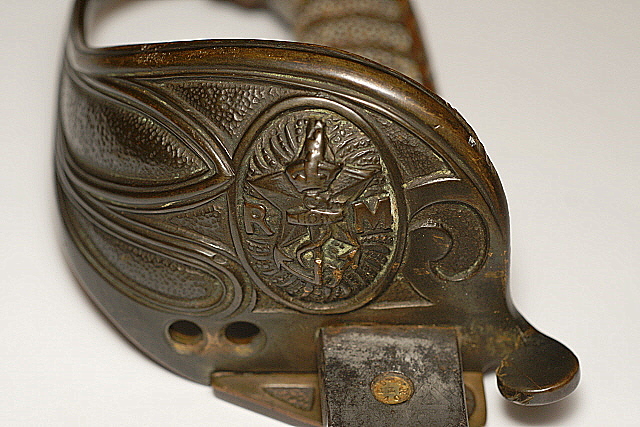

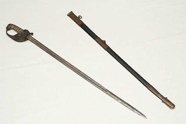

Dear colleagues. I have bought Royal Indian Marine sword. But I have some questions:
On an edge and a hilt there is no letter I (India) and it confuses me.
I know that Royal Indian Marine have been formed in 1892. But absence of a letter on drives me on thought that is any earlier Indian fleet (till 1892).
If someone has more exact information write.
The information on a brand on an edge at me is, it Edward Thurkle, 5 Denmark St., Soho (1876-1899).
I look forward to hearing. Respect, Alexander.

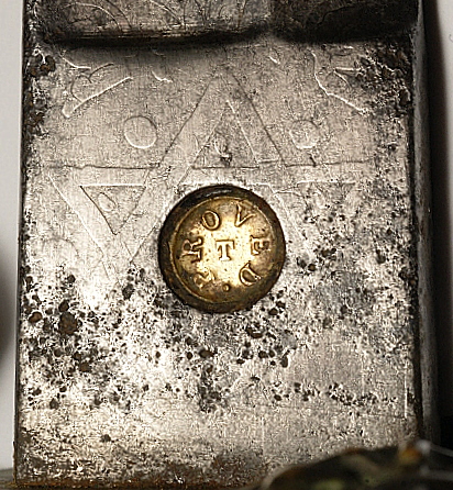

Can you post a close-up of the proof slug, i.e. the brass disc, that is set into the ricasso.

Hi Norman,
I send a photo the ricasso.
Regards, Alexander.

This really is an attractive sword, and I like the rather bold etching and the heavy bronzed look of the hilt. This seems to correspond to the M1827 naval officers style hilt for the British Navy, which remains in use as I understand.

As you note, Edward Thurkle was shown as maker 1876-1899, thus the sword must be presumed of that period. The proof mark is correct with T within the word PROVED. The makers name panel etched seems correct also.
I join you in concerns over the missing letter in the initials, and thought I might check into swords used by the Royal Marines, since the two initials with fouled anchor suggest that possibility.

What is puzzling with the RM initials is that if the Royal Indian Marines took that name in 1892, though Thurkle was making swords since 1876, he would not have used such initials since they were Her Majestys Indian Marines.
In 1896, four years later, the sheet steel swords were introduced for the Royal Marines, so the question is would the Royal Marines have used the naval sword prior to that? and if they did, this would be a Royal Marines sword rather than Royal Indian Marines.

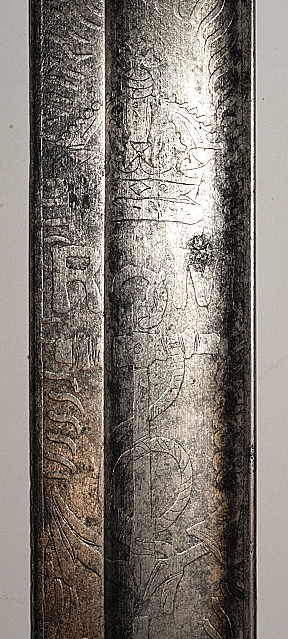

While the blade seems correctly marked, the hilt seems quite rough, with the crown either worn or poorly cast. I am unclear whether there is a royal cypher on the blade, which should be VRI (Victoria Regina India) as appears on the Royal Marines sword by Thurkle in the National Maritime Museum.

I am not sure if I am seeing things or not, but on the handguard badge , where the anchor shaft meets the flukes, is not the shaft thickened to form the letter 'I' ? Thus making R I M .
