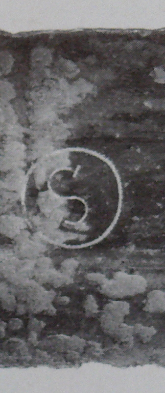

Sottopongo agli amici del forum questa spada con la lama rotta.
Ha due marchi in argento, uno per lato.
Il primo è una croce con bracci uguali. Secondo Musciarelli, nel suo libro "dizionario delle armi", è il marchio di uno spadaio svizzero del 13° secolo (vedi foto - marchio n° 39).
Il secondo, una "S" in un cerchio è per me sconosciuto.
Qualcuno è in grado di aiutarmi ad identificarlo?

This seems like an Oakeshott Xa, brazil nut pommel mid 10th into late 11th century. The brazil nut more common in Central and Eastern Europe.
While Gyngell and clearly others (as noted here by Cesare) have associated this 'cross potent' (kruckenkruez, crutch cross) with suggestion of a Swiss maker c.1200, this cross was in my opinion, not a makers mark, nor restricted to Switzerland nor that time period.
These crosses were applied to sword blades, often with inscriptions, and typically invocations intended to offer talismanic protection. The practice of placing crosses on sword blades and scabbards dates much farther back.
The 'S' is another thing entirely, and may indeed be a production related mark, while quite possibly another religiously associated symbolic. The use of silver seems quite unusual, as usually these marks were inlain with iron or latten, and as noted the condition of the silver does not seem commensurate with the well aged sword overall. Perhaps the existing marks were inlaid with silver later?

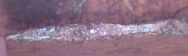

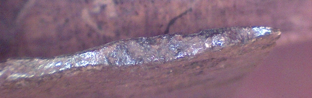

Originally Posted by Henk
Cesare,
Is the tip really broken? If so, some good close ups of the break could give some more information. Or is the tip not broken but is this an executioner sword?
Ecco le foto al microscopio digitale. è realmente una frattura avvenuta all'epoca. Infatti, le superfici di frattura hanno lo stesso livello di corrosione della lama.
Here are the photos to digital microscope. Is really a fracture and occurred at the time. In fact, the fracture surfaces have the same level of corrosion of the blade.
Cesare is offline   Reply With Quote

HI Cesare,
it can be classified as an Oakeshott type XI (Jim,sometimes swords can classified in more then one type however type X is broader and has a wide and shallow fuller, type XI is more valid here ) and it can be dated 1050-1150.
This was a long sword because with this type 2/3 of the blade has parallel edges and approx. 1/4 is missing (blade length around 90cm would be proper for this sword)
the inlaid mark in silver looks authentic most of the inlays in type XI swords are in silver!
Oakeshott published in the sword in the age of chivalry about this type of s-mark found in type XI swords.
quote"most common are tiny silver or latten inlays OSO or SOS; nearly as common is an S enclosed within an O unquote" (pag142 )
the meaning of SOS is probably Sancta o (maria) Sancta. (oakeshott roms)
The same mark however in brass is on a sword published in records of the medieval sword XIIa.4 page 93!
The cross potent has been widely used and has nothing to do with Switzerland.
the pommel is a nice and bulky Brazil nut and of a oakeshott type B or Petersen X.
it seems mostly found on swords which can be dated between 1050-1150.
(cf Oakeshott pag 93 tsitaoc)

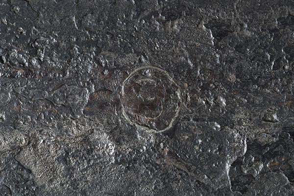

Ciao Cesare,
qui un dettaglio di una S simile ma in più cattive condizioni , da una spada del periodo della I crociata circa 1100 della Germania del sud.
Saluti
Hi at all ,
here a photo of a similar S silver mark on a I° Crusader sword type dated to 1100 circa . It is south german .
BerberDagger is offline   Reply With Quote

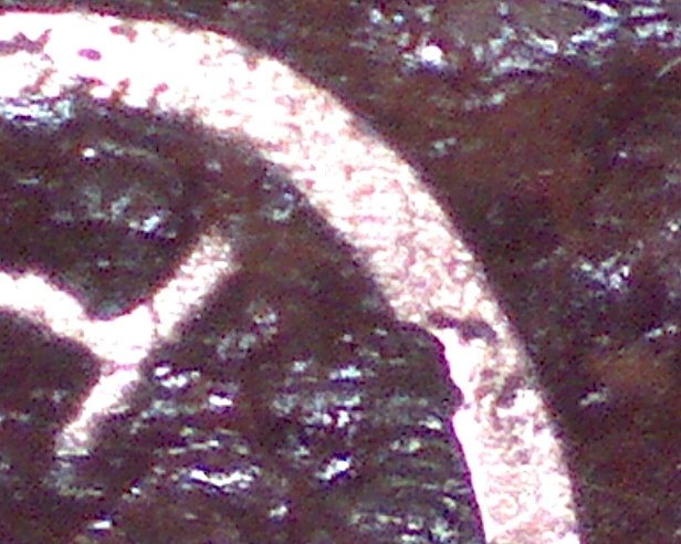

Cesare,
Can you tell if the inlays are made from twisted strips, if you look closely can you see diagonal lines in the inlay?
best,

Cesare
Join Date: Oct 2010
Posts: 22
Cesare,
best,
Cesare,
Si può sapere se gli intarsi sono realizzati da nastri intrecciati, se si guarda attentamente si può vedere linee diagonali nel intarsio?
meglio,
E' difficile da dire. Il restauro potrebbe aver alterato la superficie dell'agemina. Ecco una foto fatta col microscopio digitale a circa 100 ingrandimenti.
it's hard to say. The restoration may have altered the surface of the inlay. Here is a photo taken with a digital microscope at about 100 magnifications.

Hi,
it is difficult to see, but looks like the flat wide ring is made out of a (twisted) strip, this is an early inlay technique the twisted stripes were hammered in the slots when the blade was stil hot however under melting point of 960C.
in the case of silver.(Viking swords do have the same technique of inlays with iron strips.)
A nice detail is that the point is broken off and not rotten away! also the dark black goethite patina points at a conservation in water.
I think this is a water find.?!?
The "handwriting" of the S can be found on same type XI swords dating all around 1100.The sword is much older then the fortress and difficult to link to any battle.
regards fom holland
