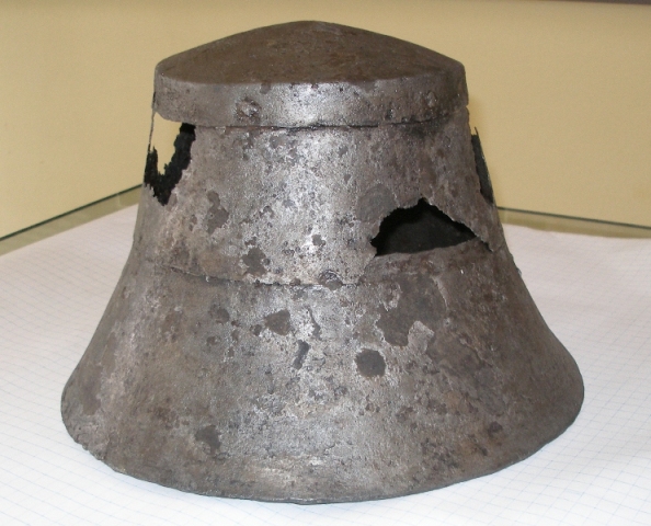

What about this helmet?
Here is the description and the measures.
Period: 13th century
Perhaps from teutonic area

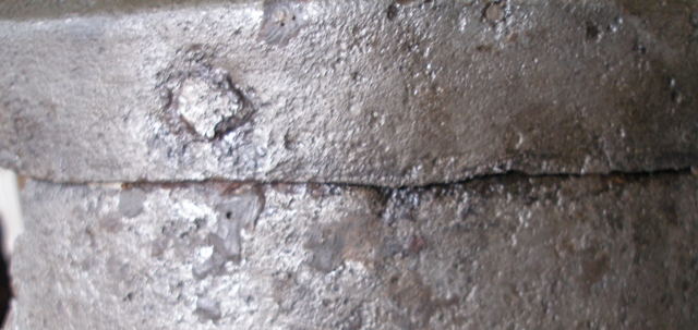

It's made with three elements. Two bands of bent sheet metal ring and a bell-shaped upper dome-shaped cone with edges folded down to form a cylinder. The three elements are joined together with rivets of iron loops, clinched so as not to create external protrusions.
The upper cap surmounts 9 to 12 mm for the upper edge of the intermediate band. The two pieces are combined with 6 rivets. The distances between the rivets are not regular.
The lower edge of the intermediate band for about 16 mm overlaps the upper edge of the lower band. These two pieces are joined together by 8 rivets. Even for these rivets are not regular distances between each other
The ends of both bands overlaps and are fixed with rivets.
All edges of the joint are shaped so that the outer surface of the helmet has no discontinuities or protrusions.

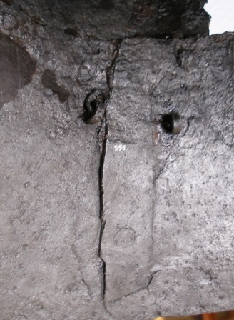

Within the lower band, about 84 mm from the edge, there were 20 rings of iron, placed at irregular distances from each other. Two of them are still together a chain mail, to prove that at these rings was fixed a camaglio.
The hat-in-arms (?) of the Museum Fioroni has’nt slits for eyes because, for the low point of connection with the camaglio, the bottom edge of the helmet is placed above the eyebrows.
Measures
Total height 267 mm
Base diameter 344 mm
Top
Base diameter 193 mm approximately
top diameter About 185 mm
Height of cylindrical portion About 25 mm
Summit of cone 20 mm from the base.
Intermediate band
Base diameter 236 mm approximately
External height: 95 mm approx
Lower band
Base diameter 344 mm approximately
External Height: 127 mm approximately
Positioning the inner rings 84 mm from lower edge

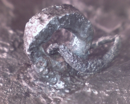

Fixing ring for camaglio (2)
Internal diameter 4 mm
Outer diameter 9.3 mm
Thickness 4.5 mm
NOTES
1) The construction technique - forged elements, joined together with rivets –(not welded) is similar to that adopted in the contemporary Pot Helmets.
2) The 20 rings were fixed to camaglio inserted in through holes in the metal band and secured it with the system of the rivet replied. Three of them are intact. 9 of them has only the rivet securing at the metal band. 8 of them are completely missing; There mounting hole was inappropriately closed with a plastic material during the restoration.
Condition.
The outer surfaces, highly corroded, have been properly and thoroughly deoxidized. The use of excessively abrasive tools is evident only on the protruding rivets. Less responsible for the restoration of the interior surfaces.
All surfaces are protected with acrylic film Such protection is still effective and requires no rework.
The restoration has been pushed to the reconstruction of some missing parts with plastic material.
Best Regards
Cesare

Hi cesare,
this is a kettle helmet or "chapel de fer", very effective helmet for the foot soldier which could be produced against low costs!
There are kettle helmets known between 1200-1500. Dating however is very difficult.I presume 1250-1350

Hi there,
Before calling this any kind of 'helmet' at all I plead for thinking both logically and analytically.
If this were a helmet:
- Where is the slit for the eyes?
- Where are the rivets (holes) for the wadding and the hauberk?
- Where are the breathing holes?
- The whole thing is of extremely thin iron - how could it possibly have stood a blow by a sword or mace?!
Remember, its height is 26.7 cm. Just imagine putting it on the head, with the wadding and hauberk beneath - how could anyone possibly see and breathe? The illustrative source Cornelis posted clearly shows a much lower type of helmet leaving the sight free.

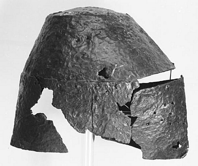

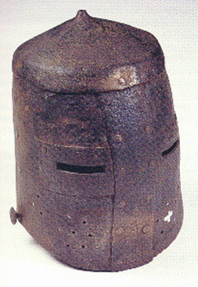

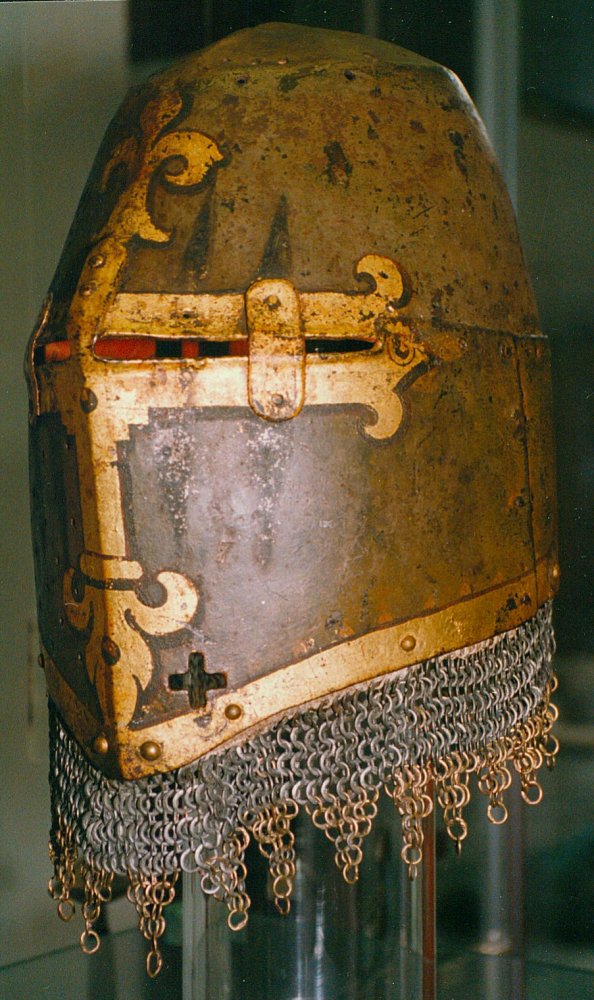

In the following I attach a broad selection of helmets, from top to bottom, six of ca. 1250, five of ca. 1300 (from the Codex Manesse), two original Topfhelme (pot helmets) of ca. 1300, and Gothic helmets of ca. 1350 (Germanic National Museum Nuremberg), two of ca. 1410 and one of ca. 1440. Please closely compare these on the basis of my arguments.
I have come to the conclusion that whatever this item may have been, some kind of kitchen gadget? or anything, in no case it ever was a helmet. At best, the upper half might be the rest of a helmet.
Please post contradictory sources, though!

(cut).
Ovviamente è quello che noi italiani chiamiamo un "cappello d'arme".
Gli anelli di fissaggio al camaglio lo provano senza dubbio,
Essi sono posizionati a soli 84 mm dal bordo inferiore, quindi, il bordo del cappello si doveva posizionare poco sopra le sopraccila, rendendo inutile le aperture per gli occhi.
Secondo gli esperti italiani è un particolare cappello usato dalla fanteria durante gli assedi. Infatti la sua forma non è propriamente adatta al combattimento, ma è adatta a deviare gli oggetti lanciati giù dalle mura della fortezza,
Cappelli di ferro di questa forma sono molto rari. Pare ne esistano solo 2 o 3 esemplari, oltre a quello del museo Fioroni
Carissimo Michael. Ti ringrazio per le stupende miniature. Sono sempre preziosi ed attendibili documenti.
Un caro saluto a tutti
Cesare
Obviously in Italy we call it "Cappello d'armi" In english "Kettle Hat" ad so....
Retaining rings to camaglio, prove it without a doubt,
They are located just 84 mm from the bottom edge, then the edge of the hat was placed just above the eyebrow, So, openings for the eyes are
unnecessary
According to Italian experts, it is a special hat used by the infantry during sieges. In fact its shape is not really suitable for combat, but is designed to deflect objects thrown down the walls of the fortress,
Hats of iron in this form are very rare. It seems there are only 2 or 3 pieces, in addition to the museum Fioroni
Dear Michael. Thank you for the wonderful miniatures. Are always valuable and reliable documents.

Thank you, Cesare,
Again: comparable images of similar objects and sources of illustration would help a lot!
As to your point concerning the shape of the brim deflecting objects from above: I am afraid the actual angle would just direct such objects on the shoulder of the poor guy. Please confer the wider angles of the items I posted.
And: where were the hauberk and wadding fixed? The single existing loop is absolutely insufficient.
Any definite replies to my points in question?!
How thick is the avarage iron?
Michael

More 12th-13.th c. knightly helmets in original sources - all either low enough to leave the eyes uncovered, and with riveted hauberks, or with definite eye slits as well as breathing holes!
None of all helmets found in historical illustrations comes in the least close to yours, sorry.
I am still awaiting your precise answers to my queries though, as well as some counter evidence.
m

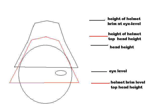

I have a few observations....
The dimensions and the shape of this helmet do not make sense, to me.
The average human head is around 26cms 'high', the eyes are approx. mid way ...so approx. 13cms below the crown (of the head).
If the lower rim is set level with eye level ...the top of the helmet would be around 13cms higher than the top of the head (nearly 5") ...that seems alot of padding. Plus the fact with a helmet set so high on the head it would be very 'unstable'....especially to a side-ways strike.
If the helmet is placed in a more 'stable' position, closer to the top of the head....the wearer is unable to see forwards....requiring eye-holes .
It is suggested that the helmet was used in siege situations to protect from thrown missiles from above....to deflect these better a dome shape would be more effective, and the 'flared' lower sections made wider....
or am I missing something
Regards David

I do not understand why there is so much criticism and suspicion on the sizes of this helmet, it corresponds to what one would expect from a kettle hat, and corresponds also nexactly to the dimensions of a 16thC cabaset (also just above the eye line.)
If you're looking for more convincing evidence, make a cardboard hat and try it yourself.
best regards

No eye slit.
CORNELIS:Not needed because the hat stops above the eyeline.
No breathing holes.
CORENELIS:for what purpose? it is only 265mm high (Same hight as an Schuetzenhaube), you can breath freely.
No lining rivets.
CORNELIS:as is the case with a lot of early medieval helmets, the padding was on the head of the wearer!
No sufficing thickness of iron.
CORNELIS:I need the thickness and differences in thickness for saying something meaningful.
the total weight will also help.
cesare can-maybe post something about this.
NO HELMET. CORNELIS:you're right it is not a helmet, but a 13 th century hat if I may judge
Cornelis, instead of creating new theories, could you please answer my queries step by step? CORNELIS: of course
Michael
Hi Michael,
it is not a new theory, but the sizes seem to me more than acceptable for a kettle hat. Definitely not too large so that the eyes are closed, you can not compare this course with a great helmet because a much larger diameter in its center.
If I find some time I will try to make a paper dummy based on the specified dimensions.
Best regards
