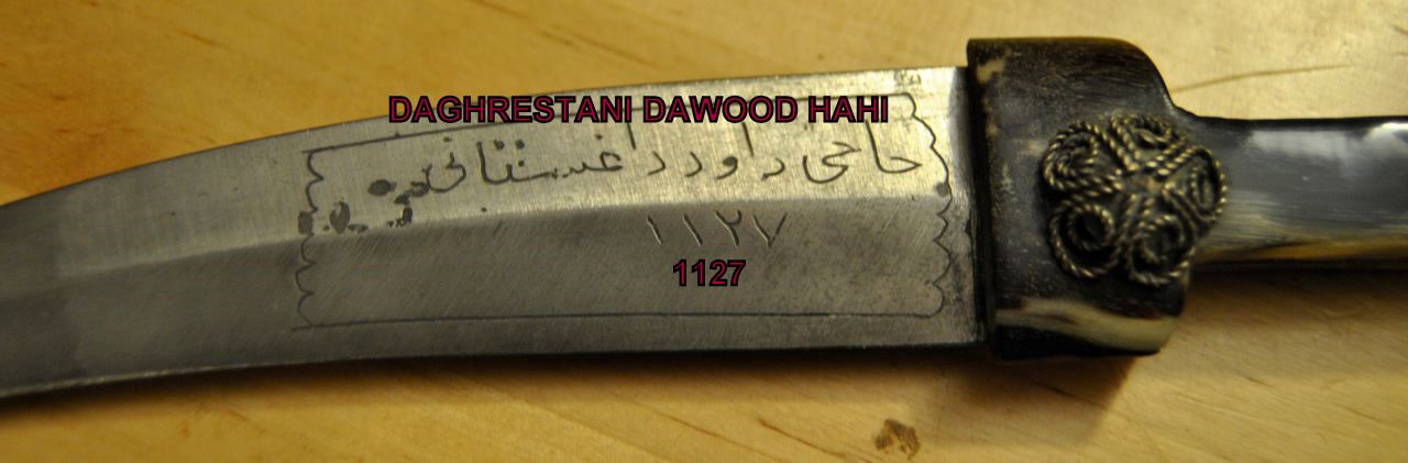

Hello Everybody,
Last week end I bought ( 3€ - 3,9$) this dagger, when I see the end of its scabbard with a fish head monster , I think its original of balkan and its not very old and possible a tourist piece , but for the price its not important,If someone can help me and translate it ?
Thank in advance
Eric

Lovely dagger! The date is 1127 which I think translates as 1715.
I wouldn't have said it looks that old from first glance. So perhaps some other significance to the date?
Edit: sorry can't help with the main inscription. Hell of a bargain though!

Well, this would be Ottoman, possibly Kurdish(?). IF a tourist piece, it is a good one.

"ericlaude" fortunately you didn't spent a lot of money
any way, the knife looks great
now, to have a precise idea about your knife,
you will have to analyze since when,
the word "Daghestan" appear in history
the translation for the blade inscription
will give you an explanation
HAHI DAWOOD DAGHRESTANI either HAHI DAWOOD (the) DAGHRESTAN (man)
1127 either 1714
we have just a name, and a date
now hope to you, to complete the story for this knife
to help you, I look for when the first mention about "Daghestan"

do not seems appear before the 19th century ... in that case the date of 1714
congratulations and regards
