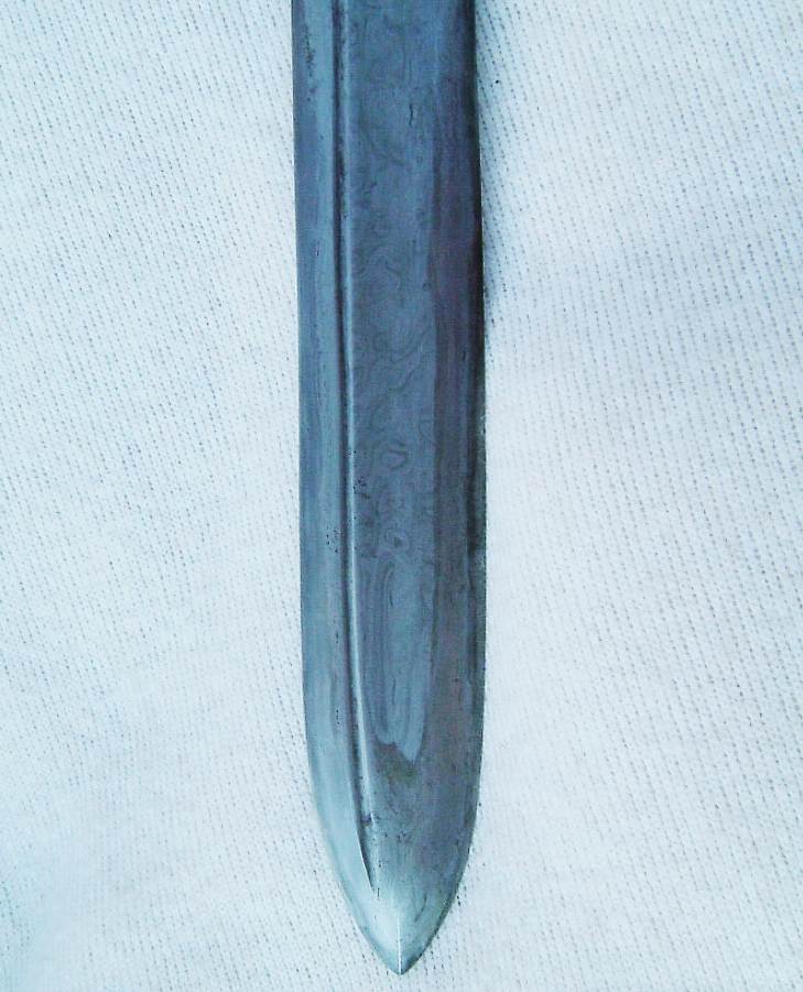

Which brings us to a crux (IMO) .
What are we to make of this ?
This Kris is how old ?
(It has been polished by Philip)
What class ?
Dressed as a combat blade, IMO .
Fancy, or functional ?
Is this pamor as known in the Indonesian/Malay sense ??

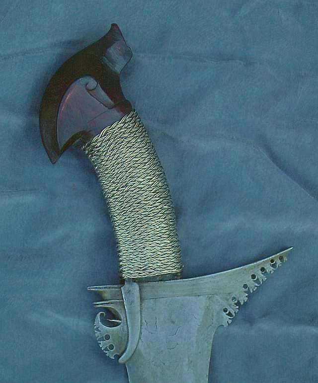

I agree that this particular kris is probably earlier and rehilted at a later date by I would think some one or a family who did not have the same means as earlier in their history. Why rehilt?
1. Damage to the original hilt?
2. Need for the family later to sell off the expensive materials and replace with lesser?
In most cases the family would want to keep the blade since it has a spirit of it's own - the dress is of somewhat lesser value spiritually (though not to the same extent as the Indonesians).
These are my thoughts on this piece.

Rick, I seem to recall reading somewhere that one of the major indicators of an early blade was its size:- smaller blades, sometimes about the same as a Bali blade size were supposedly older.
As to pamor, this blade looks like it has a steel core.
If this is so, I would certainly be happy in calling the pattern welded outer skin of the blade "pamor".
Even if it did not have a core, I feel that the name "pamor" is still OK, as the word has the idea of "mix" inherent in it, and this material is definitely mixed.

I agree with Jose on this. It would appear to be a re-hilt. But I suspect not very recent. The silver wire weave is beautiful. The piece is top-notch, Rick you been holding out on us? Why I think the hilt job is older. There seems to be a definite scarcity of anyone who can do the weave.

One might posit that the changes occurred during the centuries after the Spanish arrived .
As for that blade, being the guy who can hold it; IMO it's contemporary to the dress .
The blade was varnished .
Alan, why do you think the twists are laid on a plain core ?
I thought the edge was inserted .
I am no metallurgist nor smith I freely admit .

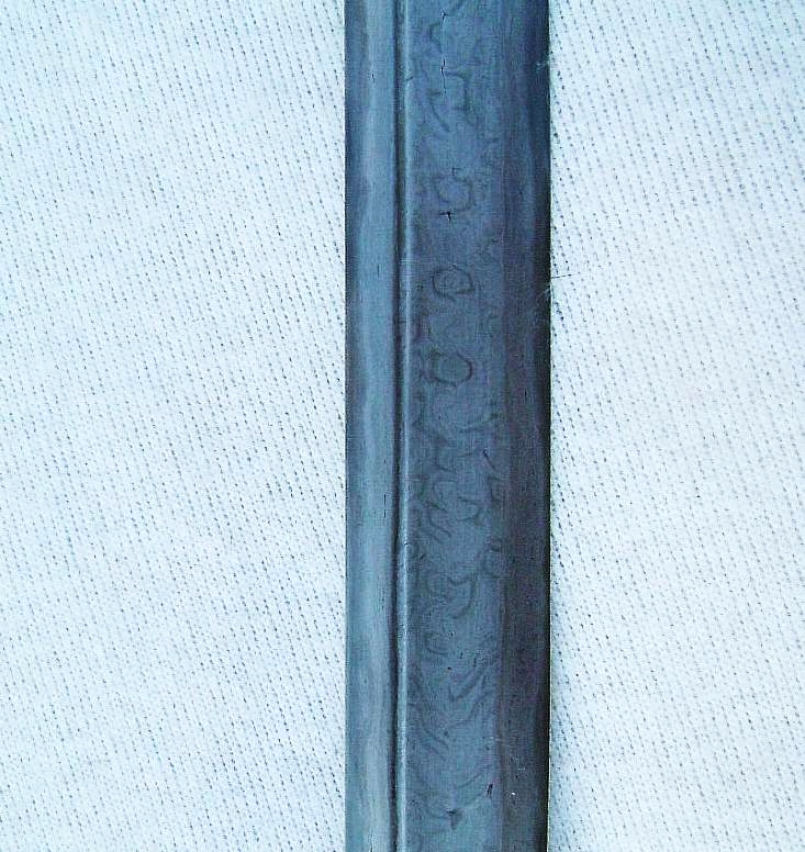

I think your kris is turn of the century (or late 19th c.) and would think that the pommel is possibly original (maybe there never was a ferrule or it went missing). Seems like a datu working piece to me - clearly showing status but not too fancy to get in the way...
Obviously, the smith tried to obtain the typical twistcore pattern but the layers appear a bit blurred and distorted; not top-notch craftmanship but certainly better than what almost all of us would be able to accomplish with traditional bladesmith equipment!
It doesn't make sense to insert an edge for a double-edged blade and even most/many single-edged Indonesian blades seem to be made of 3 sandwiched layers (pamor/steel core/pamor): Usually you can make out the steel core for the edge along the spine, too.
I have yet to see a laminated Moro kris blade which hasn't been done in such a sandwich (San Mai) way; same-o with traditional keris blades (noting the more recent, non-functional exceptions without any steel core).

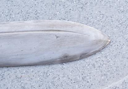

Rick, from the photo I can't tell if the steel edges are formed by a piece of steel running all the way through, or by edges being welded in. Both methods are used in keris construction in the Indonesian produced blades.
Where an edge is welded in, rather than provided by use of the sandwich method, the pamor material and the edge material are brought together as two "V"'s, and then welded.
Let me try to be a little more precise:-
this blade appears to have edges of steel that protrude from material that has been manipulated by twisting; I would be happy to call the manipulated material pamor.
There is an artifact on one side of the point that suggests this; a small Y shaped cold shut .
Old 29th May 2010, 12:30 AM   #18
Posts: 7,256
Yeah, could be indicative, but I've never been able to tell what method was used in a blade that was in good condition. When blades are in very poor condition you can sometimes tell, mostly by being able to see into the sorsoran.
Old 29th May 2010, 12:40 AM   #19

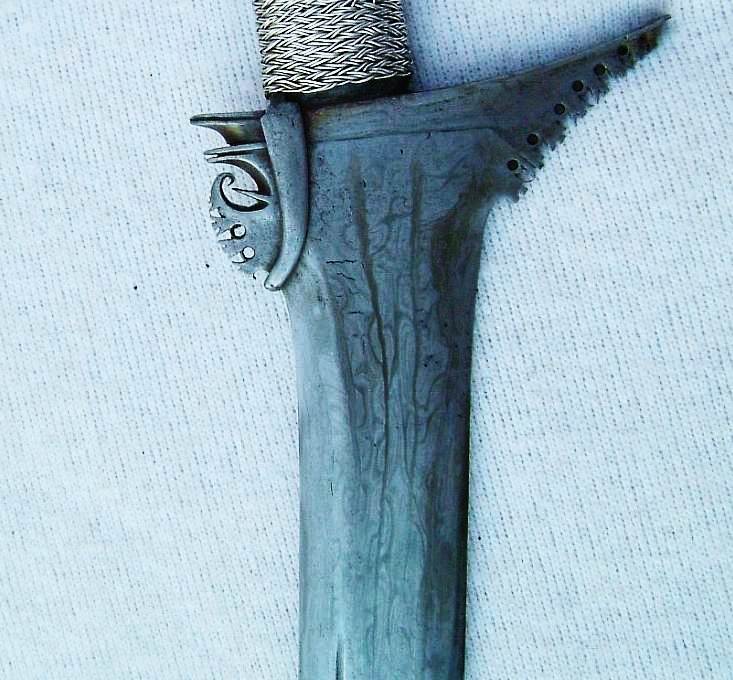

Speaking of that Alan, do you see the suggestion of keris like features with the placement of the twists ?
I kinda thought so; but it might just be me .

Not quite sure what you mean by that Rick.

Reflected in the separation of the individual elements at the base; plain and twisted; and how they all join together further down suggesting the sculptural elements of a keris blade in a way .
I always kind of read this blade's pattern as reflecting that .

Yeah, I see what you mean.
I doubt that anybody could deny the relationship between between the Moro style keris and Javanese keris when they see something such as can be seen in the construction of this blade.
