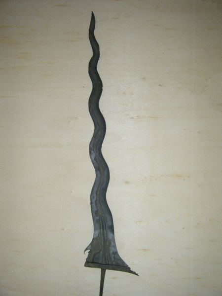

Hello Heinz,
what works fine and certain is lemon acid you can buy in the supermarket. I use a drain pipe closed at one side and hang the blade inside, when you contol it time by time the acid only destroy the corrosion. This blade for example is cleaned by lemon acid.

Hello Detlef,
Very nice result! I see that there are several options. I'll just have to try ...
I have always been very hesitant in using acidic solutions for cleaning purpose on metal surfaces. Being a long-time firearms collector, I believed in the formula
iron/steel + acid = corrosion.
The keris that I intend to clean is -- except for several black rust spots -- a very nice dapur Parungsari in a grey/white condition with smooth edges and beautifully executed luk rengkol. All I want is to preserve it in this shape.
