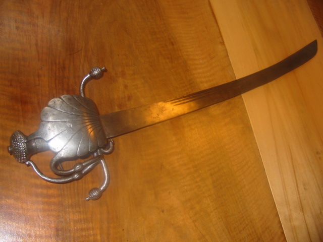

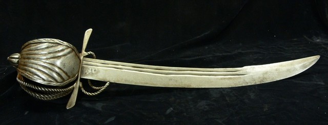

Here are two well known examples of the 'Sinclair Sabre' (dusagge/tessack)

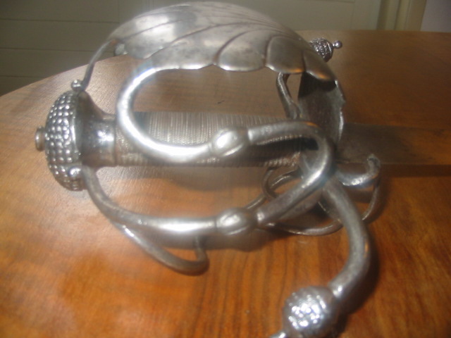

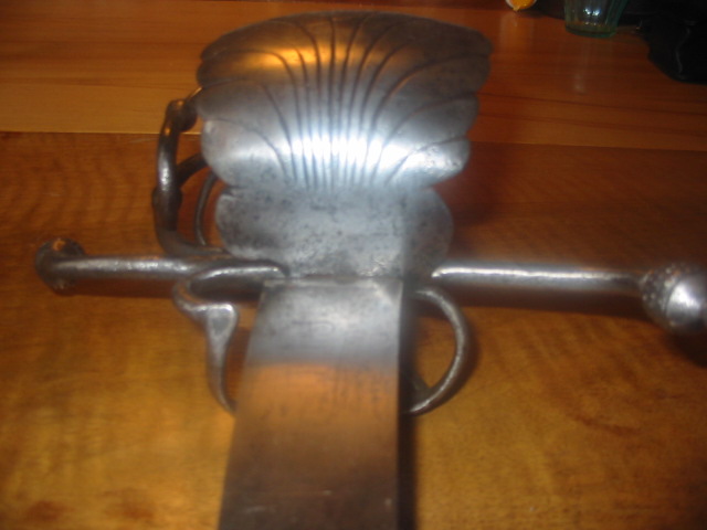

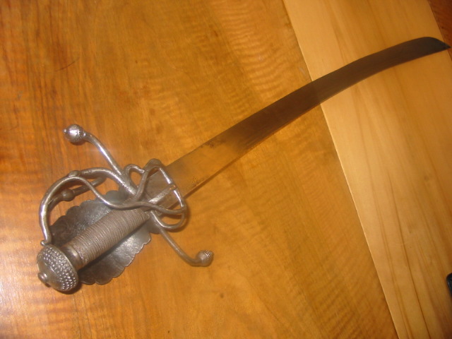

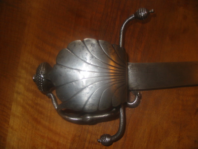

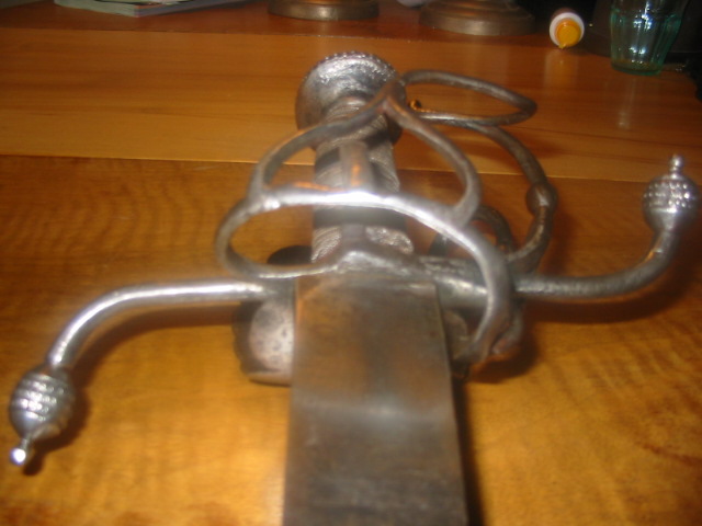

Old 11th February 2010, 07:30 PM   #8
cornelistromp
cornelistromp's Avatar
Join Date: Mar 2009
Posts: 1,071
hello,
here is one out of my collection 1570-1580, I will post some better pics later.
there is a lot of literature:
Seitz blankwaffen, puype Visser collection part 3, puype van mauritz naar munster.
regards
Old 12th February 2010, 04:00 AM   #9
A Senefelder
Join Date: Jul 2009
Posts: 214
You've got a thumb ring on yours, i'm jealous, mine don't have them ( I own the two posted above ) and I love thumb rings. After my first encounter with them on a Wallon style cavalry broadsword ( c. 1650 ) I owned a number of years back I was sold on the feel in the hand of them. There is a security on the backside or drawthrough protion of a cut that comes with them that seems to make for a smoother cut in my personal expirience ( there also seems to be less wobble at the wrist after the blade comes free from the target when cutting with one ).
A Senefelder is offline   Reply With Quote
Old 12th February 2010, 05:02 PM   #10
cornelistromp
Join Date: Mar 2009
Posts: 1,071
Hi, yes you are absolutely right, it gives a lot more stability to the swordhand. specially on hilts where the forefinger can not go over the guard to the ricasso of the blade to give additional stability. ( swords/rapiers with a plate-filled ringguard and all kind basket hilt types)
regards from Holland

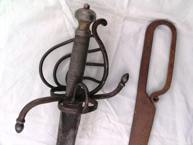

The term is obscure indeed. Jim, I have to argue with your definition as "heavy". I don't think they were heavier - considering the combat use - than their period couterparts. Mind that the simple form of the peasant dussack is just a short steel blade without additional fittings, though its knuckle bow and sometimes broader-than-usual blade give it a little more weight comparing to a "regular" bare blade.
I have two examples, will post photos later on.

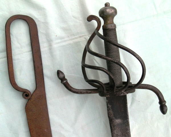

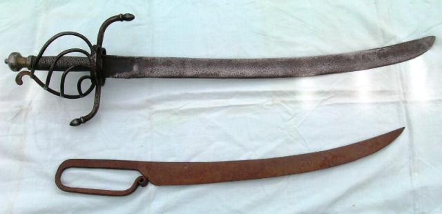

Old 23rd February 2010, 11:49 PM   #12
broadaxe
Join Date: Nov 2008
Posts: 334

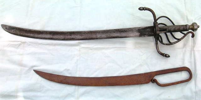

Here are the photos:
Old 24th February 2010, 12:06 AM   #13
Posts: 10,870
Some written info can be found in:
Sach, Chladne Zbrane, p.30 (Czech text).
Muller/Kolling/Platow, Europaische Hieb-Und StichWaffen, pp.36, 76, 428 (German text).
Wagner, Cut & Thrust Weapons, pp. 34-6 (vaguely, English text).
Broadaxe, Im sorry I missed your post here! Extremely well put, and thank you for the references. I agree with your excellent presentation, and it does appear the term 'heavy' would not apply to these short sabres. Your illustration of the two forms together is brilliant!!! Thank you so much.
All the very best,
Old 24th February 2010, 03:37 AM   #14
A Senefelder
Join Date: Jul 2009
Posts: 214
Broadaxe, wow, just wow. What excellent examples. The second lower piece is the virtual stereotypical dussack pictured in period manuals of fence. This is what WMA usually visualizes when the term dussack is mentioned.
Old 24th February 2010, 08:27 AM   #15
broadaxe
Join Date: Nov 2008
Posts: 334
Thank you guys. I was going to post the stats - the most important info (at least, for myself) and almost forgot:
The longer, "Sinclair" saber is 75 cm long, 1.150kg and feeling lighter, due to excellent balance of 6cm down the blade.
The shorter, "pure form" dussack is 60cm long, ~0.720kg, pob is 10cm. Supposedly the grip was wrapped by cloth or leather, maybe some more material on the back of the tang to make it more substantial.
There was a long debate in another forum, regarding the nature of the dussack. Some people tend to believe there were no "live" dussacks, just the wooden/leather sport or pratice weapon, as portrayed so vividly in Joachim Meyer's fencing manual. I think the reason is that the dussack was so simple and cheap, it was neglected by the years and underrated by western collectors of the 18th-19th centuries, so you cannot see them in museums. But, they do exist and there are several specimens in collections over central and eastern Europe. I saw one (identical construction, straight blade) in Bratislava, Slovakia.
