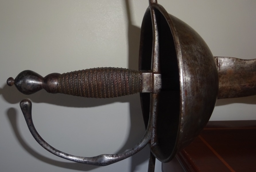

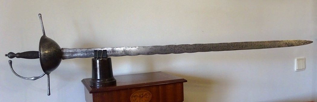

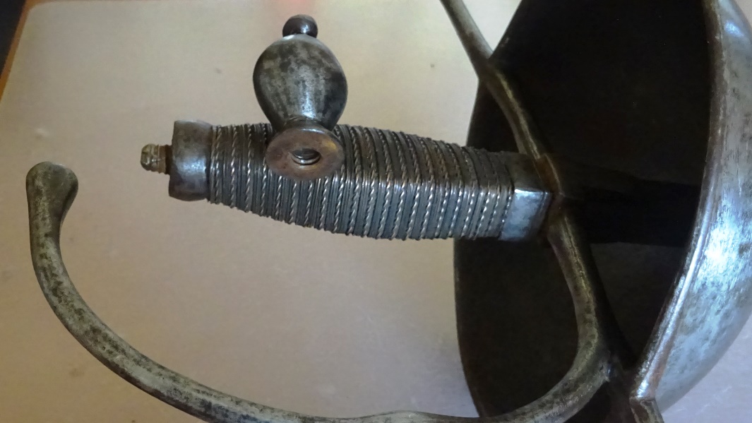

Default A cup hilt sword ... atypical, for your comments.

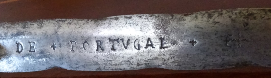

A great asset (for me) is the inscription VIVA EL REY DE PORTVGAL in both blade sides, written in the old manner.
The atypical detail, which i dare repute as rather rare, is the profile of the blade; waving in its first half and straight in the other half. I also dare say, by the looks of it that, this was not a later modification but was forged this way right from the beginning; first owner's whim.
I would say this is a sword from first half 17th century.
Blade length 91 cms.
Total length 109 cms.
Blafe width 40 m/m.
Cup bowl width 14 cms.
Quillons width 28 cms.
Weight 934 grams.

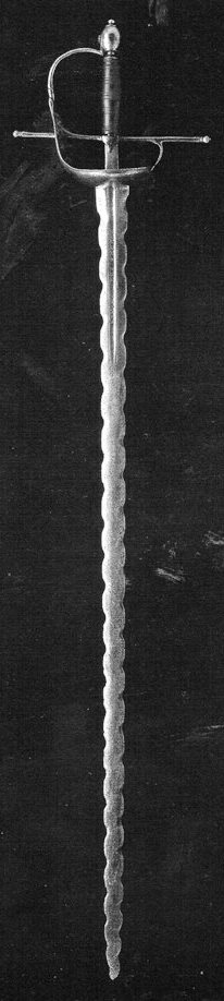

I have seen swords, from two-handers to slim rapiers, with flamboyant blades all the way but never a sword that was half flamboyant and half straight. I would say very rare, and Portuguese at that! Well done, Fernando.

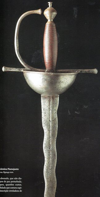

This is an outstanding sword, and I agree with the 17th c. period suggested,
more toward the middle.
The undulating edge on the blade was known in the times up to the Renaissance as 'flamberge' and without going into all the etymological detail referred loosely to 'flaming' sword, and in most cases had far more to do with ecclesiastical allegory to the 'Sword of Paradise' in Biblical dogma. This sword was guardian to the entrance gates to paradise.
As noted, these blades were well known on the two handers, but seen on other swords as well.
As far as I have understood, there is far more aesthetic and imbued value in these undulating edges than practical, but along with the religious symbolism and invocations often seen on blades of the time, this feature seems well placed but indeed atypical for these kinds of 'arming' swords.
While I believe there are some examples with undulation the full length of the blade, it seems it is more usual to be in the upper half of the blade where more strength and metal stock is present. Blades of course tend to thin notably in the distal half so such features would be more difficult.

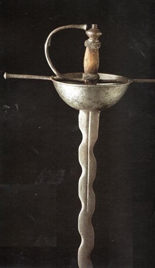

A truly rare blade form (half waved from the forte, straight towards tip) in a European context. Fairly common, however, among south Philippine kalis (kris) short swords, that configuration called kalis taluseko.
Jim: Re your comment on flamberge blades, I think that there is a functional component as well. When used for the thrust, the tissue damage from the puncture wound is more extensive due to the lateral waves. Greater shock and blood loss. That's why a number of central European boar swords (not spears) also have wavy blades, broad enough so the edges can be sharpened. And this is also held to be the rationale behind the wavy blades on many keris daggers of SE Asia as well.

That is a nice sword indeed especially the blade I to would place it as 17th C ! There is an almost identical one in the Museu Militar in Lisbon that one is described as 18th C, perhaps these are late 17th C early 18th C ? It would be interesting to find out when the first one's emerged to me this is typical Portuguese . Although I collect 16th and 17th C I would not mind having this one in my collection , perhaps Fernando will give me a call around Christmas

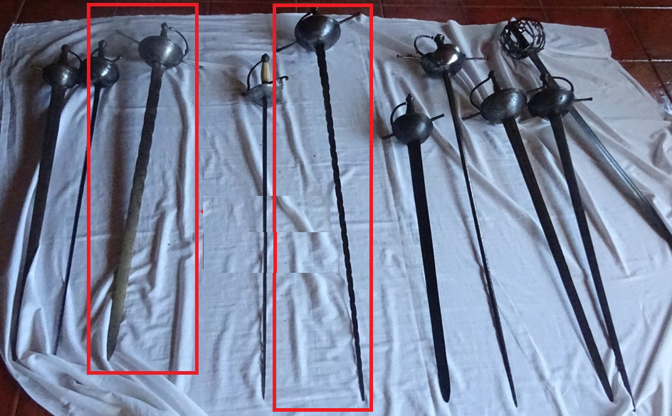

Default Flaming versus undulated ... the difference

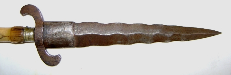

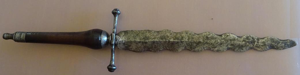

Whether one gave place to the other, let evidence show up and enlighten us ... or enlighten me, for one.
Not hard to trace the multiple info on the flaming sword; Sumerian, owned by Asaruludu; the bible, with Archangel Uriel, guarding the doors of Eden to prevent expelled Adam and Even to return (Gênesis 3:24); in Welsh mythology, the Dyrnwyn owned by Rhydderch, capable of burning the man who called him for unworthy purposes; in Nordic mythology, the sword held by Surtr, a jötunn from Muspelheim, had a flaming blade with imense destructive power. But all those swords had blades that produced "actual" flames; burning fire was their business, not the design of the blade.
Now, whether all these gave transition to 'modern' blades with the waving option, losing the property of fire in favor of their stabbing efficacy, let it be a self service conclusion.
Not forgetting that, by the time of freemasonry, the flames had already ceased playing their mythic role and the sword was only undulated (say waved). But this occurrence only appeared in a later ritual fashion in France, influenced by the exiled Scots nobles. Before that, freemasons had their own mason tools for symbols, the sword not included. Even the Tyler chronicles are not consistent with his sword being undulated or straight.
Obviously the argument that the waving section being placed other than in the blade point is, if i may, a fait divers. As i said in my first post about the sword in discussiin being an 'atypical' example, quoted as a 'owners whim' (read caprice).
Attached a couple examples from my little collection in such context.

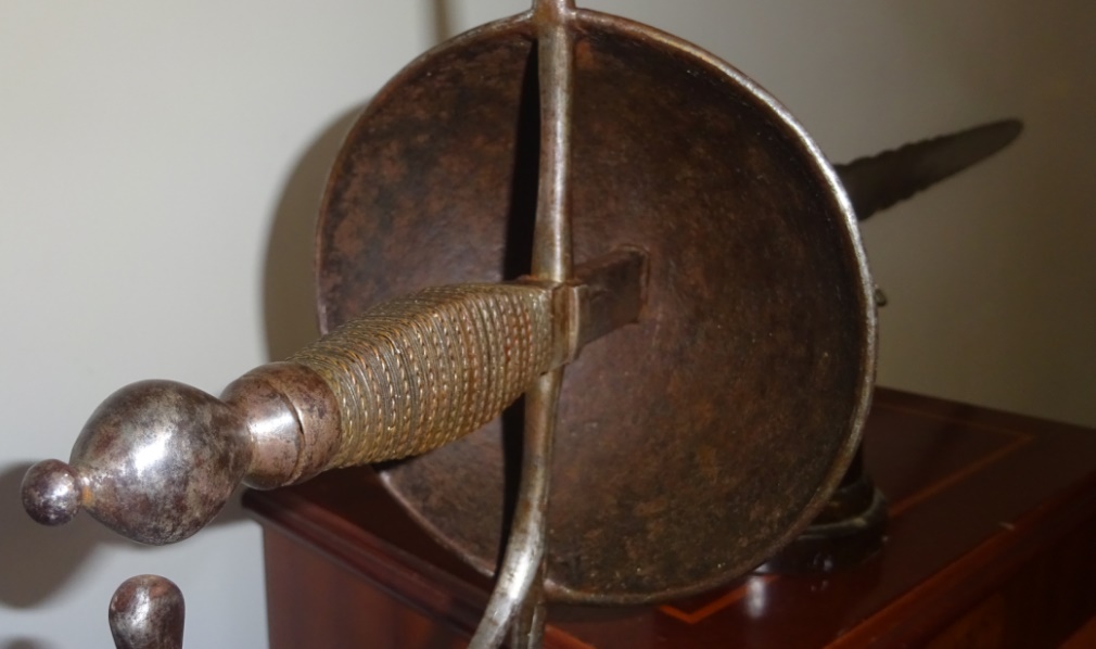

Default And by the way ...
... also this example (the one initially posted) has the same particularity of a threaded pommel. Pity i couldn't dismount the grip, to look for possible signs on the tang; too stuck to risk damaging.
