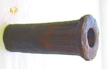

Well, after Fernando and Matchlock have been wetting my appetite for one of these, I finally found one I was considering on bidding on. Problem was, it was a priviate auction and I've heard others to stay clear of these, especially from over-seas. I passed, and I guess everyone else did as well. This seller had a ton of signal cannons for sale and not one was bought. Hmmm...
Anyway, seemed like a legit piece, if mismarked. This isn't a signaller, is it?

You are most probably right in that it doesn't look like a signaller but, instead, a 'stockable' cannon, as shown by its shape. It looks like the real thing, and a nice one by the way but, no doubt Michael's opinnion is vital, as he has a clinic eye for these things .
BTW, how did the guy know this has an Austrian origin .
Fernando

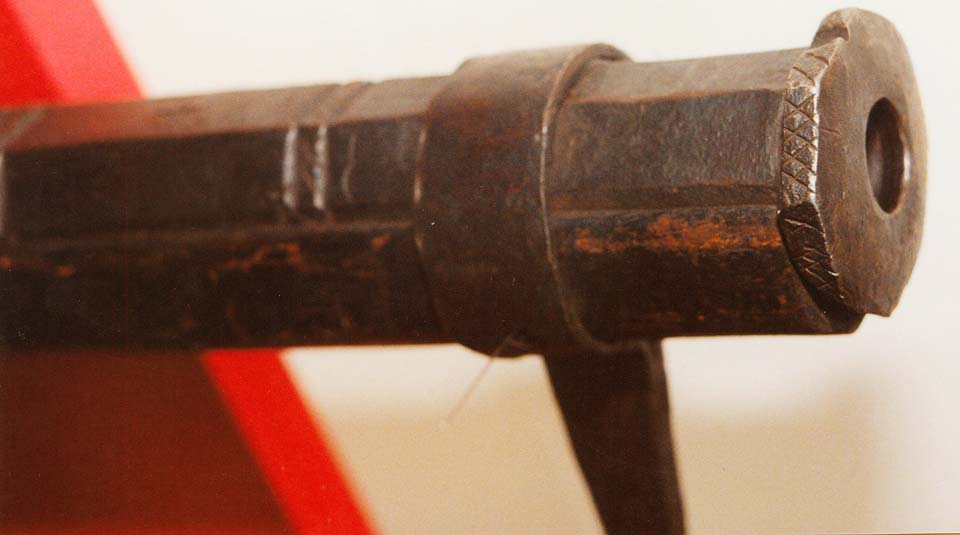

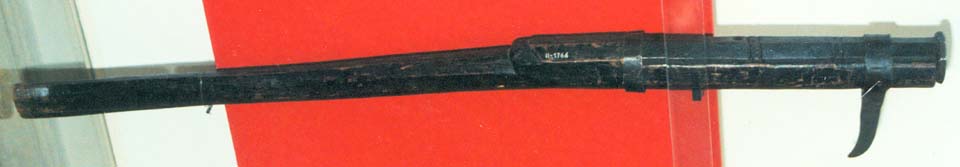

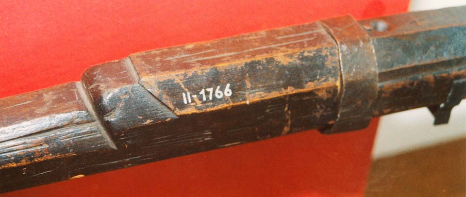

Hi Mark and Fernando,
First of all I guess that the seller thought that barrel was Austrian because unbelievably large numbers of these are still around in both Bavaria and Austria, where they are often employed as door stoppers in old houses. Forget about his tentative dating 'ca. 1750' though.
I attach the images for documentary purposes as they will not be around on Ebay for too long.
Secondly, Fernando is perfectly on the right track and made the final note by pointing out that the barrel was staged and the heavily swamped flat muzzle section would make an ideal land mark for the fore end of a stock.
Thirdly, before probably being around as a signaler and door stopper for two or three hundred years that barrel was definitely stocked and used for 'serious' purposes at the earlier stages of its working life which may have started as early as the 1440's!!! The small touch hole near the rear end and the large, flat muzzle head perfectly fit that Hussite Period.

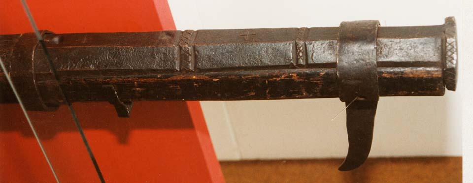

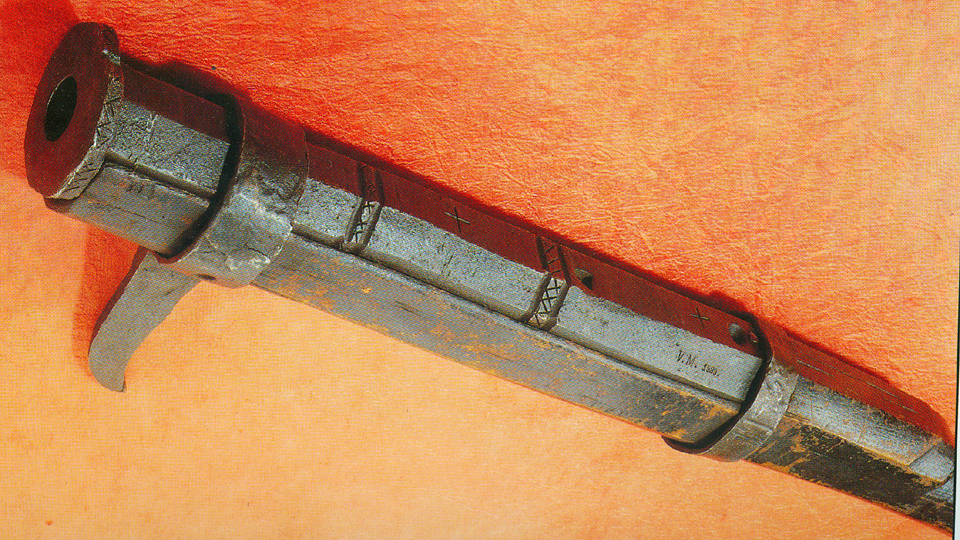

Something very rarely found on early wrought iron barrels are the hammered longitudinal decorative grooves between the edges.
I include a scan of a similar barrel retaining its original stock and looped hook, now preserved at the Czech Military Museum in the Hradčany Castle Prague.
Michael

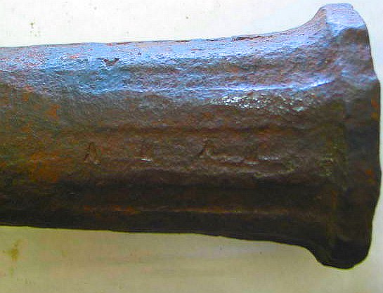

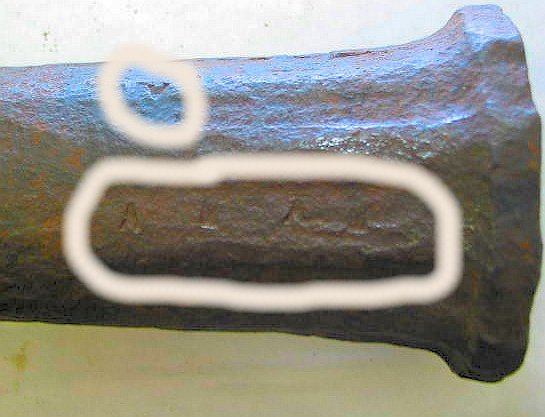

All my judging was done on the basis of some very poor 10 kB images.
I just noted what seems to be a series of punched quite modern A's on the side towards the muzzle. We must not forget that all the early forms were repeated in the Historismus period of the second half of the 19th century - and what if this is not wrought iron but 19th c. cast iron?
Always be careful, especially with poor images.
Michael

Thanks for the explanation, Michael. One final question on this piece. Do the series of punched letters automatically point to a more modern manufacture on these pieces, meaning earlier pieces will not be so marked? Or is it that the "A's" appear to be a more modern print of this type? Thanks,
Mark
Old 30th July 2009, 04:35 PM   #11
Matchlock
Matchlock's Avatar
Join Date: Sep 2008
Posts: 4,310
You're welcome, Mark,
In my experience, this print pype of the letter A come only in use in the late 18th century. Using a series of it as a kind of deoration seems very awkward to me.

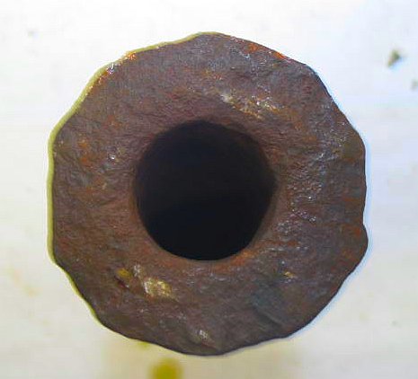

Do you have more information about this gun? I interesting in calibre and barrel length ont another photos.

Old 31st July 2009, 06:36 PM   #13
Matchlock
Matchlock's Avatar
Join Date: Sep 2008
Posts: 4,310
O.k., here we go:
Photos I took of the Prague haquebut and the measurements:
Overall length 135 cm, barrel length 41 cm, cal. 36 mm.
Michael

Thanks. It is a very beutifull barrel Maby you had mean 26 mm?
Spiridonov is offline   Reply With Quote
Old 1st August 2009, 02:19 PM   #15
Matchlock
Matchlock's Avatar
Join Date: Sep 2008
Posts: 4,310
Hi Spiridonov,
In his 1998 book Illustriertes Lexikon der Handfeuerwaffen, Vladímir Dolínek, the curator in charge of the military museum Prague, states on p. 22 that the caliber of this gun is 36 mm.
Looking at the general proportions, though, I must say you may be right as it seems rather like 26 mm.

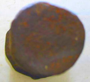

What is the nail behinde the touch hole of this barrel?
Old 4th August 2009, 05:02 PM   #17
Matchlock
Matchlock's Avatar
Join Date: Sep 2008
Posts: 4,310
Honestly, I have no idea.
As it is nailed in too deeply no swiveling pan cover could have been possibly fixed there though.
