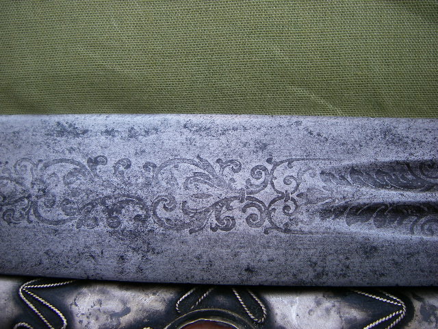

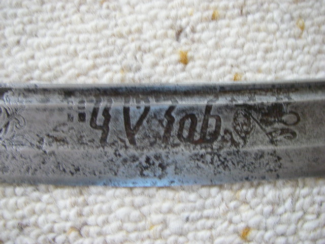

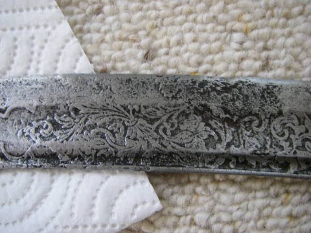

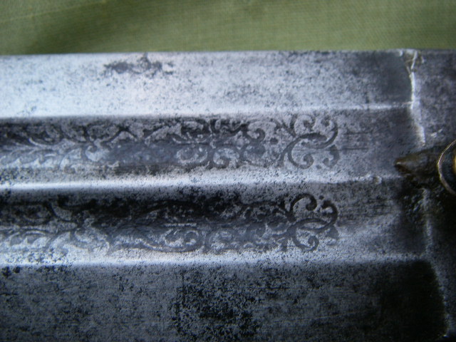

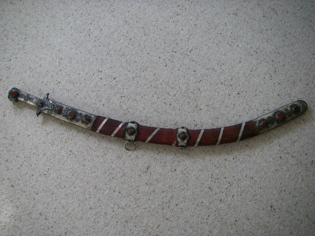

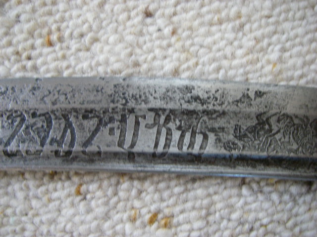

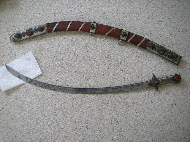

Brian, this one has old European (English?) blade with added Amharic? script. I think it used to be on Ethiopian saber (Gurade). Is there a sitting lion (Lion of Judea) on forte?

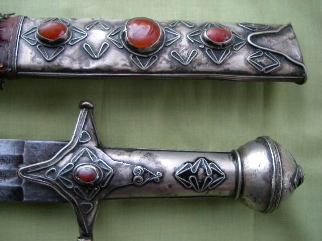

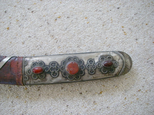

The scabbard and handle are recent imitation of a 'Buharan' style with wire-filigree and set aghate/agate stones.

I think the blade is likely German, I believe the single G on the forte is part of the "G.G." .... a Solingen mark, often with a 'thermometer' (?) mark below. A good number of Gurades have this marking.

I still have a real Nimcha ( " a small one" according to Elgood). It has a newly-made scabbard that is remarkably similar to this one. I got it from a guy in Lebanon ( and stupidly refused his offer to buy another one just like that), and he was very open about the new-ness of the scabbard. I think this is a cottage industry there, perhaps the same workshop. I do not see much Bukharan influence, local contemporary Levantine "style".
Only this time around the re-working was much more extensive. The blade is a trade one from Germany to Abyssinia. The rest is pure " Paris of the Levant" :-)

I would guess that this was a Gurade that was re-hilted in Sanaa, Yemen. This spiral silver strip and stone look Yemeni, so does the shape of the hilt. I would bet this was re-hilted within the last 20 years.

As extremely well noted here, this is likely relatively recent remount in Southern Arabian style as noted by Michael (I'm glad to see you in on these Arabian sabres Michael ) and in Yemeni style.
As David has well noted, this blade does look like one of the Solingen produced blades for Abyssinia in the early 20th century, often mounted on shotel and gurade. It seems many of these swords with this style mount and decoration occur in Yemen in the early 20th century and with British presence in the Gulf of Aden there were many of these weapons acquired as souveniers.
I believe that the scabbard style, as well as the silver banding, is a Hadhramati style favored from the latter 18th century on the sa'if's that were often produced in Hyderabad. It does seem that it has been suggested over the years that the wrapped silver bands around scabbard were a Bukharen feature, but I am more familiar with it on these Hadhramaut and Yemen swords.
Since Persian influence was key in Bukhara, and was of key preference in Arabia in weapons, that seems quite in line though.

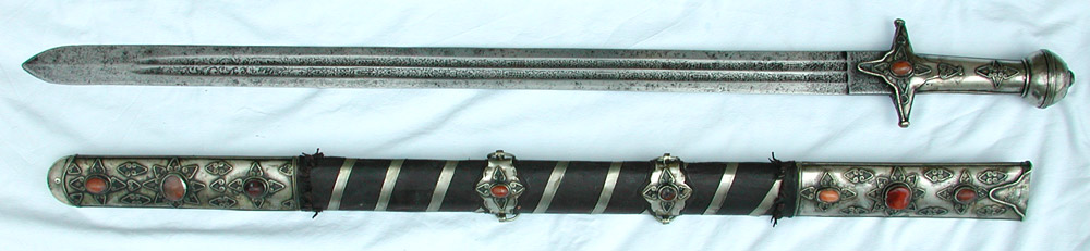

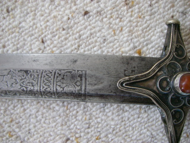

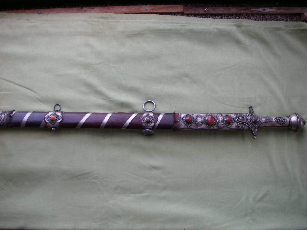

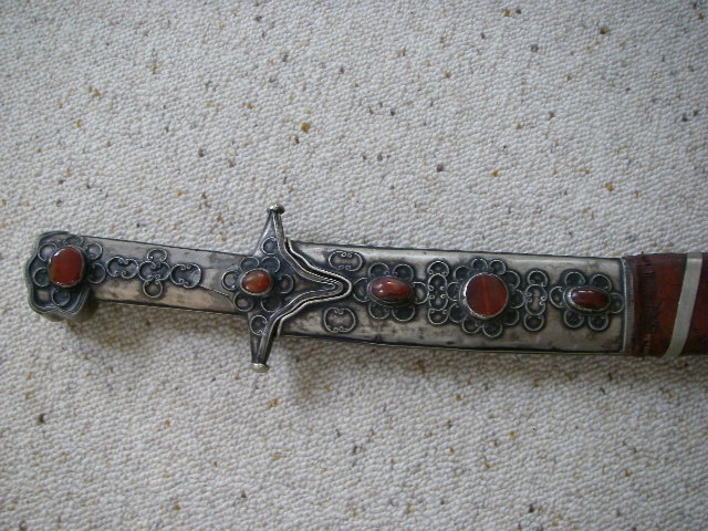

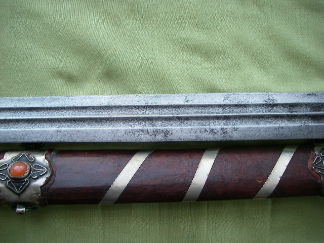

Thanks heaps for the info, I am always keen to expand my knowledge. Here are some pics of another sword, with similarities to the first, but with a straight blade. Can I assume that this also has an old blade but was refurbished in Yemen? Possibly in the same shop?
The two I have are certainly impressive items and if someone received a hard blow from them, they would definitely get at least a nasty bruise!

Very much like this one
http://www.vikingsword.com/vb/showthread.php?t=3002

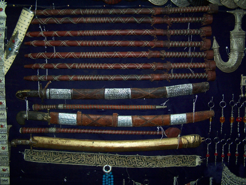

I've seen photos of similar swords in Jambiya shops in Sana'a.
