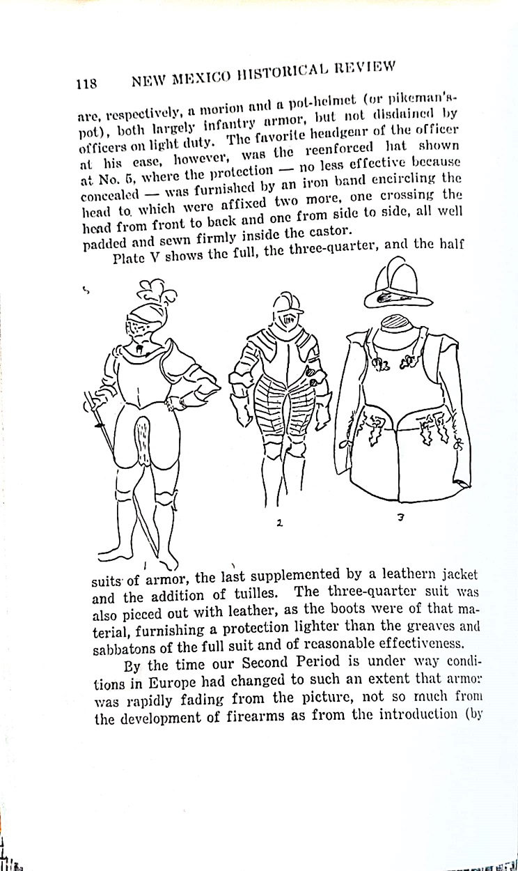

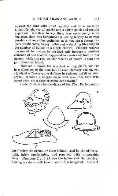

The plates attached are:
4: (1) ARMET, closed helmet, as used by officers
(2) cavalry SALADE with beavor
* the beavor is covering of lower part of face.
(3) MORION.....here the word is used to describe what is clearly
the pear shaped cabasset
(4)pikemans helmet (pot)
(5) the broad brimmed hat reinforced.
Plate 5, has an armor with a combed morion, which seems presumably to be of the Onate period.

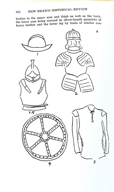

Plate 7 (p123) describes the 2nd period, which is well into the 17th century until 1680s which included the reconquest against Indian revolts. This was the period of the leather armor I was researching (Pueblo Revolt, Santa Fe, 1680s-90s)
Here the combed morion is seen, and is noted "...of somewhat more effective design than previously shown, used by both mounted and dismounted troops". It is noted that these as with other elements and arms, had continued use from earlier times.
