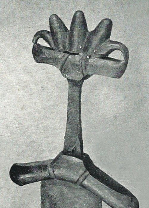

The closest analogue of the hilt depicted in the Spanish Beatus manuscript you mention is one that Oakeshott did publish at least once (Records of the Medieval Sword). Often described as a "Viking" sword, it was reportedly excavated in Italy, near Florence.
Name:  Additional 11695 (Spain, 1091-1109).jpg
Size:  160.3 KBName:  X.6 - Philadelphia 1977-167-529.jpg

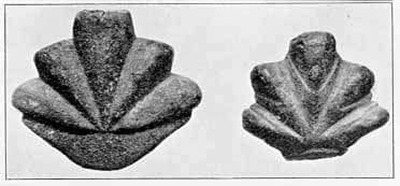

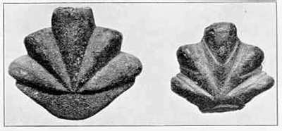

The next closest, from a grave in Sweden, is more clearly derivative from Scandinavian styles of the late Viking age, which include many lobed pommel forms. Lobed forms continue to be depicted well after Christianization, including in the famous stave church of Urnes.
Name:  SHM 22293.2- Bengtsarvet, gr. 2.jpg
Size:  136.2 KBName:  Urnes Church (1130s).jpg

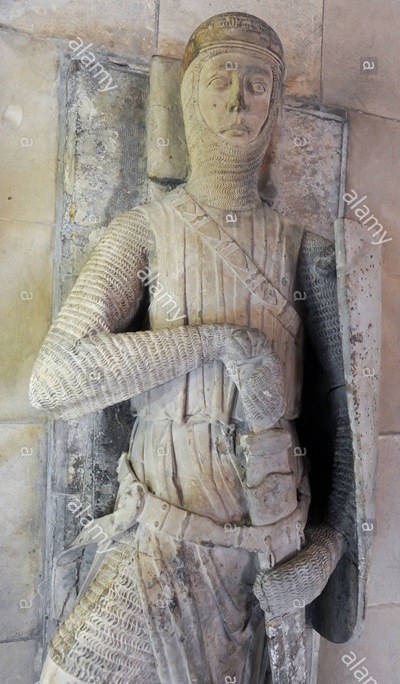

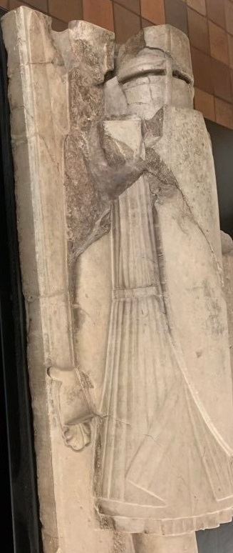

Scandinavian influence seems to be reflected by the frequency with which lobed pommels are found throughout the British Isles, with identical forms often turning up at great distances in Norway or Iceland (the Cawood and Koysogarden swords discussed by Oakeshott being the best-known examples). Many stray pommels are now recorded with the Portable Antiquities Scheme. These pommels can plausibly be dated well into the the 13th century based on comparison with knightly effigies (attached from Temple Church, Furness Abbey, Jerpoint).
Size:  35.3 KBName:  Milos Bucko - Arkendale Harrogate, Yorkshire.jpg
Name:  possibly Gilbert Marshal (c. 1260-80).jpg
Size:  131.7 KBName:  Furness Abbey, Cumbria (late 13th).jpg
Size:  86.7 KBName:  Jerpoint.jpg
