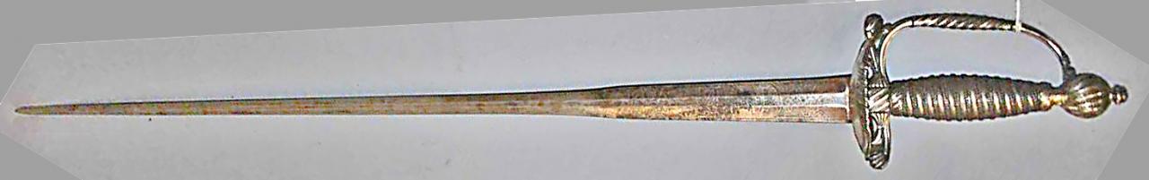

Before the classic style hollow blade colichemarde became popular in the mid. 1700s, there had long existed what was known as a "squeezed" blade that was not of a trefoil cross-section. Plenty of examples can be found today and I attach one below. This is a c.1760s rehilt and just one of a few variations on this theme.

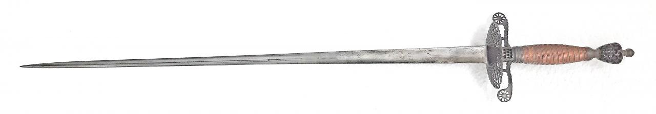

The first thing I found of interest during my initial research into the Shotley Bridge story was that hollow colichemarde blades differed from the bulk of smallsword blades in that – without exception – they all featured a groove in the broad face. This was of constant width as opposed to a constantly reducing radius. It is a fuller that also I found on many non-colichemarde blades. This example below is further typical in that although it does not have a vulgar shoulder, which is not visually pleasing, it does enjoy an extra broad fort and in my opinion a very attractive and successful happy medium.

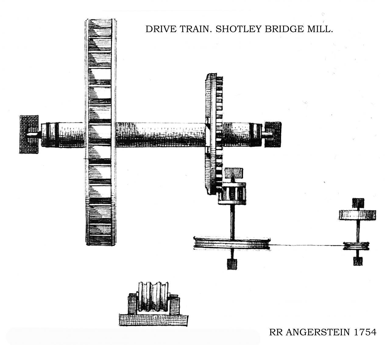

It appears that the exodus to Shotley Bridge was the perfect opportunity, so Abraham and Harmonn Mohll took the machines over, appropriated the site of the flour mill in the village and converted it to power one of their (two) machines alongside a typical blade-mill works. In 1754 a sketch of that machine – then no longer secret – was made by Swedish spy RR Angerstein and its functionality is obvious: small, dry-grind (sic) wheels, instead of laborious hand filing.

N.B. profiling those very hard little wheels would only have been possible once 'tool' steel appeared following the development of the Cementation process in Nuremberg in 1601.

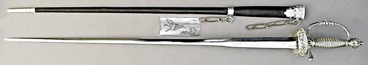

That second machine, by necessity, had to be in the forge and no Swedish industrial spy got into the Oley forge, no-one ever got in there. Angerstein did make mention of smallsword blade decoration in Shotley Bridge as by then (1754) this was the Oley's principle swordblade output. There is an example below, etched in 1767 by famous Tyneside artist Thomas Bewick – apprenticed to the Oleys during his early years with the Beilby glass company – using a stylised version of the Oley family's bushy tailed fox. That impressive style of fox has materialised on more than one occasion.

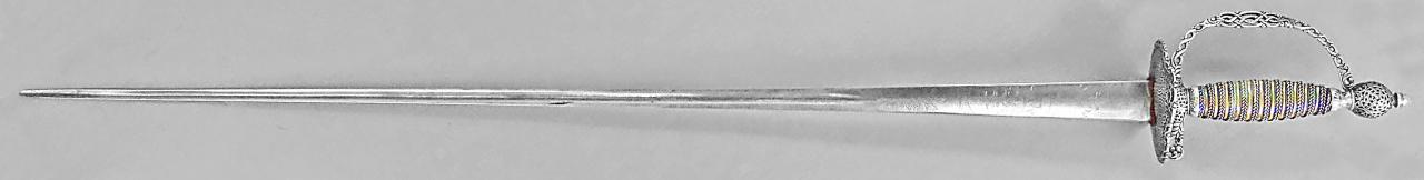

By the last quarter of the 18th century, when Shotley Bridge sword manufacture had virtually ceased, Moles and Oleys took their skills and those machines down to Birmingham. I found a George III smallsword that featured the infamous groove and had Gill's warranties stamped on the ricasso. It was a special commission from a Naval officer so was appropriately a short blade (27") but with a sizeable hilt.
