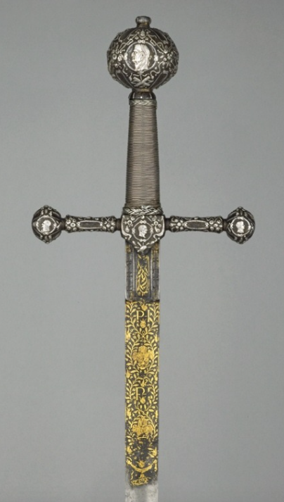

Good Lord, the mark is a unicorn! I don't know why I couldn't make that out. I ended up screenshotting it and rotating to all orientations. I am always humbled by Mr. McDougall’s research and have learned from him yet again by reverse engineering the process somewhat. Thanks Jim!
The Wallace Collection Vol II mentions that the globular pommel was popular in England but not proof of English manufacture. Later the discussion of example A597 says the style was popular "....1580-1680 when the fashion seems to have been brought to the country by foreign craftsman (cf. No. A511)." A511 being the prince of Wales’ sword. The first attached photo is of this sword’s forte and hilt. It shows the ostrich feathers and the PH monogram. I personally believe this hilt, a gift from Charles Emanuel of Savoy, to be in baroque style, while Hampton’s hilt with the elongated figures seems to be in the style of mannerism. The difference in styles, themes, and improbability of being sourced from the same geographic region would on the surface make the hilts seem unrelated other than of course the Clemens Horn blade.
Name:  Screenshot (972).png
