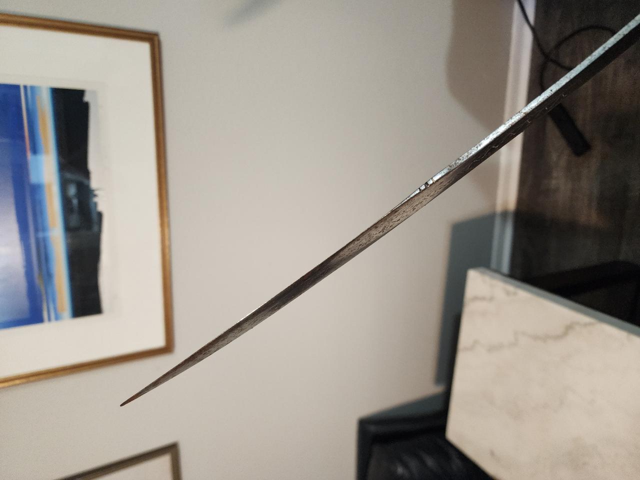

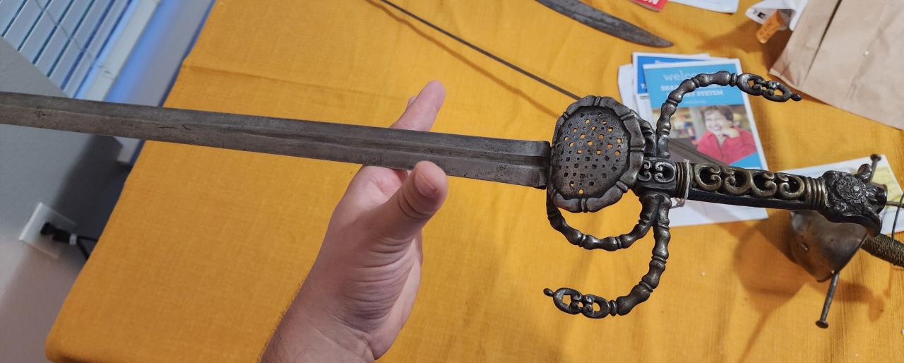

Good morning everyone. After a surprisingly good morning at an estate sale, I've got a few meaty swords to dig into researching. For the price I paid for them, they could all be reproductions and I'd still be very pleased with the morning.
First up I've got what appears to be a early 1600's side sword with a chiseled hilt. I'm pretty dubious about these chiseled hilts as they all strike me as sort of Gothic-revival Victorian types of thing. On top of that the grip is pierced brass. Once again, not unheard of on legitimate period blades but also vaguely Victorian. I'm also a bit weary of the fit between the blade and hilt.
As for the blade, it seems legitimate to me. Cross marks at the ricasso match several Italian marks with a running(standing?) wolf inscribed in the fuller. Blade is roughly 38 inches give or take. I can't find an exact match for the mark just yet.
The last picture is a bit messy as it is sitting on a stack of other swords but you can still get an idea of the detail. The pommel is quite interesting, it almost has a Schiavona outline.
I'm very curious to hear y'all's thoughts!
Michael, 10thRoyal

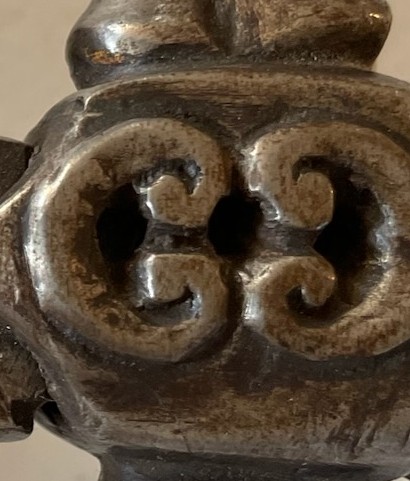

Interested Party 23rd August 2024 06:22 PM
Somewhere in Norman recently I read about a style of 17th century English hilts with joints like bamboo. If memory serves p. 373, the section on chiseled hilts. I will double check later after work if no one else posts.
10thRoyal 23rd August 2024 06:40 PM
Interesting. My mind immediately went to finger bones but I see the bamboo now.
midelburgo 23rd August 2024 07:48 PM
Some Victorian copies weight much more than what they should. Also bad balance. That is a start.
ulfberth 23rd August 2024 09:43 PM
The blade is 17th century , The pommel is composite and does not belong to this type of rapier neither does it fit the grip its a shiavona type of pommel.
For the guard i lean towords 19th c based on these few pics ,more detailed pictures are needed to be sure , the back of the guard is missing it was probably the same guard ring is the front, altough this type of guard existed in the 17th c this one is pretty rougly made the original ones were usualy more refined .

10thRoyal 24th August 2024 01:45 AM
1 Attachment(s)
kind regards
Ulfberth
I think that's a good catch Ulfberth, it does look like the other half of the guard may have snapped off and someone may have sanded down the fracture surface. After looking at it more the pommel does look straight off a schiavona. Luckily the blade itself looks fantastic and I'm super happy with it. I'll have more details coming when I have the swords in hand.

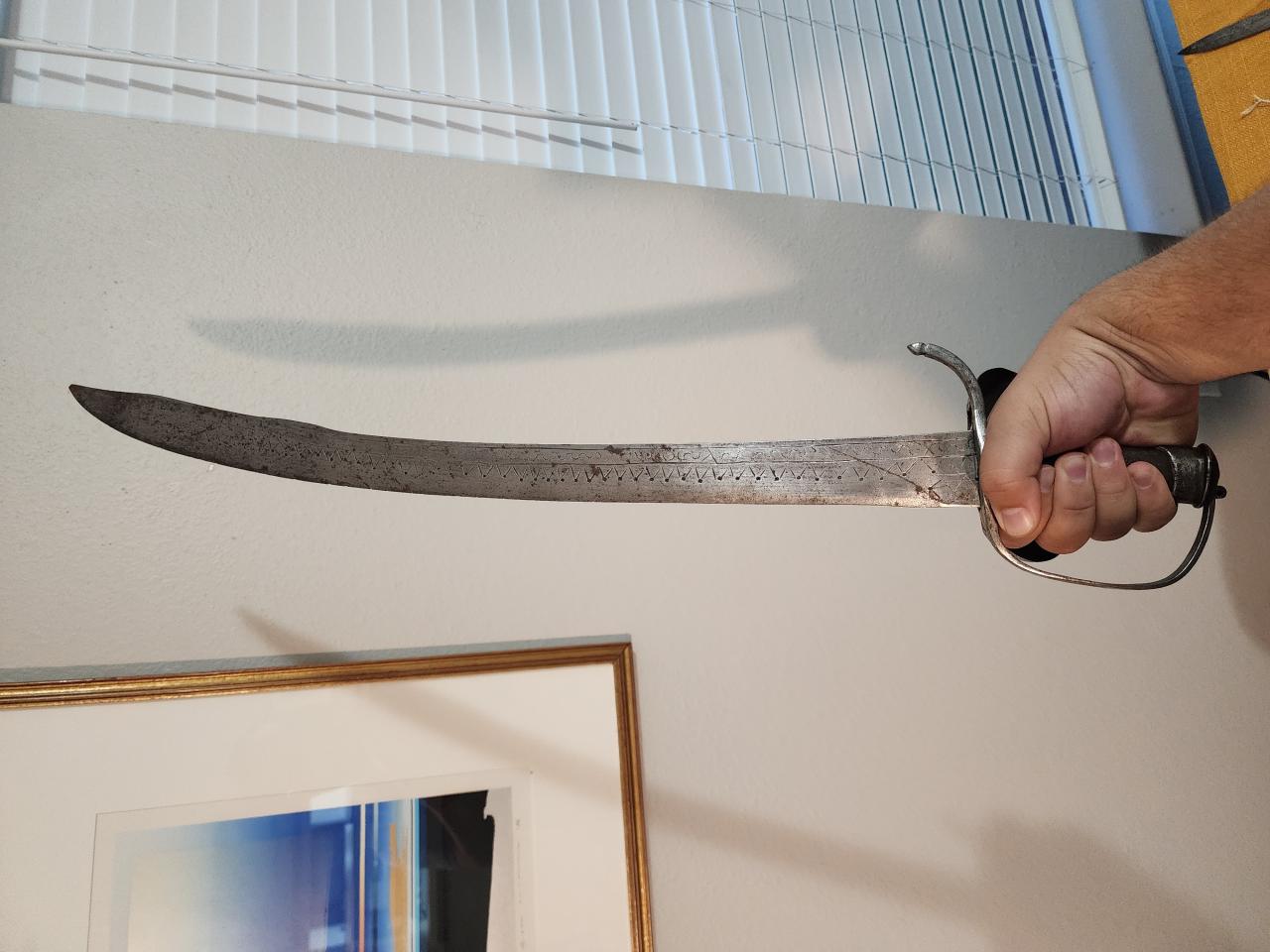

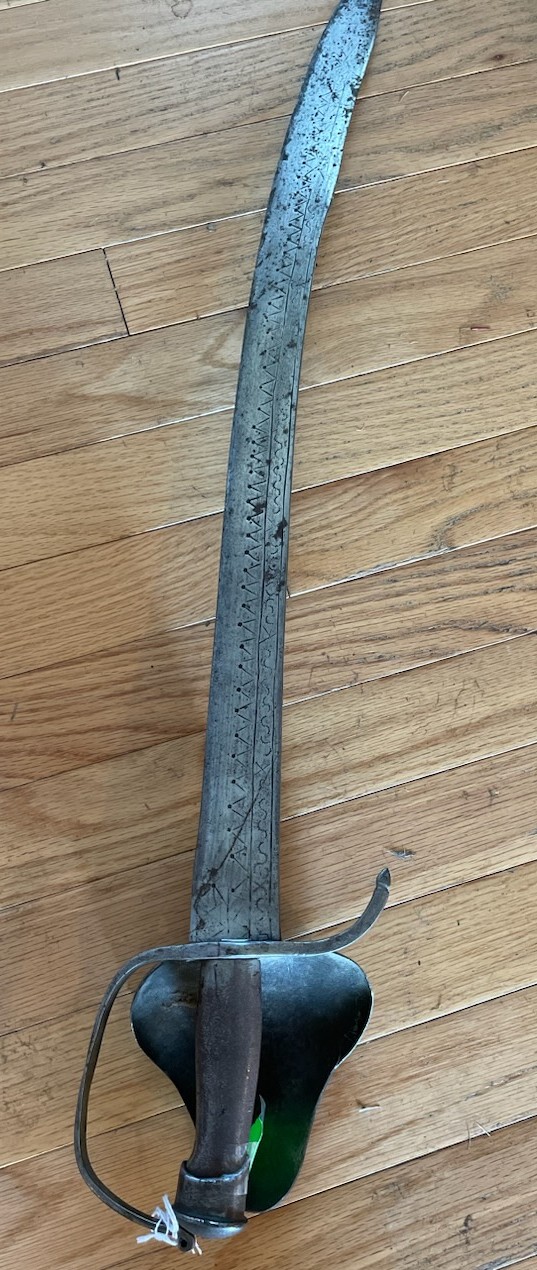

It's great to hear that there were some legitimate diamonds in the rough that I found. The rapier was under a literal pile of "made in Toledo, Spain" souvenir swords. I'll have everything in hand by Wednesday and can send more detailed pictures then. I forgot that I had two additional images of both the cup hilt rapier and Italian saber.
Attachment 239699
Attachment 239700
I was honestly worried about the blade decoration on the saber at first. It looked too much like arsenal tulwar decoration. But I later found multiple examples with similarly janky designs carved into them. The pommel cap is interesting. I associate that style much more with 18th and 19th century sabers.
On another note, do y'all have any idea if there is any significance behind these shapes on the rapier grip and quillons? Just the fact that it is repeated multiple times in different spots made me wonder if it was associated with anything. Or it's just a metal design that looks like a pretzel with zero special meaning.
Attachment 239701
Attachment 239702
Attachment 239703
Thank you again to Ulfberth and Mr. McDougall, y'all have a level of knowledge and desire to share that knowledge that new comers to the field can aspire to, myself included.
ulfberth 24th August 2024 06:28 PM
5 Attachment(s)
the naval sabre has indeed a later grip and pommel cap, the decoration on the blade reminds me on Italian blade decoration of the 16th c however on your sabre it looks similar yet different, not sure what to think if it.
The repeating shapes on the rapier is a good sign and i have seen it before, its more a baroque type design.
