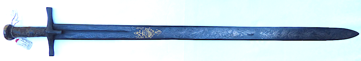

This is the second of my purchases from the Australian Arms Auction this past weekend. The kaskara was said to have been brought back by an Australian army contingent around 1900. It has a dark, patinated blade with interesting gold and silver inlays. I have not seen similar on a kaskara previously. Has anyone else seen similar decorations on a kaskara?
I'm wondering if these may actually be decorative elements added by a prior Australian owner--snakes, flowers, leaves, etc. are common motifs in Australian Aboriginal culture.
I bought this one because it struck me as being very unusual. I would like to hear what our kaskara experts think. This is the only picture from the auction and I don't yet have the sword.

Thanks Ramba. Yes, you are correct that it was a NSW Contingent. The Australian Army did not exist—we were still a British colony at that time. I guess we can say the sword is likely 19th C, probably from the 1880s or earlier.

The snakes you see here are remarkably similar to those seen on a good number of kaskara of this period, and hardly likely to have been added in Australia. The peacocks or whatever birds those are also resemble other Sufi decorative elements, which prevailed on Persian swords. There was of course profound Persian and Sufi influence in the Sudan. as seen with much of their weaponry.
This is one of the most profusely decorated examples I have seen for some time and truly appears to be an outstanding piece which may well have been a bring back as suggested. I had not ever heard of the Australian involvement (thank you Ramba) ,in this unfortunate campaign in 1885, which failed to get support to Gordon at Khartoum. It has been held that there were political issues at hand , which strategically delayed the support he needed, so the abandonment of the campaign and disbandment of this unit.
I think this is outstanding in military tradition exemplifying the ever ready support always at hand from Australia for its allies..

VERY nice kaskara, Ian. I agree with Jim's assessment. I might add that it has similar elements to the famed Snake kaskara now in the MET. See attached link. The gold cartouche is striking and may have been inspired by the MET example. I'm eager to see better pics once you receive it.

Thank you for your excellent information about this sword and the observations on the conflict in the Sudan during the 1880s. The Met example is a superb piece of swordmaking.
Ed, after reading your excellent essays on the kaskara I have been looking for a nice one at a somewhat reasonable price. The few higher end examples that have come on the market in recent times have not received budgetary approval from my lovely (and patient) wife. This one snuck under the wire. :D

Fascinating and there are clear common design elements in these examples. It may well be as it was when it arrived in Australia. It would seem a lot of work and quite difficult to execute after its move to Australia.

The blade looks imported from the pic (deep central fuller and blade not sharpened in top 1/3). I doubt that many proper locally made blades were available at the time. It seems that most local blades then were wrought iron and hardly battle worthy. However, exceptions are always possible. The grip doesn't have the Beja signature tassel so I doubt it was a battlefield pick-up by the NSWC since the Osman Digna's Beja were their adversaries during their brief deployment out of Suakin. Ironically, other Beja were in charge of Suakin at the time and a NSWC officer could have purchased it in the market in 1885.

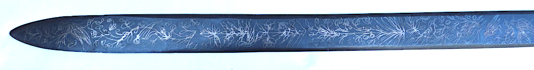

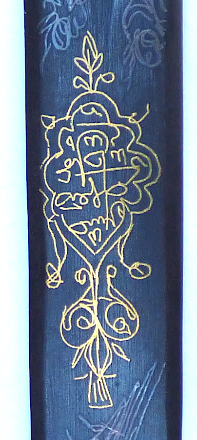

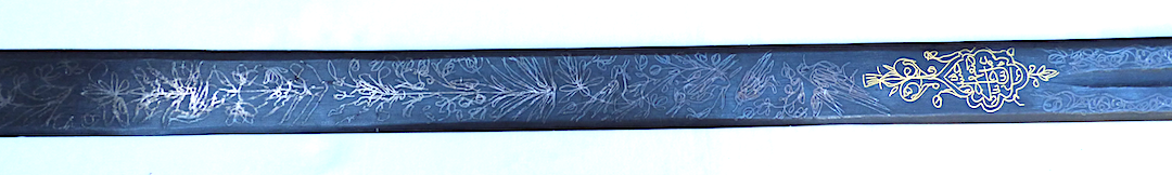

And here are more pictures of the sword. I think this blade is of local manufacture rather than Persian. The silver decorations of vegetation and birds are tarnished and somewhat difficult to photograph against the very dark blade. I can provide more pictures at higher magnification if you wish. The gold inscriptions are not very well done, again suggesting local work rather than Persian. If someone can translate these, I would be very grateful.

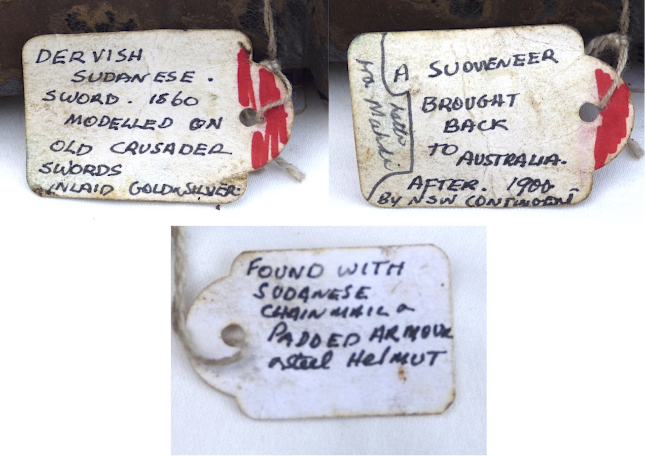

And here are the tags attached to the sword when it came, giving some of the history.

Ian, to me the blade looks like a 19th century German trade blade. There were two general patterns - one with three narrow fullers and one like yours, with a shorter, wider fuller. It is also possible that it was made in Sudan in imitation of the trade blades, but during the 19th century those were exported in huge quantities due to their combination of price and quality. Of course, the hilt and the decoration would have been applied locally.

The new pictures and the tags are informative. The tag that says the sword was found with chain mail, etc. suggests that the sword was owned by a Sudanese knight and a Baqqara tribal calvary emir or unit commander. This group and their armour kit were influenced by western Sudan/Chadic military culture and mostly stationed in Omdurman during the Mahdiya. The tag notes that the sword was brought back "after 1900". This suggests that it could have been collected after the Battle of Omdurman in 1898 rather than during the NSW Contingent service in early 1885. Their service was against the Bega who did not use padded armour, steel helmets, etc.
The attractive silver floral-type designs do not follow the style of Quranic texts common on Mahdiya swords. The gold cartouches are crudely made and translations could hold the keys to its origin. Cartouches are also not common, if applied at all, on Mahdiya era swords.
